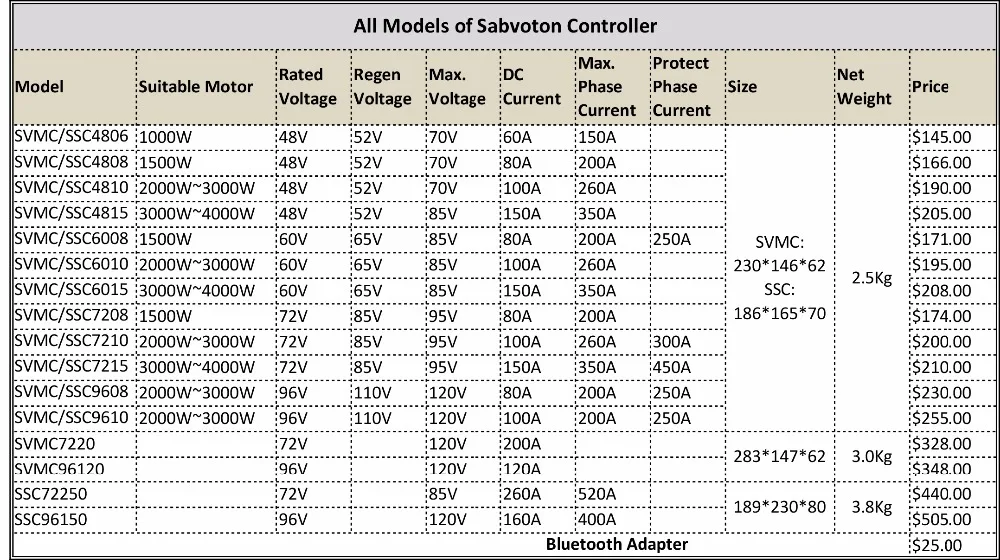

I bought is 72150 v 2 version with tft screen and I can't set up battery dc current more then 80 amps
can't set up more phase current then 250 amps
according to the manual I will be able to set up dc battery current to 150 amps and phase 300/350 amps
I was trying via pc and android app
system can't remeber settings always is coming back to this settings
anyone have the same problem ? how to sovle this?
I can change functions like e brake/ throtlle vol etc but no bat current or phase amps
pic in the attachment
thank you for your help

But you can go lower, right? I think it might be a sort of scam. Can you check model number/name in the software?

viewtopic.php?f=4&t=62240
Actually it looks like it's a 6Kw Controller, so you did get what you paid for i guess.
This picture totally threw me off:
I think I'll contact QS motors about this pic

looks like I have 6 kw controller with the 12,6 kw sticker on it

There is nothing to fix. It simply cannot handle 12Kw, as it wasn't designed to do so.

Also going by the tag on the Controller it says 72V 150A, but that is probably 150A PHASE not Battery *Facepalm
The most powerful 72v Sabvoton is rated at 150A Battery which is 10.8Kw :roll:

picture from the shop

It looks like they are supposed to be rated by Battery amps in the model number. But you still didn't get what you paid for though.

There is also a 72200 which is rated for 200A Battery, although it's actually the 72150 they just increased the current rating in firmware.
