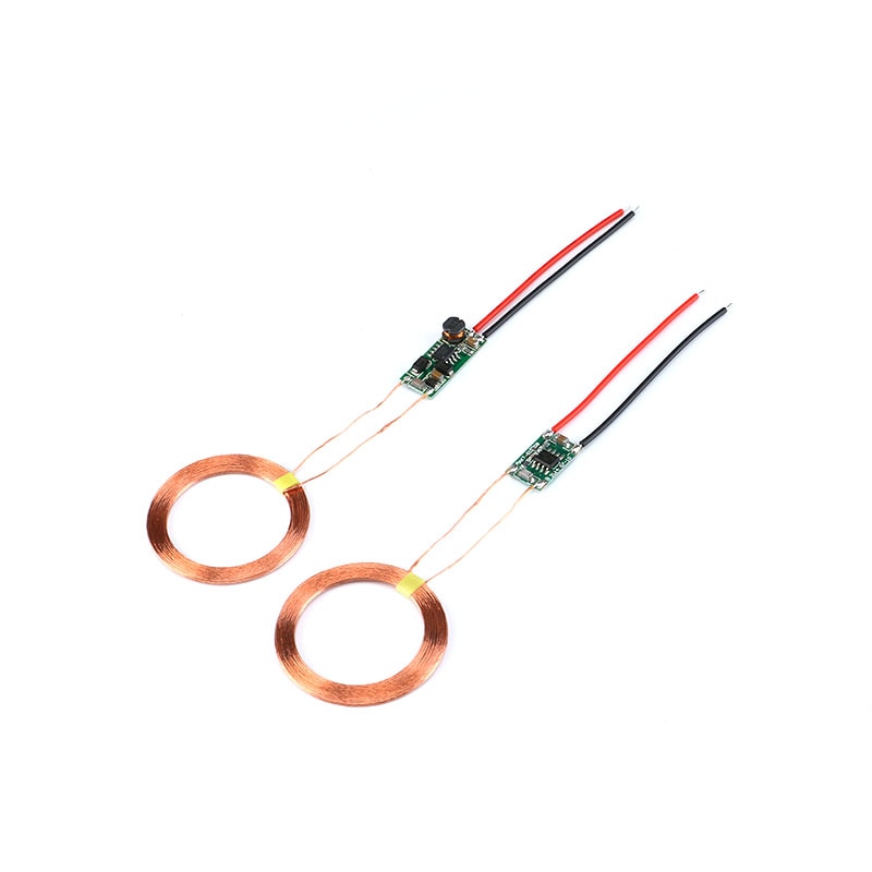

I also considered using strain gages to measure pedalling power.
I found these "wireless power supply" https://aliexpi.com/e2X1
It could be used instead of battery to power up the module on cranks.
(i never have nor used it, just want to give You an idea)
I used this wireless power module for contact- and wireless torque sensing by strain gauges, two years ago.
