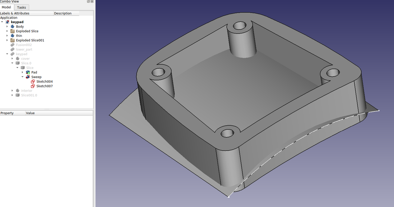

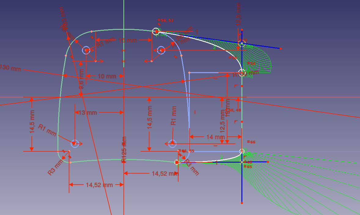

To to see what it would look like I designed a battery case with a CR2 battery, with a access hole for the brakes.
I could make it smaller by using smaller button batteries at the expense of lifetime.
I was motivated to do this as I really don't like the idea of having to dismantle the remote to change the CR2032 battery!
However, the design is pretty bulky, I much prefer the Z modification discussed above to allow for lower remote height and a removable CR2032 battery.

I would do the modification myself on your design, but oh, boy is your design complex!
You are very talented with freecad; I just do not yet have the skills yet to do this mod.....

rananna wrote:
Mar 07 2021 6:54pm
No I am not. I took 2 weeks to look at original file from Stancecoke and understand each step - see the FreeCAD tool used on the left tree, see a tutorial video on youtube about that tool and file I could understand the logic steps Stancecoke took.
I used the same measures for the main 4 holes to the VLCD5 keypad:
This part here is copy the same sketch to a datum plane that is +Z and then use the ruled surface all around and finally apply an offset that will be the wall thickness:
On the top part, there is a curved surface that is created by sweep 2 lines (one is the curved one) and then that surface is used to slice the main pad - that way we get the shape for the keypad:

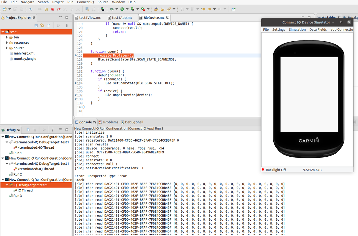

@rananna or for anyone interested, I was able to use the Eclipse debugging for the simulator of Garmin development. The Bluetooth connection is working and detecting TSDZ2 wireless board as seen on the image - I know there is an issue as Garmin only receives first 20 bytes but for the mobile app we are sending much more, I need to see how I will figure this out.
I just followed their instructions for working and debugging using BLE and it is needed a Nordic nRF52 DK board that luckily I had with me from a previous professional work :-)

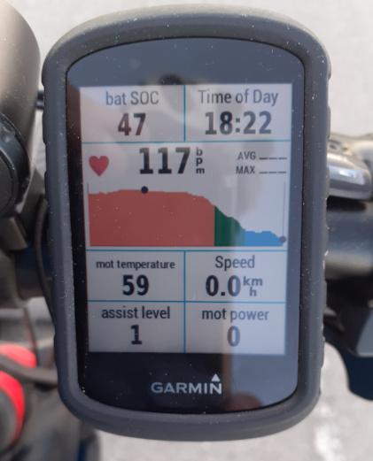

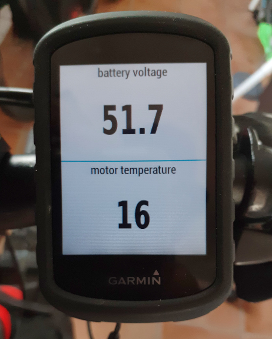

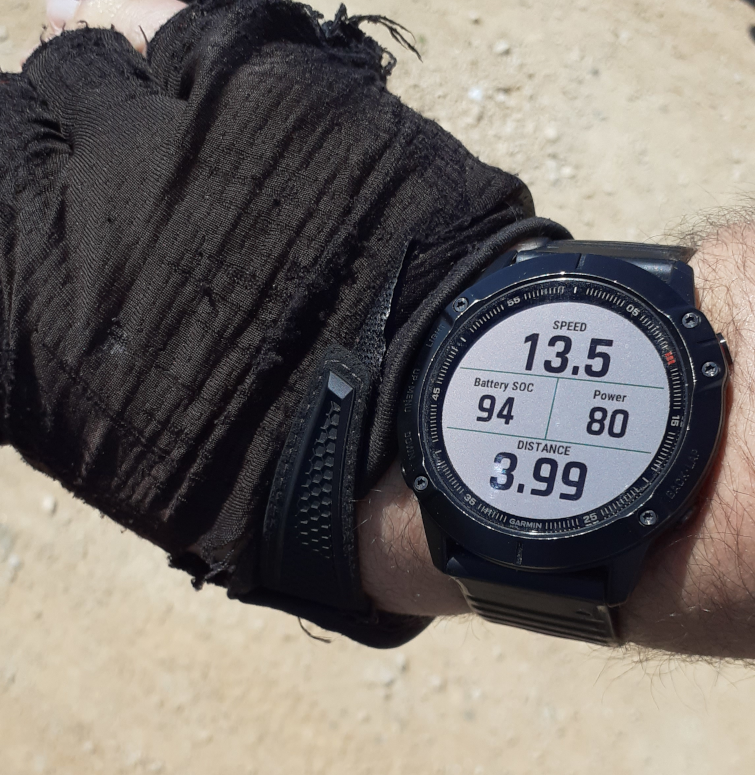

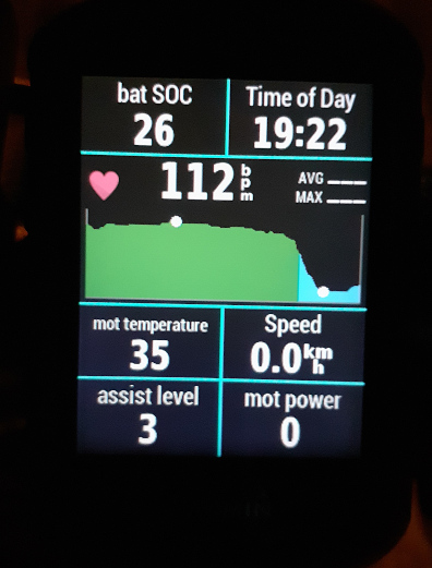

I have the Garmin data fields working BUT, I found in the end that I can not have more than one data field, as each one is like an unique app that tries to connect to the wireless board by Bluetooth and only one connection is possible by Bluetooth, so, no luck here....
I am now exploring to do the same but using ANT. For what I did read, Garmin supports each data field to communicate with ANT but each data field must use a unique ANT channel and seems Garmin limit is 8 ANT channels. So, I think user will be able to use up to 7 TSDZ2 data fields since one is already being used for ANT+ LEV.
I want to implement this test for ANT and I see the limitations of Blueooth and BIG advantage of ANT!!!
- EBike wireless standard: wireless motor, wireless cycling GPS display Garmin Edge and wireless remote with wireless brake sensor

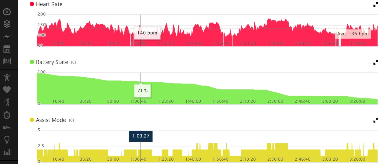

Are all 7 data fields saved in my Garmin account so that I can access them online later? Is that only possible with an edge display or could I also collect this data using a Garmin watch? The most intressting data for me would be the humen power.
I did not thought yet about that but I am pretty sure it is possible to make each data field record (it records to a FIT file) as soon as you start your activity - then the data should be added automatically to your activity just like you have the heart rate, cadence, etc.
I have a Fenix 6 Pro watch and the seems the watchs have a limitation of running only 2 CIQ data fields but I think the Edge can go to 10 or more.
Also I know that each data field can be configured on the Garmin mobile app, maybe a configuration can be to enable or disable the record of the FIT file as recording should use more power of your Garmin device.
Is it necessary to program a own app? Couldn't you fall back on a ready made one in the IQ store? I just had a look and i found these for example:
https://apps.garmin.com/en-US/search?q= ... 0&count=30
PS: I never tested one, so no idea if they are working properly.

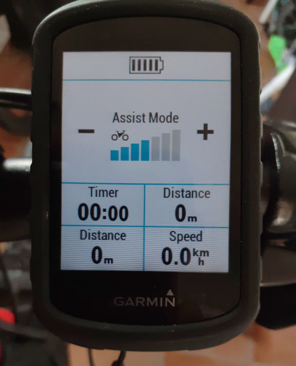

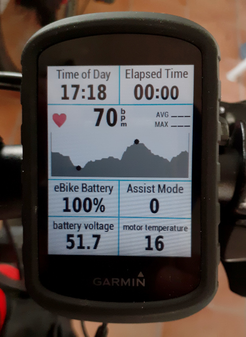

Finally I was able to do it :-)
As for first test, I just made 2 different Garmin Connect IQ data fields, one for show the battery voltage and other the motor temperature.
As can be seen on the following pictures, the ANT+ LEV is working as usually but then I added that new data fields that shows TSDZ2 motor data that ANT+ LEV can not.
I verified that I can only have 7 data fields on the TSDZ2 wireless board but that should be more than enough to show the most relevant TSDZ2 data:

There is an annoying bug on the firmware that resets the assist level when we apply brakes, but this happens randomly, not always but happens maybe 75% of time.
I finally implemented the Garmin data fields but I had an issue that made me almost to quit. The way Garmin let us implement data fields means each one needs a specific ANT channel and seems it brings more drops to the communication and time to connect - luckily I found a way to minimize it.
My plan is to try solve the bug of reset assist level and test more and more the Garmin data fields so then I will make a release.
Today I did the very first ride to the beach at the end of day, here pictures with 1h difference. And I disable the ANT+ LEV on the Garmin Edge so the speed seen on the display is the one from the GPS of the Edge - I have no wheel sensor installed on my EBike:

Today I tested the data fields on my watch but Garmin limits to only 2 data fields on the watch - on the Edge, limits to 10.
So on the next picture the Battery SOC and the Power are from TSDZ2 and Speed and Distance are automatically calculated from the GPS of the watch. I was seeing in parallel the same Battery SOC and the Power on the Edge.
Unfortunately there is that limit of 2 data fields on the watch... what developers usually do is a data field that it self divides in 2 or more parts to show more data, as it is possible to show big data fields of the size of the entire screen / page - but I do not like this, ideally different data fields are mixed together to compose a page (and we can have a few different pages, that we swipe to left clicking on the TSDZ2 wireless remote button).
And the watch measures also my heart rate, elevation, etc, and all that information including the TSDZ2 can be automatically recorded (by the watch or the Edge) and seen on the Garmin app at the end of the fitness activity, for instance:
