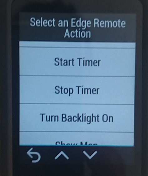

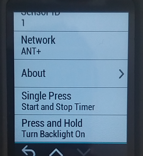

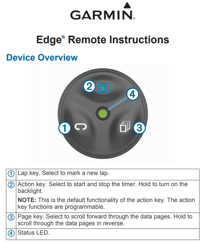

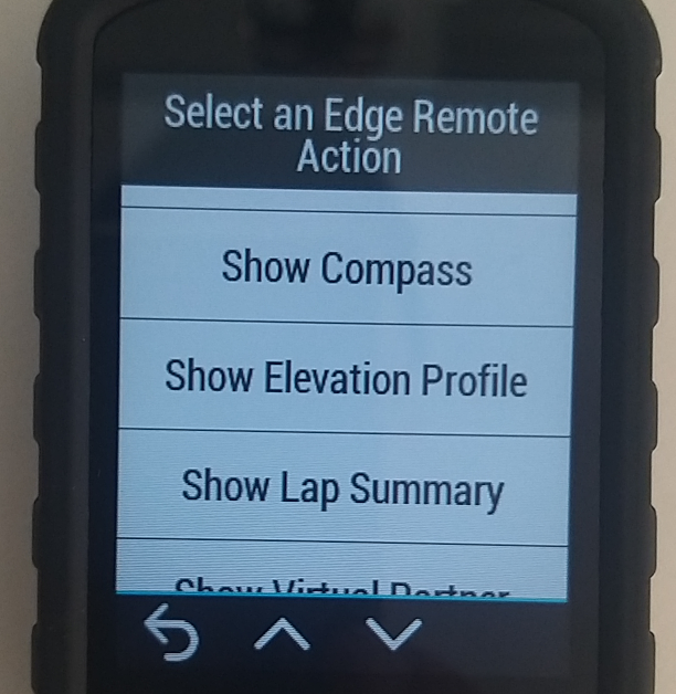

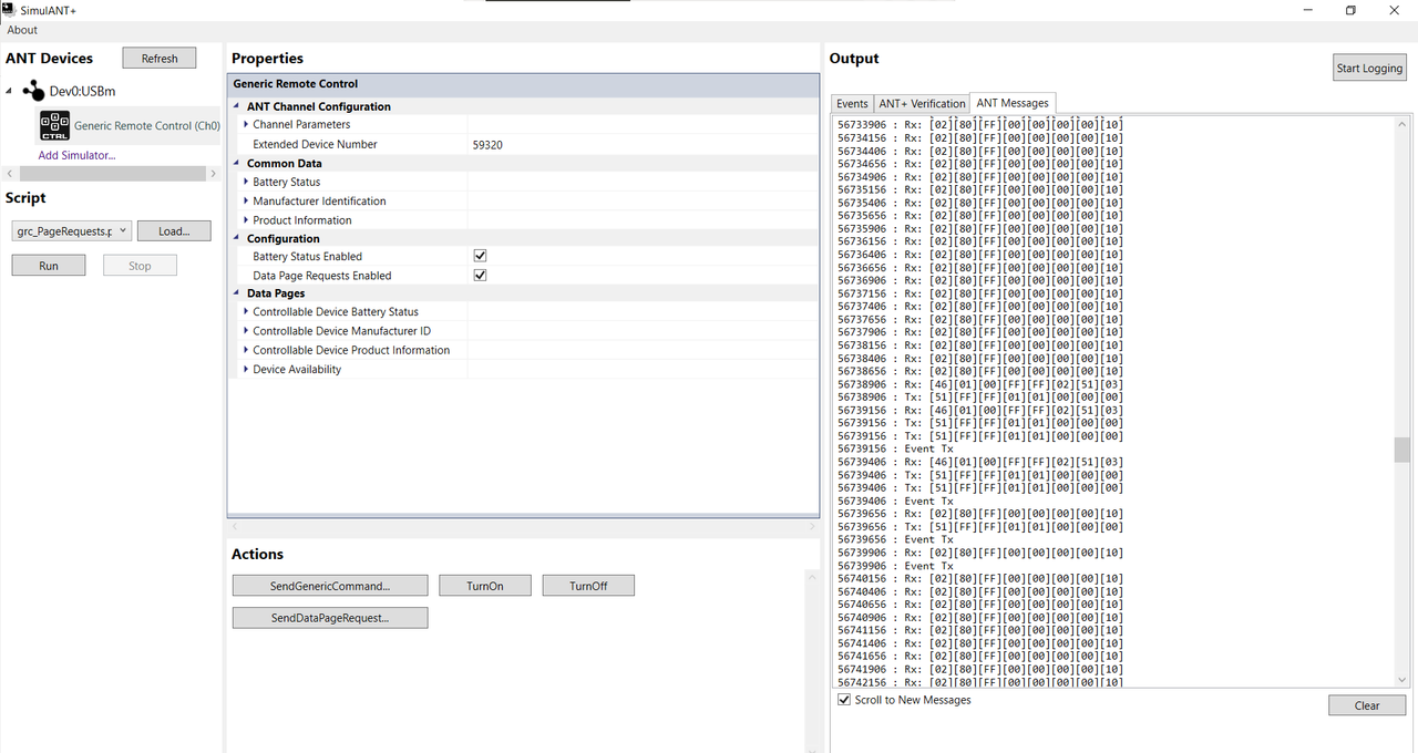

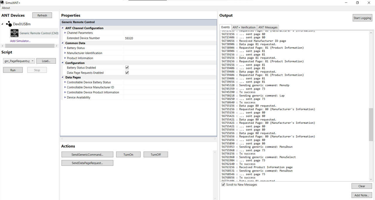

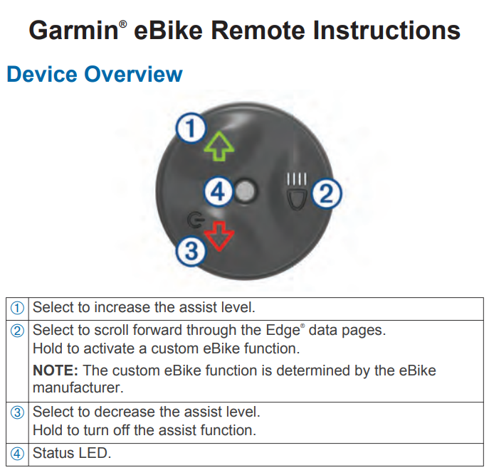

Post by casainho » Jul 25 2020 5:49am
I am a bit tired of trying to get UART working on the firmware, using the latest SDK of Nordik...
Meanwhile I tested using ANTSimulator (Windows only) to simulate a remote. I tested to send the command 0 and it simple switch the Edge pages.
My plan to chill out a bit, is to quick develop the firmware for having an Edge Remote, that let me change the Edge pages while I am riding. This firmware can after evolve to the ebike remote remote button:
ANTSimulator working as a Generic Remote:

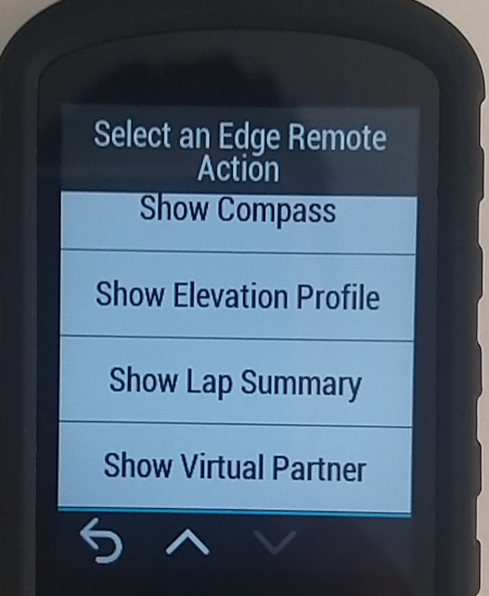

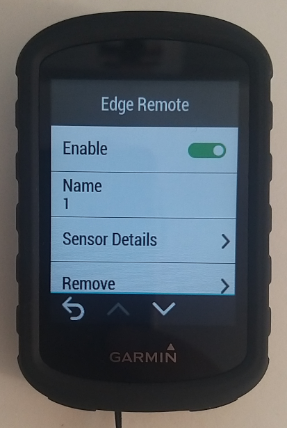

And the configurations on my Edge for the Remote sensor:
The last option is "Show map":

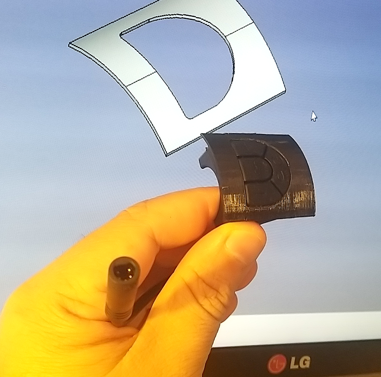

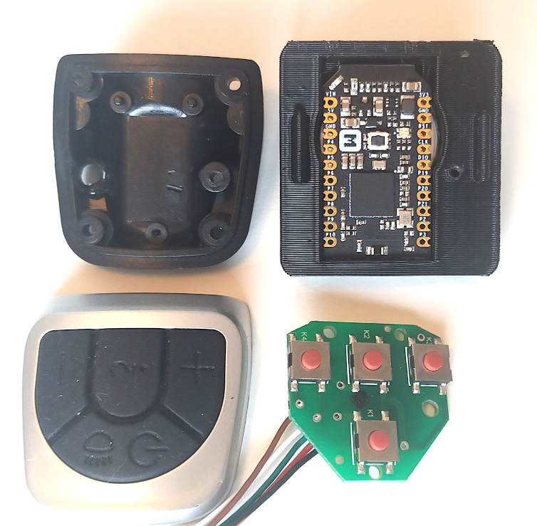

Post by casainho » Jul 25 2020 3:06pm

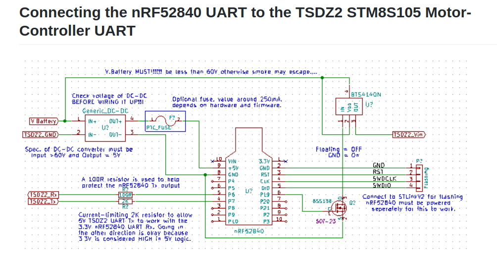

Thanks @bobreece20 for updating the schematic and documentation (using a pull request).
As I want to make my own remote buttons, I started to design an enclosed on FreeCAD for reusing the VLCD5 remote buttons board and pad:
And the schematic draw by @bobreece20:

Post by bobreece20 » Jul 25 2020 3:41pm
casainho wrote:
Jul 25 2020 3:06pm
Although I have been updating the schema I cannot take claim for the original creation and that one in particular is not one I've touched, I believe it's from @Headless. It would be good if we can get it in github though so it can be updated if needed :)

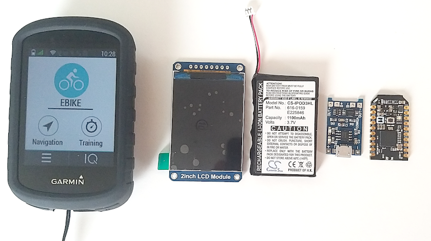

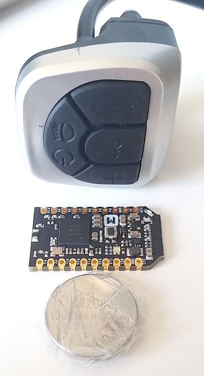

Post by casainho » Aug 01 2020 4:56am
I am being procrastinating on the firmware side. This week I decided to learn more about FreeCAD to design and 3D print my own remote buttons - but the VLCD5 remote buttons touch pad (the only missing part now) has some very specific curves in 3D that I am not being able to replicate on the design... current status:
And I also received the IPS 2 inches LCD I bought. Here is the LCD, battery, battery charger board and the wireless board with the microcontroller. The idea, that I don´t know if I will find time to do it, was to design and 3D print the enclosure for all that to make a cheap wireless display to show the same information as 860C display + user heart rate. The possibilities are customizing for a bigger or smaller battery as also wireless charging instead of using micro-usb:

Post by Waynemarlow » Aug 01 2020 9:23am
Casainho, would it not be easier and lower work hours for you developers to simply extend the wiring of the keypad back along the frame to the small box that will have to house the other components. An all singing and dancing bluetooth keypad solution is the ideal, the not so ideal is having one very small electrical cable linking the box and keypad, but you will have time to go riding and we will all have the keypad ready and waiting to connect from our original kit. :D

Post by stek692003 » Aug 01 2020 10:51am
Rather than 3d printing a whole new remote enclosure you could just design a spacer for the current one. You could even possibly do this without a 3d printer.
