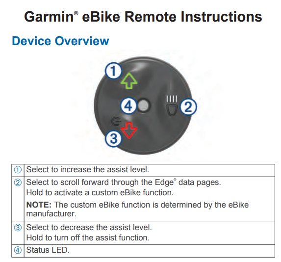

So, the assist level changing on the wireless remote works very well, no missing clicks even if on the mobile app or on the Garmin Edge there is a delay showing the value:
@rananna,
When we say that we would like the system to be easy to install, then we must consider and recommend to users buy instead a commercial remote and that means we need to develop the system thinking on that (this is part of advantages as also need to use standards) - our remote must behave similarly:
But our remote can have some extras that will make it better but will not invalidate the usage of commercial ones:
- connection for the brake sensors
- we can show some information to users using the RGB LED
I think the wireless board should have a big press button and the RGB LED, for things like:
- turn on/off the system with long press
- change the assist level with 2 quick press
- see assist level with quick press (will blink the LED xx times for assist level from 0 to 7)
- some way to select show the battery state using the LED blinking xx times
- RGB LED blink every time assist level is changed, brake is active, etc.

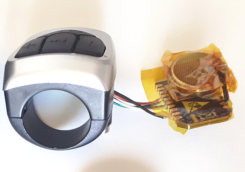

However, please note that the assist command is sent to the motor in about 25ms, so there will be no delay in the motor in changing assist level.
casainho wrote:
Dec 16 2020 4:21am
When I implemented the remote, I had this compatibility in mind.
The current functionality of our remote duplicates buttons 1-3 of the garmin remote exactly.
see: (I accidently reversed labels 1 and 3, but you get the idea)

This would mean that only the wireless board is the necessary part, no even the remove, so, no afraid of battery fail because of being discharged.
I agree, the system should be able to function without the android app or the remote.

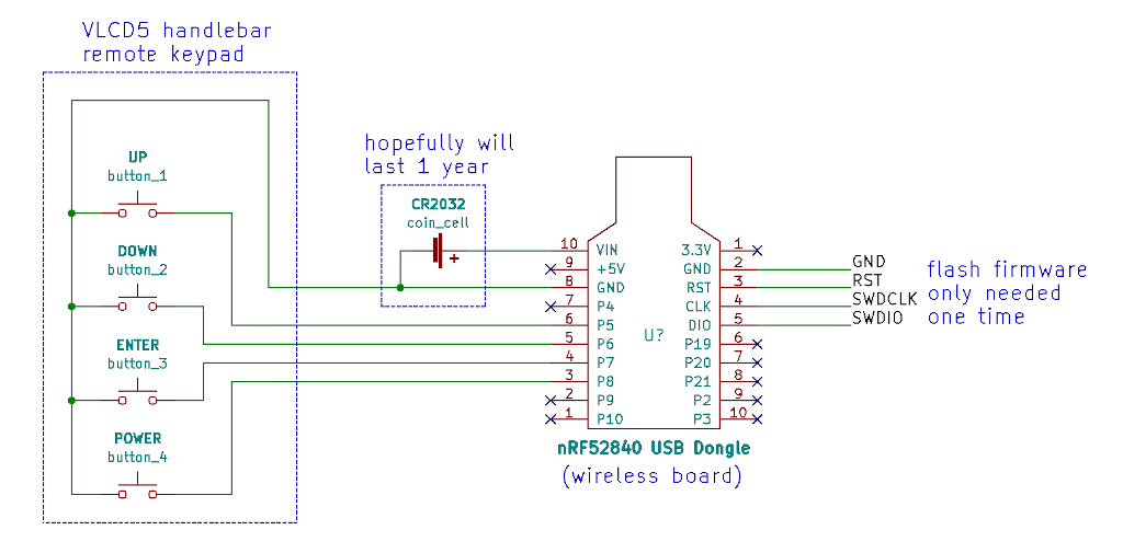

This will be tricky. Perhaps use transparent/translucent plastic box covers so that the LED is visible and the boards are protected from weather? Can you 3d print in transparent plastic?
casainho wrote:
Dec 16 2020 4:21am
Do you know if on your wireless board, the power LED can be eliminated, to save the power?
The good news is that this is another advantage of the Nordic dongle.
There are actually FOUR controllable LEDs on the nordic board!
LED_0 is a green power LED on one side of the board.
LED_1(red), LED_2(green), and LED_3(blue) are on the other side of the board
All LEDs can be controlled in code, including LED_0, eliminating any power draw.
I have done this for the remote control.

So, looking at the Garmin, there are 3 buttons with click on each one and long click on 2 of them:
- UP click: + assist level
- DOWN click: - assist level
- LIGHTS click: (not for TSDZ2) Edge data page forward
- UP long click: not defined (maybe we can use to walk assist or lights on/off - will not be available on Garmin remote)
- DOWN long click: turn on/off the TSDZ2 motor
- LIGHTS long click: (custom EBike function) maybe we can use to walk assist or lights on/off
So, I think we will need to have a configuration for user to say what wants on LIGHTS long click: walk assist or lights on/off.
And I would put motor on/off on the LIGHTS button and walk assist or lights on the DOWN button, as it works on 860C/SW102 display.
When using the VLCD5 remote, we have 4 buttons and I think we can use the extra button to be the Edge data page backward.
The idea of using a small box for the wireless board on the remote, means users can chose any remote, like I think the 860C display remote is the best one I ever used.

casainho wrote:
Dec 16 2020 4:21am
Next step is to validate current wireless board (it is raining a lot on this days, is hard to go outside to experiment all this) and then start to document as also design the smallest 3D printed box for it, keeping the RGB LED accessible to be seen but also block the power LED (the RGB LED can also be used as power state, like with small PWM value so small light and increase the brightness for the other states like show assist level changing or brakes). The only extra thing to add to current schematic is a big press button.
Also there is the 3D printing design, that must be done, for the box case for the wireless remote, that must be small as possible and show the RGB LED. Do you know if on your wireless board, the power LED can be eliminated, to save the power?
That is already a big step in the right direction. A nice opportunity will be to reuse the code for the buttons form the 850/860 display. This will give the user the option with no change on the existing wiring to remove the existing display and to connect the wireless board box to the buttons and to the motor. The buttons can have exactly the same functions.
+ short press - change up the assist level; long press - switch on/off the headlight;
- short press - change down the assist level; long press or hold - walk assist mode
Power is power like you suggested above.
For the RGB led a nice option is ws2812b. It costs peanuts and exit in both RGB and RGBW versions. It is widely used in many hobby projects, so you can easily find and reuse the code. Requires only one pin.
If you do that I will immediately start testing. I have the required cables and will design and print the required 3D printed box.

plpetrov wrote:
Dec 16 2020 1:53pm
I am not sure you are thinking the same about the 860C buttons...
Well, it is early to design the box for the TSDZ2 wireless board, maybe in 2 weeks I will get it tested and final. For now, only the wireless remote hardware is finished, so please go ahead and design and 3D print the for for it:
The final schematic:
The idea is to have a black box instead of that black tape:
- TSDZ2 OpenSource firmware

Overall, the cost this wireless ebike implementation for both the remote and the wireless controller is a tiny fraction of buying a comparable wireless ebike. I don't thing we want to complicate adoption and ongoing support by recommending multiple boards.
Yesterday I just found the Nordic board for more than twice the price on EBay. Yes, I just verified on Aliexpress, that is correct, the price of both boards there are mostly similar - this information needs to go to the wiki!!
The users will probably need to buy 2 boards, and I found at 17€ on Aliexpress, so 34€ for a EBike. If the price would be double than would be 68€, which for me makes a big difference.
The low price is important so this option may be favorable as the first option for TSDZ2 and second the displays.
If user opts for no remote and change assist level on the phone or on the TSDZ2 wiireless board, then I think the final price can be:
- 17€ wireless board
- 2€ 60V to 5V converter
- 9€ for the switches and other materials
30€ total.
The price of SW102 is very low, similar price: 35€.
The SW102 is hard to flash the bootloader and can not implement ANT, otherwise would be a similar option. The wireless board on the other side has the disadvantages that to include a remote (like SW102) will cost about 60€, components must be sourced from different shops, solder them, 3D print a box and assembly.
I wish this project have the most success possible (every users using it and not only the ones that have a Garmin GPS) and so I hope the prices are low to be able to convince the new users: they will have to pay at least twice the price of the display SW102 and have a fair amount of work.
I really appreciate your efforts for this development. Like you said, the beautify of the open source is that everybody has the option either to use the project as it is or to adapt it to his own need.
As for the moment the wireless remote is of no use for me. I do not have and do not plan to use any Garmin devices. I have brake sensors that are already cabled and also, as the brakes use either wire connections or hydraulic tubes, running the cable for the brake sensor or an extension cable for the motor in parallel is the same.
My use case is/will be the following:
- No wireless remote.
- The wireless controller will be installed on the handlebar, connected and powered from the motor. The brake sensors are also connected there.
- As for the buttons there are several options:
a. Design a case similar to the SW102 with embedded buttons.
b. Use the buttons you suggest or the ones from 850 or 860 display.
c. Use any buttons.
They are simple three to four buttons and how they are installed and connected does not make any difference.
As minimum we need:
1. + (plus); short press - change up the assist level; long press - switch on/off the headlight;
2. - (minus); short press - change down the assist level; long press or hold - walk assist mode
3. Power
- The motor for me will be controlled from the wired buttons. The use of the phone is optional.
As far as the development we need to define the pins and port the code part for the buttons from the previous project for the three supported displays. Checking your implementation I see you have kept the same code structure and the part for the buttons is there, almost empty and not used.
Adding a multicolor LED or a small display ( overkill in my opinion ) will be nice to have.
