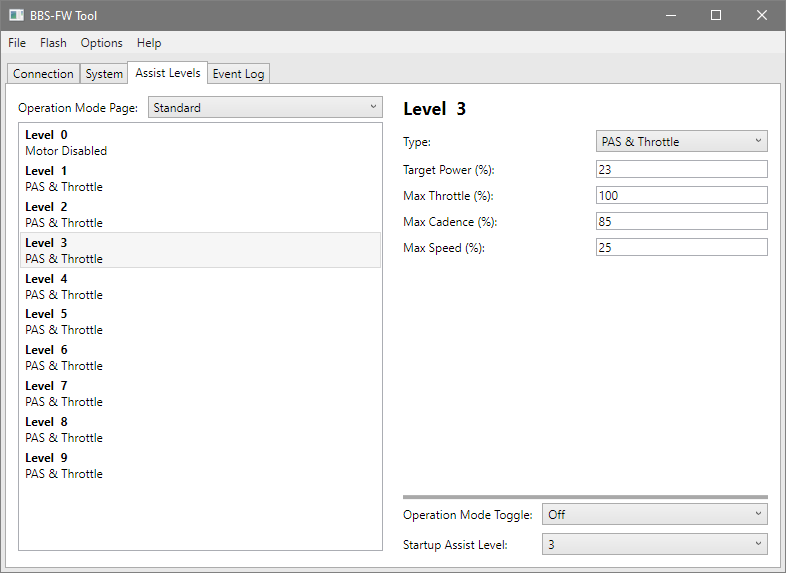

Configuration Tool
To give you a hint of available options.
