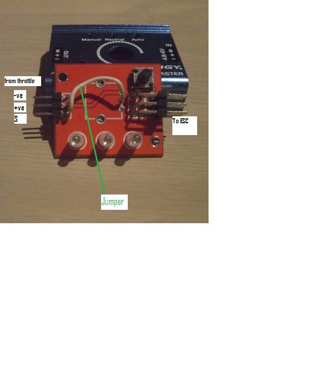

Hello,
I have servotester.
http://www.hobbyking.com/hobbyking/stor ... rvo_Tester
Also Hall sensor
I did the following
1) remove the potentiometer.
2) insert a jumper lead from the input signal pin to the potentiometer socket centre pin location.
3) reassemble and plug in your throttle.
But it did not work for me.
Testing the hall sensor give me 0,7 - 4 V
What else I can do?
Tanks

renaatdb wrote:Hello,
I have servotester.
Also Hall sensor
I did the following
What else I can do?
Tanks
I could be wrong often am, but i never had any luck connecting a hall sensore effect throttle to
a servo tester, actually when Hyena was over he tried and blew up a servo tester :-| Dunno if it can be done?
I have always used Magura (pot) throttles...

It really depends on the servo testers design, you will need to test by looking at the pot in the servo tester to see if both ends of the pot are connected to the rest of the circuit first, then with a voltmeter mesure the voltage across the pot if it dont read a steady 5v then its not doing to work
edit: if only 2 connections from pot to servo tester then will only work with a pot throt, if 3 connections from pot to servo tester and there is 5v across the pot then a hall throt should work.

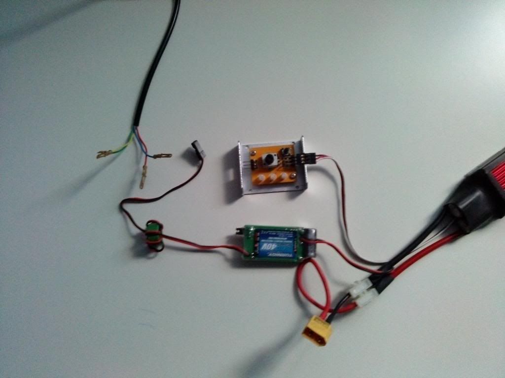

Hope you can help me out here,
I am building a Stiga Snowracer with a outrunner to drive the snowracer, I am alomost finished with the mechanical side. And have the motor up and running with a servo tester,but would like to add a throttle handle so that it is easyer for the kids to ride it.
Here is the setup I have
5S Lipo connected with a Sbec that is connected to the ESC
and the throttle i would like to connect.
Question:

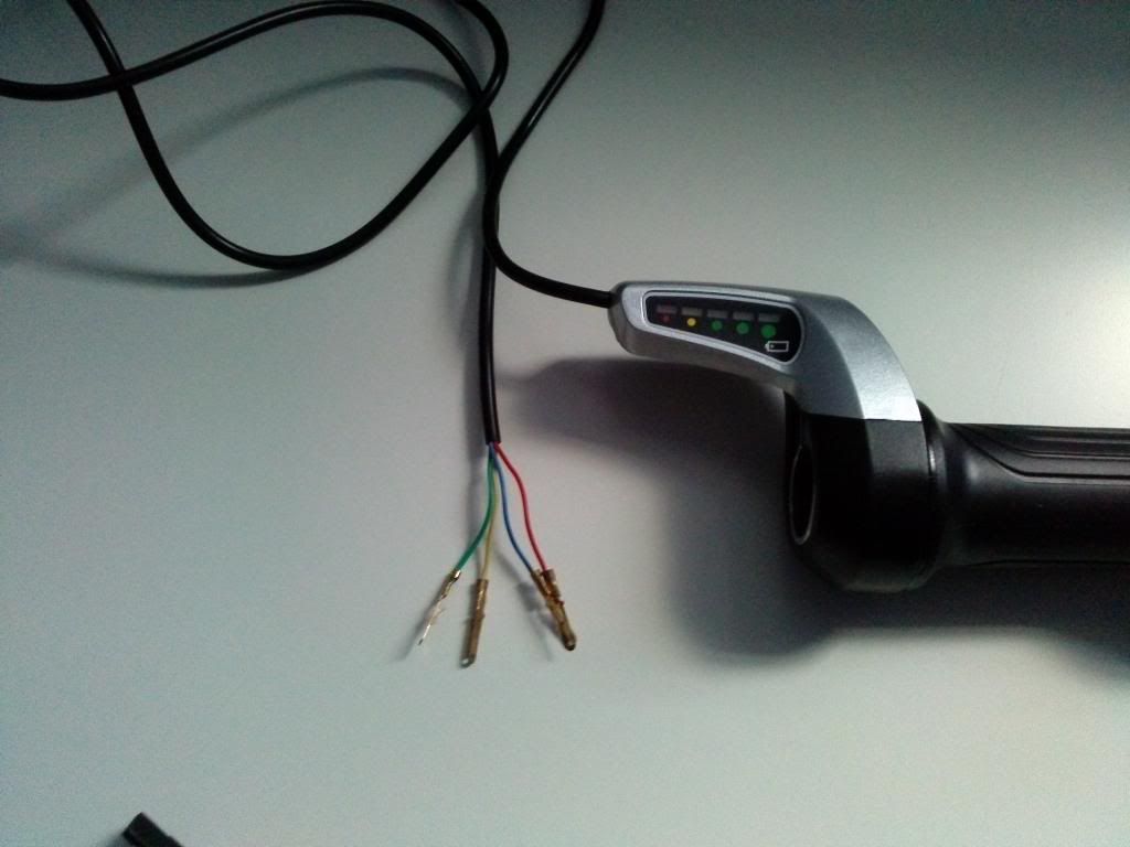

Where do I connect the 4 wires from the throttle ? I do not need "power indicator" on the handle so maybe I only need to connect 3 wires ?
How do I connect the Sbec if I remove this and insted connect the throttle on this side ?
I hope you understand, and can help me with this. The snow is melting fast here so I need to fix this fast :)
Here is a render of how the Snowracer should hopefully work,it is mainly designed to be used on the street with fairly hard snow.

first i would start with th ealian throttle as it only has 3 wires and these wires are obvious what goes where, unless soemone can say for sure what color wire goes where on the 4 wire throttle, one of the wire will be for th eleds on the throttle but your guess is as good as mine to which one, red = 5v black =gnd , other color = signal ( on the 3 wire throttle )
you will need to take a nice close up picture on the underneth and top of the servo tester board so someone can tell you how to wire everthing up ( or even if its possible to do with the servo tester that you have )

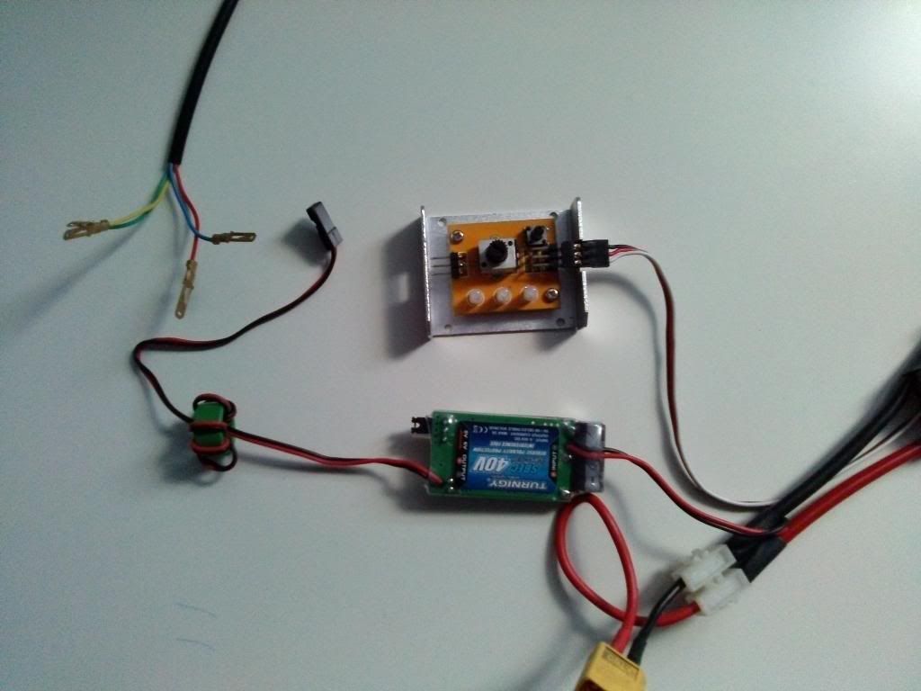

Post by Slowrider » Feb 17 2014 12:37pm
Many thanks for the feedback so far, bare with me as I am a noob when it comes to electronics.
This is where I am at right now,
I connected the ailien power throttle with black to -, red to +, and white to signal. This makes sense to me if we consider the connection digram on the Turnigy unit.
So next I need to remove the pot (we will now use the pot in the hand throttle) and make a jumper wire like hill hater described on this picture.
BUT, where do I connect the Sbec to supply the 5V for the ESC ???

Post by Slowrider » Feb 18 2014 6:01am
Anyone that can help me with where to connect the 5V from the bec to the modded servo tester or is this just not possible ?

Slowrider wrote:Anyone that can help me with where to connect the 5V from the bec to the modded servo tester or is this just not possible ?
just connect the output ( + , gnd ) of the BEC to the + and gnd of the servo tester, you could connect to the +,gnd of the throttle input.
Like this ?
