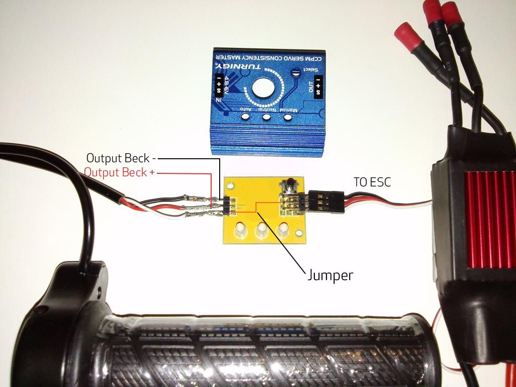

Slowrider wrote:Anyone that can help me with where to connect the 5V from the bec to the modded servo tester or is this just not possible ?
just connect the output ( + , gnd ) of the BEC to the + and gnd of the servo tester, you could connect to the +,gnd of the throttle input.
Like this ?
I tried this setup but it is not working yet, what is this jumper ? Just a wire from Ebike throttle signal to ESC + ?
I have this servo as well with a cheap thumb throttle, did you get it to work after?
Re: RC throttle interface build tutorial........
Posted: Jun 06 2017 3:27pm
by TheGuiX
Hi !
This is the correct wiring for the servo-tester with non-BEC ESC :
The jumper 1 is not necessary if the ESC has a BEC
:wink:

TheGuiX wrote:Hi !
:wink:
What is POT? A potentiometer?

by Ecyclist
Will modified servo tester work with only potentiometer type of throttle or hall type as well?
I got it. It works for either one. That is weird but good news.
