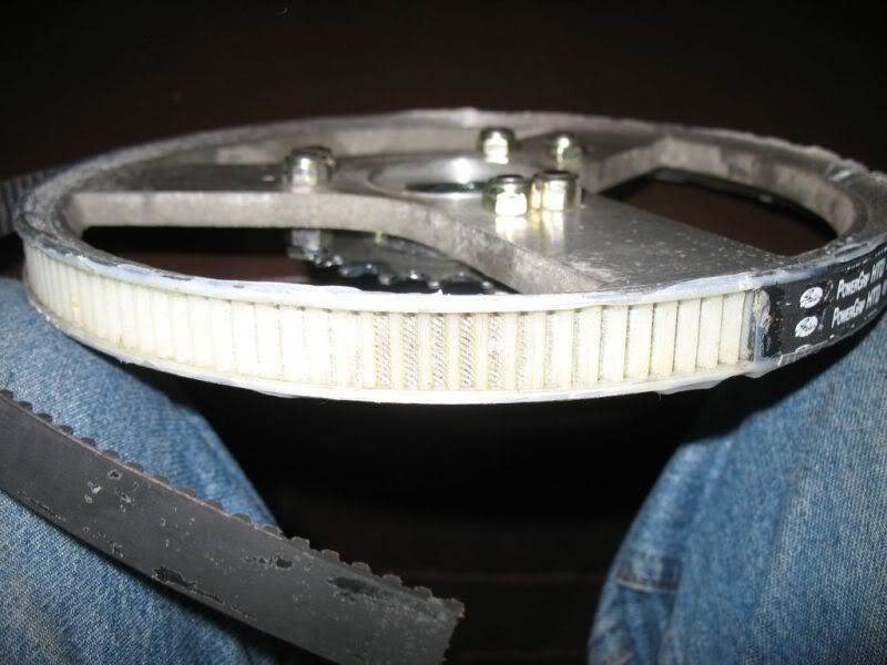

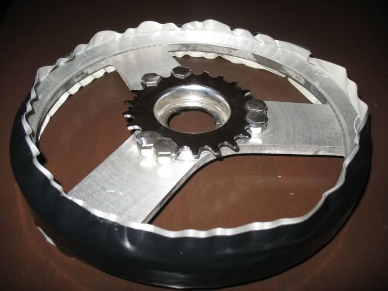

Mounting the Pulley
Postby AussieJester » Mon Nov 09, 2009 4:37 am
Update
Decided to take a break from the battery enclosure today, have reached
my fiberglass tolerance threshold for the next few days, so
i worked on fitting the sprocket too the rear pulley, stretching the chain stays
out to allow room for the pulley while also gaining adequate room on the left of the hub
for the left hand thread freewheel to be fitted.
Matt Parks (1000watt) as many have seen fitted a extra wide hub with the same
pulley i have chosen too use, here's how Matt went about this-->
Now if you look closely you will see the gaps between the bolts differ, this
is due to the tooth count its not possible to have the same gap between the bolts
holding the sprocket on. I was initially going to copy this method as Matt has done,
as its very solid & looks ok, then I thought, well, why not remove the teeth and notch
my own recesses for the bolts rather than using the pre-existing teeth for the bolts to 'grab' on too!
(drilling isn't an option the sprockets are hardened steel)
So, Here's how i went about modifying the sprocket -->
The pulley has been drilled and tapped using 8mm high tensile steel bolts, The bolts fastening
the sprocket too the pulley are still an issue however, they hit the chain stays
by the sliiiightest of margins, a slight grind would fix this BUT i decided better option
would be too use button head cap screws SO i rang Coventry Fasteners checked availability
thankfully they have stock of 8mm x20mm stainless steel cap screws SO i ordered 10
and have mate picking them up for me, the rounded head of the button head cap screws
