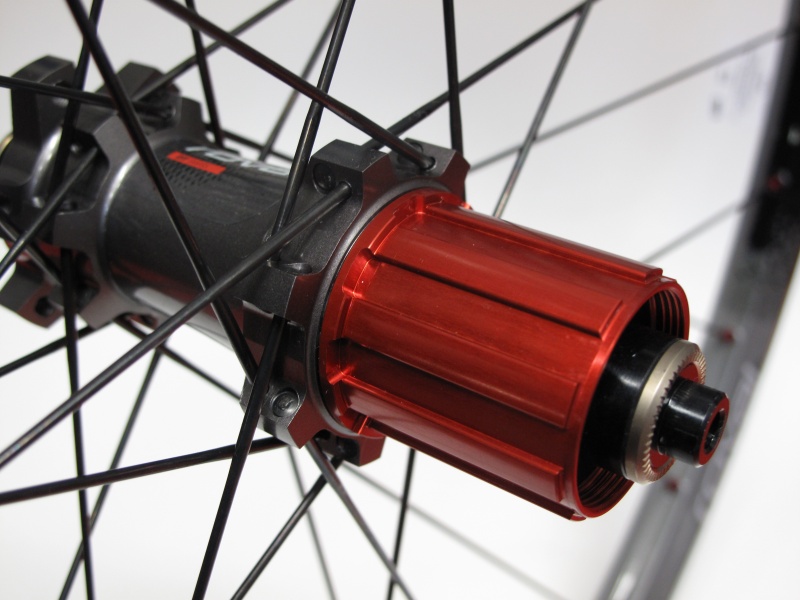

here you go Gwhy. I am pretty certain Mud has one of these large dies.
actually I have 2, I ruined the first one trying to thread a freehub and not realising it was hardened. :oops:

As Mud said, you can't cut threads in a hub body as it is hardened. You can get a hub body with threads though and it will easily hold pedal power. Old school hubs used to hold the sprockets on by threading the last few sprockets on like a freewheel, or freewheel "cassette". Look for old uniglide hubs. You may be able to find a few still being made or you can get them with a full hub. Most hub bodies you can remove from the hub and put on another hub, but some are not interchangeable.

IIRC, there are alloy freehubs...

flyinmonkie wrote:As Mud said, you can't cut threads in a hub body as it is hardened. You can get a hub body with threads though and it will easily hold pedal power. Old school hubs used to hold the sprockets on by threading the last few sprockets on like a freewheel, or freewheel "cassette". Look for old uniglide hubs. You may be able to find a few still being made or you can get them with a full hub. Most hub bodies you can remove from the hub and put on another hub, but some are not interchangeable.
FM
I will soften it a little so it should'nt be a prob ( but it might be, I got to try it ) . I also what to make the freehub shorter so the dish on the wheel isnt so extrem ( I have a really wide rim )..
Have to given it another go but try softening the hub first..

There are also heavy duty (Chris King) hub sets (or extreme use), and upgradable parts available for Mountain bikes, downhill machines, or free ride types to even further extend the durability. Stainless steel axles, mounts and shells can be installed to bombproof the hubs.
The most useful upgrade we have seen for mountain bikes is a stainless steel rear shell that the cassette slides over and locks on to, as apposed to the standard road bicycle aluminum. With the Shimano XT, XTR and many other brands, the standard aluminum Chris King rear shell gets gnawed by the smaller separate cogs, on the rear axle, that are not part of the unified section of larger cogs, mounted on the alloy carrier, which all together make up a mountain bike cassette.
I launch the bike from a standstill "feetup" to throw the bike up stuff, its not you typical riding style :mrgreen:
I think its because of the hammering effect , if the freewheel isn't engaged when I dump the throttle it can have a lot of travel before it engages so the pawls hammers into the rachet mech and i think this is what has happened. The chris king hubs are very good but very expensive for something that may be ok. I am going to re arrange my drive so that the motor driven sprocket on the wheel is going to be fixed then hope the spokes dont start braking instead :lol: .

Hi D Im sure that for normal/off roading most hubs will be be fine ( I am asking alot from pushbike components for the style I ride ).

I would have thought for trials type riding having a freewheel on the back would be worse than fixed anywayz, wouldnt it be more 'motorcycle' like with a bit of resistance from the motor when you throttled off?
Im sure with fixed sprocket you wont have issues anywayz gwhy :-)
