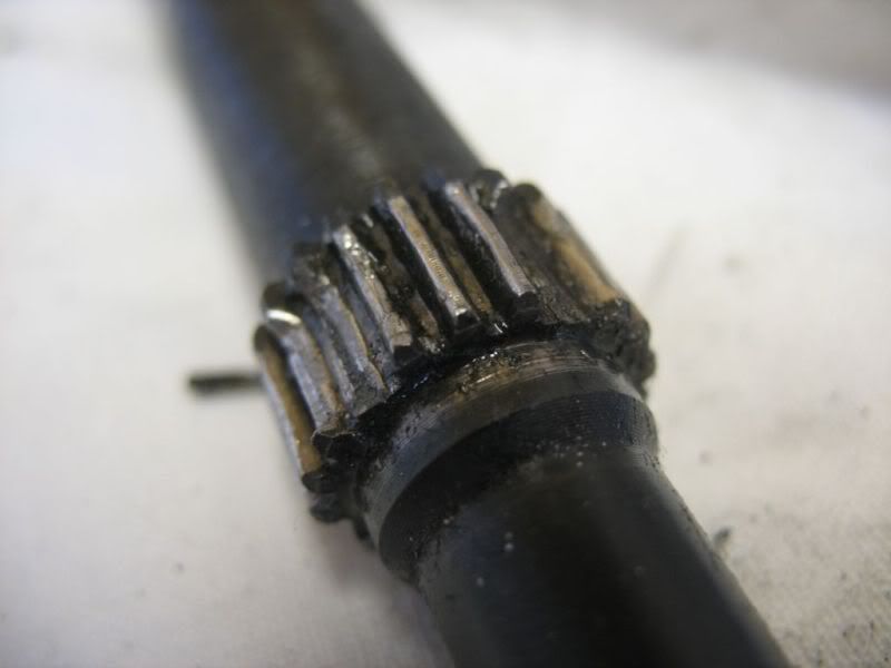

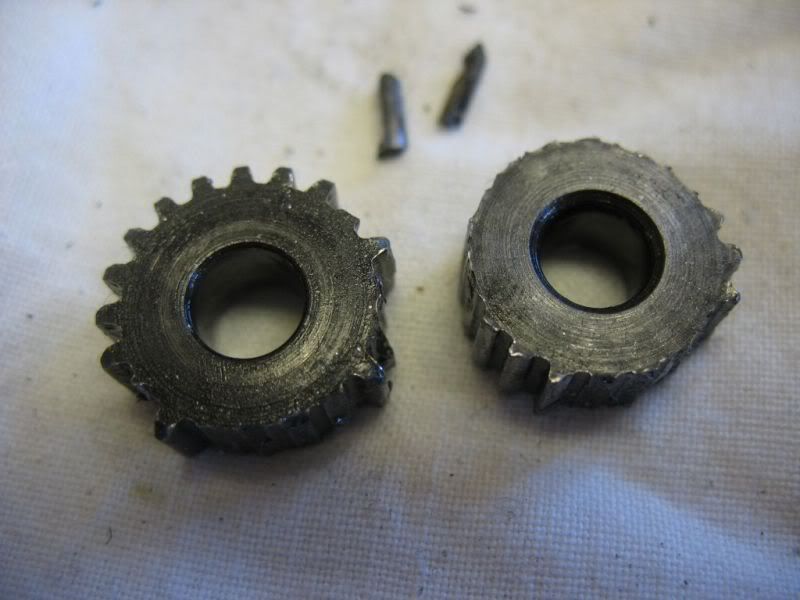

Re: Which gear in a 3 speed hub is strongest?
Ok guys, I opened up my hub today and looks clear that the sun gears are not upto Ebike power loads.
Here is the hub.
Here is the main shaft showing tooth damage where the sun gears run.
Here are two of the sun gears and a couple of teeth.
I don't think there is much future for this hub!
Cheers,
Matt.

- AussieJester 100 GW
- Posts: 8736
- Joined: Mar 11 2008 3:33am
- Location: Perth Western Australia
Shit that was quick Matt only just hung up the phone hahaha...that is certainly rooooted...
So...whats the deal with the multi speed Sram hubs the fellas are popping dual eno freewheels on, are they going to go BANG like this too peoples? all the efforts to broach the enos will be pointless if these hubs have similar internals...
Thanks for the pics Matt...glad i got you to grab me a back up freewheel extra wide hub from ChoppersUS too i unfortunately I forsee it will be in use alot sooner than anticipated..
That is the failure I would expect.....bummer.
I am still optomistic.
I know these things are potentialy fragile. But with a proper cush drive on the driven sprocket & a careful (I know...what fun is carefull?????
) shifting tecnique.
I will become a pessimist once I break my 3rd one under normal use.
(still need to break the 1st one...I am starting to hate winter)
either way, damn shame on the unit 1000w....always sad to see death in such a nice mechanical assembly...

That damage is not encouraging.
I'm wondering if there is any other internal failure... I vaguely recall some comments about damage to high or low gears; then broken pieces getting jammed into the planetary section.

I do recal Matt mentioning on the phone today the Pawls were all in good condition still TD...pretty sure the components hes shown are the only ones damaged though...TylerDurden wrote: I'm wondering if there is any other internal failure...
Thud you dont need to be messing with this off the shelf garbage anywayz you have your L337 2 speed reduction unit!!!
KiM
edit: OH and yes TD, the 1st and 3rd gears were the first to go 2nd remaind working until.....well....^^^^
So i guess it could be possible the 'broken pieces' from this failure would have contributed to the ultimate terminal failure of the entire hub

In the SA, the planetary is always meshed and rotating during operation, but it has no load when 2nd gear is engaged.
1st and 3rd require the sun to be intact to operate; so with a stripped sun, 2nd can still work, but there might be some noise from the planetary.
If a broken tooth from the planets or sun gets into the ring, 2nd will jam.
