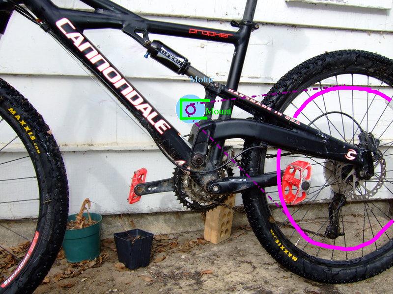

How about this new plan for doing an RC bike on the Prophet:
Make a 1 stage 15:1 or 20:1 reduction using a very long timing belt.
1. Mount a 1 or 1.5" fine pitch toothed pulley on a Astro 3220
2. Use a 20" bike rim as a large smooth pulley. Mount this to spokes of rear wheel.
3. Somehow find a matching very long fine pitch toothed belt.
Plan is to run this with 36 to 48V 15Ah A123 pack with a 100A+ controller. Using a 3 turn 3220 with 20:1 reduction speed (under full load) at 48V should be about 60km/h with 10,000rpm on motor. This is for offroading.
To go faster I can just swap in a larger front pulley.
A conclusion from the thread http://www.endless-sphere.com/forums/viewtopic.php?f=2&t=17401&start=15#p254804 was that it is good to build in some slip/clutching into the drive train to reduce stress on touchdowns or other sudden acceleration/de-acceleration during aggressive riding.
Here I was thinking to set the belt tension just tight enough so it doesn't slip under full motor acceleration, but it if forced by a sudden jerks / large forces on the rear wheel the belt can slip instead of back driving the motor. With a toothed front pulley the slip will happen on the very large rear pulley/rim. That should be large enough to dissipate any friction heat.
There are plenty of BMX 20" rims I could try for the rear pulley. Just have to find one with a reasonably flat bottom.

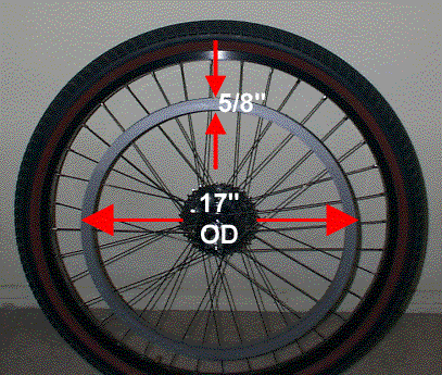

I'm thinking to try the GEBE wheel, seen here in an image copied from the link above. I read through Grinhill's build thread.
I'm going to need a longer belt than GEBE offers. The c-c distance of my motor mount and rear wheel is 21".
Miles and Grinhill identified the belt ast a Gates 5mm pitch 9mm wide (XXX-5M-9 HTD). Not as beefy as the 13mm belt Matt/recumperence uses, but hopefully enough.
Also have to find some motor pulleys that fit the Astro 3220 shaft. Maybe an 11 and a 13 tooth.

After measuring clearances, it turns out I cannot mount the motor below/near the BB as shown in the previous post. The belt doesn't fit between the swingarm and tire. (This low mounting position will only work with a relatively small rear sprocket or pulley)
I did some more meaurements and mockups (Tip: A Dole pineapple tin can is the same size as the Astro 3220 motor). It looks like I can mount the motor as in the image below.
However now the problem is to find the right size belt. I need a 1860mm long belt, but Gates only has 1720mm and 2100mm in the on-line catalog. Any idea where to find non-standard belt sizes?
(I cannot move the motor much forward, or it would hit the frame during suspension motion. (It is mounted to the swingarm). Taking up the extra 240mm of the 2100mm belt zigzaging the belt around idler pulleys also seems inelegant and would be hard to fit)

B.t.w. The c-c distance between motor axle and rear axle on my bike 21" (motor adjustment could allow for 20.8-21.2"). I calculated the belt length assuming a 17" rear pulley (not sure if this is exact; GEBE doesn't list diam. Found it on another web site.) and 15 tooth front using
c = 21*25.4
d1 = 432 %mm
d2 = 24 % mm for 15 tooth
L = 2*c+(d1-d2)^2/4/c+1.57*(d1+d2)

Over the week I had some pmail exchange with Grinhill who used the GEBE system, and on Fri I called GEBE and ordered my own 17" 5mm pitch HTD pulley.
Grinhill mentioned that the pulley is only partially toothed. For him it will slip on the rear pulley at about 2kW of power. (Didn't ask speed/rpm, but I assume some regular eBike speed, e.g. 40km/h +-20%. Now it is likely that it was designed to slip on the rear and not the front to limit belt damage (lower per length unit contact pressure). If it had slipped on the front, it might likely tear the teeth in contact. (Remember GEBE uses 11-14tooth front pulleys).
I talked a good hour with a woman at GEBE. She mentioned they had tried various rear pulley designs, with varying number of engaged teeth and smooth sections. Gradually they had increased the number of engaged teeth. (And presumably maximized power transfer capability of the 9mm HTD belt system).
She also mentioned that they has a special Kevlar chord in their belt to deal with the small radi pulleys, and likewise had the pulleys custom made. Among standard belts she recommended ones with poly or fibreglass chord. I'll choose the latter since I wont have a spring tensioning system and I was thinking the poly would stretch too much.
FYI: The GEBE belt is 1635mm-5M-9 HTD. They tension it to about 17lbs. Their front pulleys are threaded 5/16" 24tpi.
