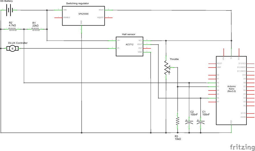

Hi there,
As I said, I want to replicate folken's work. Even if I understand the whole picture, I'd like a quick validation of the wiring before I go further.
Notes :
- 3 phase motor and dlux controller are not accurately drawn. I just put a DC motor and no controller on the diagram. I understood I have to wire the 5v, gnd and d3 pwm to the controler.
- screen connection is not drawn
And what I have done so far (not so far :F) :
- connector to hall sensor soldering
- voltage divider soldering
Any advice appreciated !

Masure wrote:Hi there,
Looks correct so far. I'm not 100% sure if the code will work without the LCD connected though.

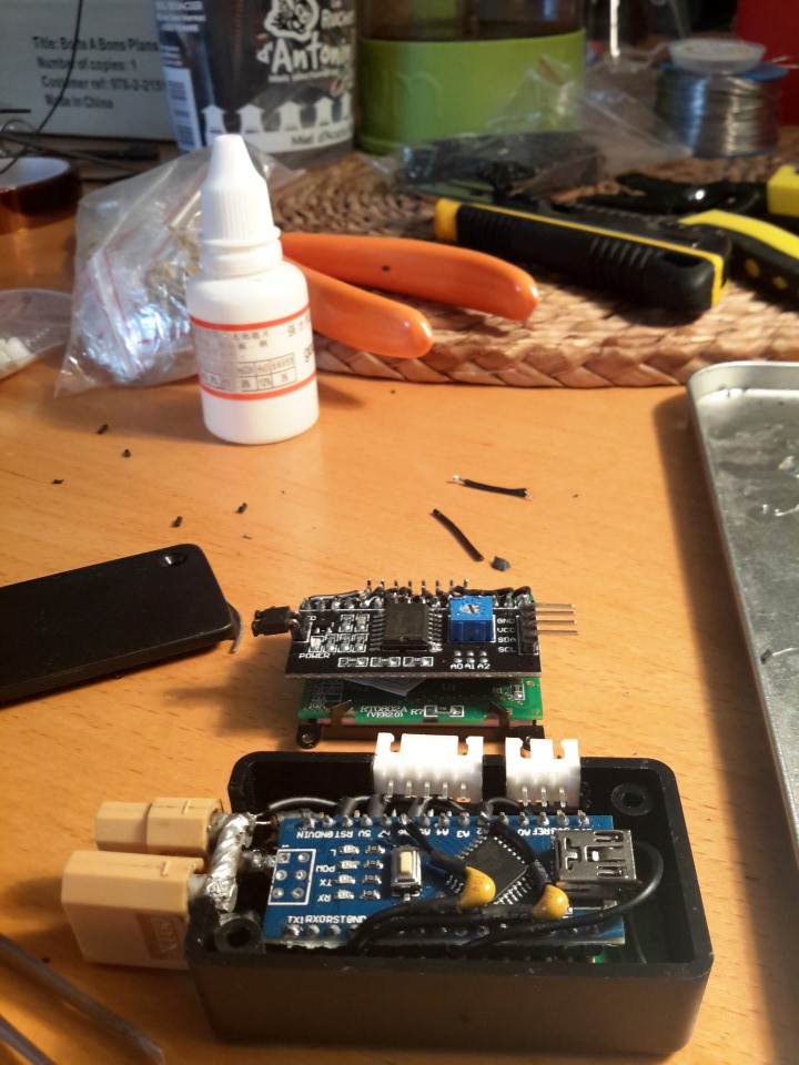

Hi Folken,
I did some work on your circuit and here is what I have :
Soldered all the I2C interface pins to the screen in a compact block. Not so easy !
Soldered all the arduino circuit. Not easier !
The small DC DC switching convertor fits very well in the box. I recommend it.
I tested and adjusted battery voltage read from your program and that's all for now.
I have not tested current reading from the hall sensor because I have nothing to test with. I'd prefer not to check directly with motor + controler until I'm not very confident with your code.
