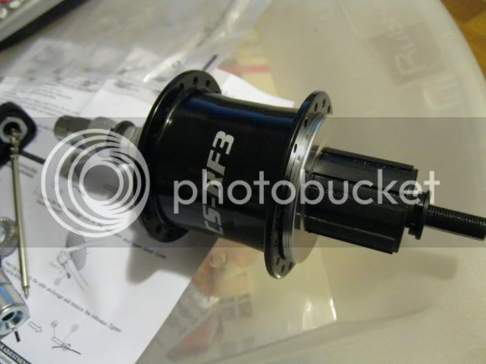

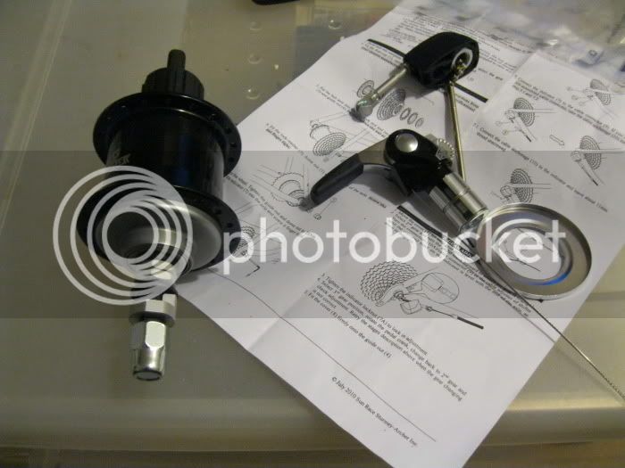

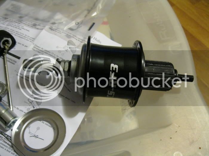

I just received my new Sturmey Archer hub and bar-end shifter thanks to StudEbiker. I tell ya, the folks on this forum really are the best. StudEbiker, Luke and others have really gone above and beyond to help me with my ebike, even at a cost and inconvenience to themselves! You guys are the best lot ever!
This hub is quite beefy and just from eye-balling it, looks pretty well-crafted. Roughly the same weight as the SRAM Dual Drive hub at the bike shop. The only thing this lacks that the SRAM has is a rubber boot on the non-cassette side. Not bad considering this was just about half the price of the SRAM DD. If this is anything like Sturmey Archer's S3X 3-speed fixed gear hub, it'll be damn near bulletproof. I hope to have this thing laced up soon and when I do, I'll post some new pics.
