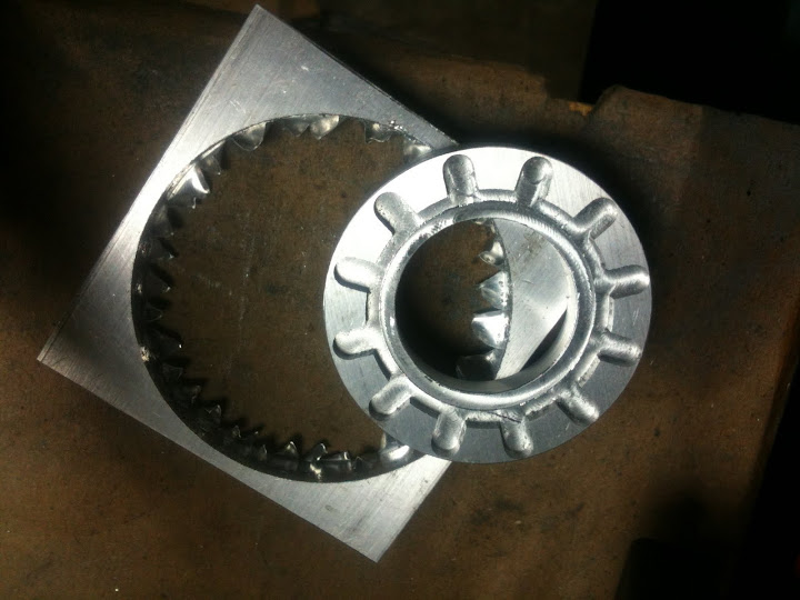

I'm considering designing/producing a left-side freewheel adapter for the NuVinci N360. The intent would be to reduce noise and drag for designs like my folding Dahon Jetstream and the soon-to-be powered 2009 Norco A-Line
The idea is to replace the disc brake mount with a machined 6061 adapter that mates to a CSK35 sprag clutch. Here is the left side of the NuVinci with the disc adapter:
Here's a slightly better view - the disc brake adapter sticks out about 14mm
The disc brake adapter is a module - it can be removed by way of a spanner that mates with the 8 tiny holes you see surrounding the disc brake hole pattern, then a different adapter (e.g., a roller brake adapter) can be fitted. Removed, the disc brake adapter looks like this:
My plan would be to create the left side freewheel adapter, which one would install as a replacement to the existing brake adapter. It would mate - press fit - with the inside diameter of a CSK35 (or better, a CSK35pp) sprag clutch. I would have to also produce a part that mates with the outside of the sprag clutch, providing mount bolt holes for an off the shelf chainring (I'm thinking 110mm BCD).
Initial estimates show I can produce both parts at a decent cost - about $80 for the pair - as long as I buy at least 12. I'd be "buying" 2 of these, leaving 10 for sale to interested parties. Note, the "outer" part can easily have standard disc brake mount bolts drilled in it... their horizontal placement will be a bit off due to the width of the sprag clutch and mounting bracket, but nothing a few washers around the axle can't fix.

I've been looking at this side project again. Here are a few things I've realized:
1. Somewhere above I talk about bolting a disc brake to the "outer" piece. This would of course be completely worthless, as that outer piece freewheels! :oops: So if I'm to have any possibility of being disc brake friendly at all, I need to have mounts on the "inner" piece.
2. If I use a CSK-40 (http://www.vxb.com/page/bearings/PROD/Kit12575), I get 260nm of torque handling, and a 40mm inner diameter to work with. The width is a rather large 22mm - right at the edge of the envelope I have to work in (pictured above - the existing disc brake adapter and "dome" together combine to 22mm wide). This keeps the dropout width correct, but makes disc brake mounting a challenge.
3. I can use one of these (http://www.vxb.com/page/bearings/PROD/Thrust/Kit8670) to functionally replace the dome (see above post). This can be countersunk into the "inner" piece.
I went ahead and purchased the CSK40pp sprag clutch and a couple of the axial bearings I linked to in the last post. With the help of 900Steve, I'll be building a one-off implementation of this left side freewheel system and mounting it to the MENSTRUAL Cycle to road test the system. Nothing like building something then throwing a few kilowatts of power at it to see how it holds up!

I'm able to move this project forward with the help of 900Steve. He's got the skills and the tools to machine stuff.
Here are a couple quick photos of a test piece he did. It's a test run of the bottom profile - and fits really nicely!

I wouldn't worry about the drag torque of the CSK40. You'll find freewheels which are better and worse than it. At 250rpm it's only going to take 2 or 3 watts........ It's quite heavy compared to a freewheel, though....but given the weight of the NuVinci... :)
