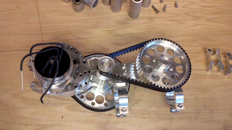

Matt also makes this gorgeous two stage drive (three stage if you count the chain to bottom bracket). Having a tiny drive sprocket for more reduction is better than a tiny drive pully. At least the chain will stay engaged and not skip. The best solution is an additional reduction stage so you're not running either tiny drive pulleys or huge driven pulleys to get the reduction you want. This matters even more with a 10,000 rpm RC motor.
Matt's double primary belt drive is the way to go if you have the room to install it. His pricing is very reasonable for what you get. Notice the 20mm wide belt with no idler tensioners. Good enough for eleven horsepower or more which an insane amount of power on a bicycle.

rp3 wrote: I can see the belt is not going to last long at all, it's already fraying at the edges. Hopefully my LightningRods kit will help that when it comes.
RP3- The adjustable sheets will help. Another major problem is that small drive pulley on the motor with razor sharp edges on it. It is constantly shaving away at the teeth of the belt. If you can take a Dremel tool or even some emery cloth and work on those sharp edges on the pulley teeth that will help stop the belt from fraying. These rubber drive belts can work great, they just have to be set up properly. A properly designed belt drive needs less maintenance than a chain drive.
I'm trying to put together an affordable pulley solution. SpinningMagnets is also scouring the internet for a replacement pulley. I've created a 3D model of a pulley with proper teeth on it. If I can't find an existing pulley I'll have this made.

I may have found a viable motor pulley for UK customers. HTD 5mm-pitch, 25mm wide, pilot-bored so buyer must have it drilled to final bore diameter. 12T, 14T, 16T...roughly $15 (GBP 10) plus tax and shipping.
Be aware this part does not appear to have a keyway, or a roll-pin through-hole, or a threaded grub-screw hole (I have seen grub-screw holes in the valley of one of the teeth in the middle of the pulley, if you wish to trim off the shank-stub).
Ebay listing from seller cnc-parts4u
http://www.ebay.com/itm/HTD-5mm-Pitch-T ... 791a00f4da
ES member patrick.reavis showed how he used an aluminum shaft-clamp as a bearing mount for his boxed chain-reduction. It might be possible to use one of these bonded to the side of a motor-pulley to attach the pulley to a shaft...as an option.
