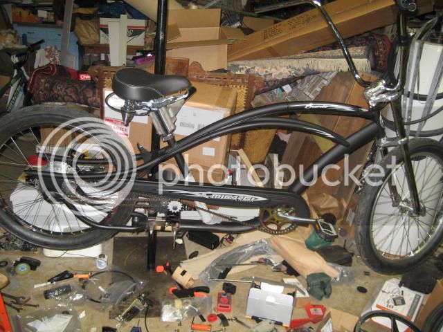

I have an Amped Bikes Tube battery to test on it, and other than a better place to have it for better aesthetics, It's just a matter of working out the chain tension rollers (going to use two tandem bike guides that are fixed, with the drop-outs being used to maintain motor chain tension) and it should be up and running in a week or so!
wineboyrider said:
Is that the same motor you used on your recumbent :D :?:
Yes it is. :)
It will be used with 36V Lipo however, and with a battery like Amped Bike's Tube battery, I think it will perform quite nicely.
In previous tests it was just as efficient at 36V as it was at 48V, so it should bring costs down all around. 8)

Here are some new pics, got the NuVinci installed, had to feed the cable through the pulleys in the rear, really wasn't that hard at all, just have to make sure you take up the slack out of the assembly when locking down the position of the cables.
This one has a close up of the new tensioner that uses gravity to keep tension on the pedal chain much like an old school tandems (excuse the ugly welds, the HF TIG just isn't the same, and I was welding literally in the dark at my neighbors)
If all goes well, controller and battery should be installed this week-end! :D

Can you post a close up picture of how you got two chain rings on the nuvinvi hub.
I always thought it would be better to have the motor drive the back wheel, though the gears, without first having to gear down to pedal rpms, only to gear back up to the back wheel.
Sure, let me get a pic for ya *brb*
The large cog in the rear is the motor driven, the hub it's self freewheels, so only a separate freewheel is added for the pedals so you can coast while the motor turns the wheel.
Here you see the inboard chain going to the small cog on the motor, and the white primer cog is just a tensioner for the pedal chain.
Closer pic of the motor side of the drive.
Hope this helps!
