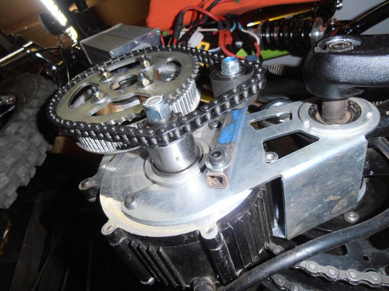

Many of us are invested in the GNG 450 watt, brushless mid drive kit. Most of us believe mid drive is the future of eBikes. This low cost kit has created quite a stir and proves that a low cost mid drive is possible. However, one common complaint is the Primary belt drive. My own stock kit shows significant belt wear after only 170 miles of use. Overvolting has resulted in belt failures occurring in minutes. I've found many of you have made chain drive modifications with some success and would ask that you share your experiences here. Please include photos.
What method did you use for removing the pulleys?
What sprocket combination did you use?
What size chain did you use (and why), proven quiet and reliable?
What was your solution for the idler?

Denisesewa, #25 chain, 65T/12T from TNC-Scooters
http://endless-sphere.com/forums/viewto ... 95#p674897

Thanks heaps, spinningmagnets! So far, I like the looks of the 65-12 with a #25 chain. Someone had a great idea on an idler that was mounted to the motor face plate, adjustment was with rotational slots. Do you remember where that was? I like the idlers that give the most drive tooth engagement. While the #25 chain link spacing looks good, that 12 tooth drive sprocket needs all the engagement it can get. If you happen to find the revolving adjustable idler someone came up with, please post it here, looks promising. Thanks again.

From "richard purchon", I felt it was a clever solution. Since the holding bolts are inside slots, the rotating base-ring could still have a spring attached to it if you wanted.
http://endless-sphere.com/forums/viewto ... 55#p677505

I like this idler for the chain drive. I'm thinking It would need to be adjusted pretty tightly, a spring load would have to be hefty, don't you think?

Denisesewa wrote:Thread on how I did my primary conversion >> http://endless-sphere.com/forums/viewto ... 19#p686519
When you trimmed off the outer edge of the large pulley, what method did you use?

I used an angle grinder with a cutoff disc and then did a little draw filing.

If you want to replace the small pulley to remove the sharpness of the stock teeth, lets find out what the available options are (belt/pulley widths, tooth counts, shaft diameters).
edit: Matt (recumpense) uses 20mm and 25mm wide belts.
Personally, I hope the stock setup works fine once the tension is correct. For sure that is the biggest problem. If I have to go to different sprockets I think I'll go wider if not larger diameter on the 14T drive sprocket. At about 6:1 every tooth on the drive requires 6 on the driven just to keep the reduction the same. I'd rather gear the reduction down a bit with 14T. Maybe 20mm wide with 14T/80T.
Matt's drives are awesome. Once I figure out what I'm doing with all of this e-tech I'll buy one of his DaVinci drives just for the mechanical beauty of it. For now the GNG is my poor man's DaVinci with Astro 3220.
