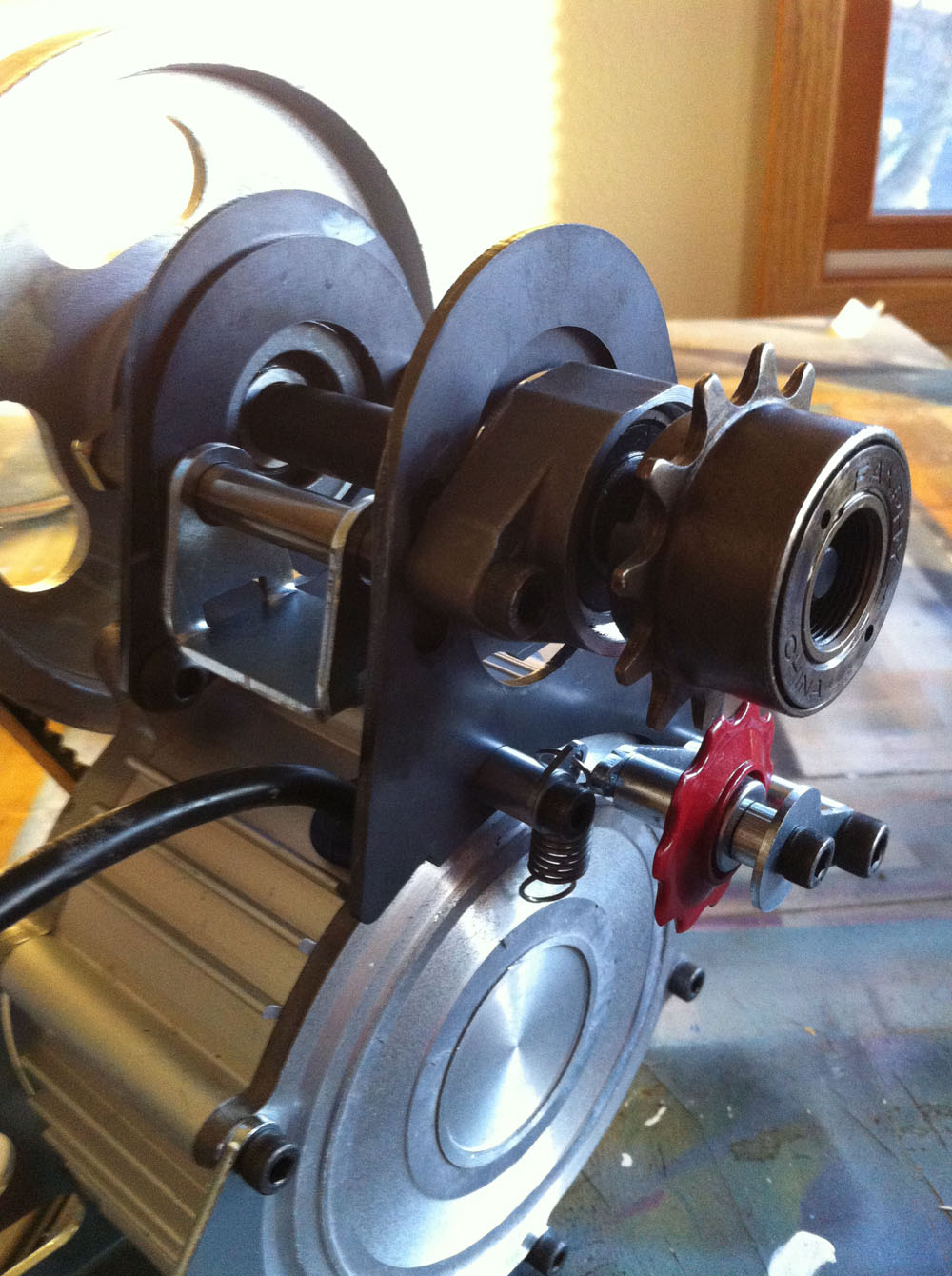

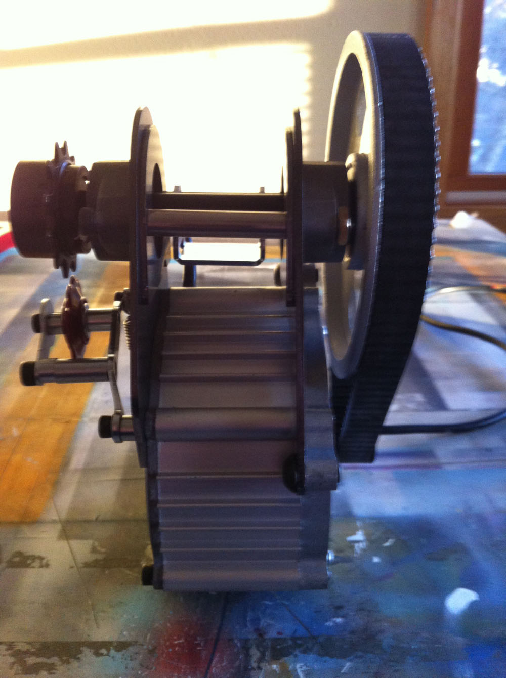

Location: Canon City CO.
Re: GNG 450 brushless Mid Drive - Primary Drive Modification
Post by Denisesewa » Jan 11 2013 1:54pm
Cyclebutt wrote:
Denisesewa wrote:Thread on how I did my primary conversion >> http://endless-sphere.com/forums/viewto ... 19#p686519
When you trimmed off the outer edge of the large pulley, what method did you use?
I used an angle grinder with a cutoff disc and then did a little draw filing.

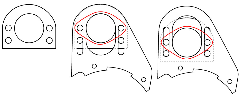

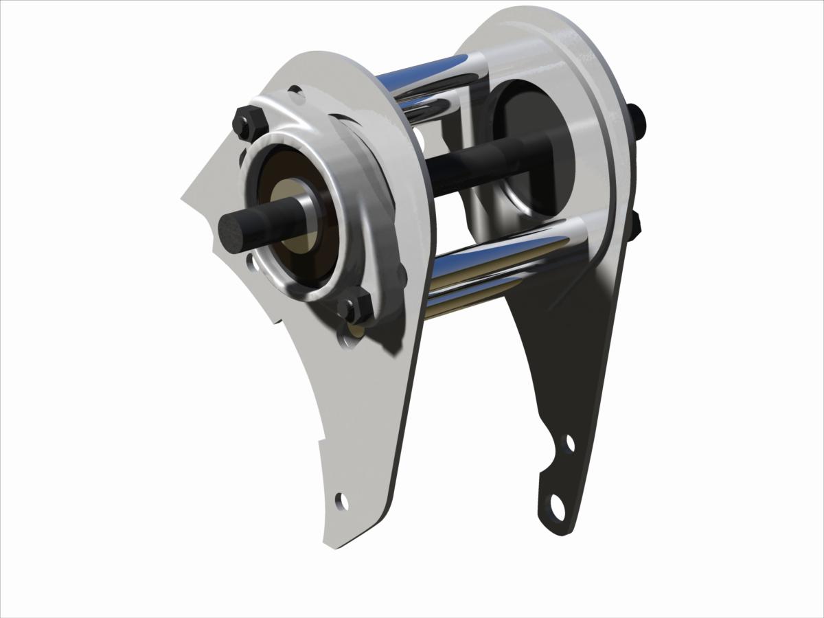

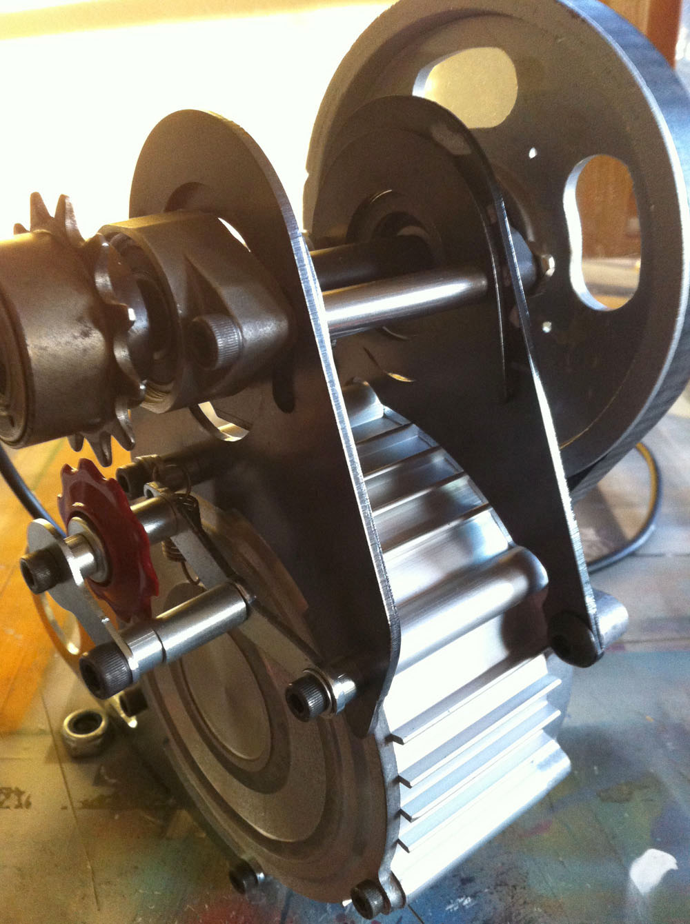

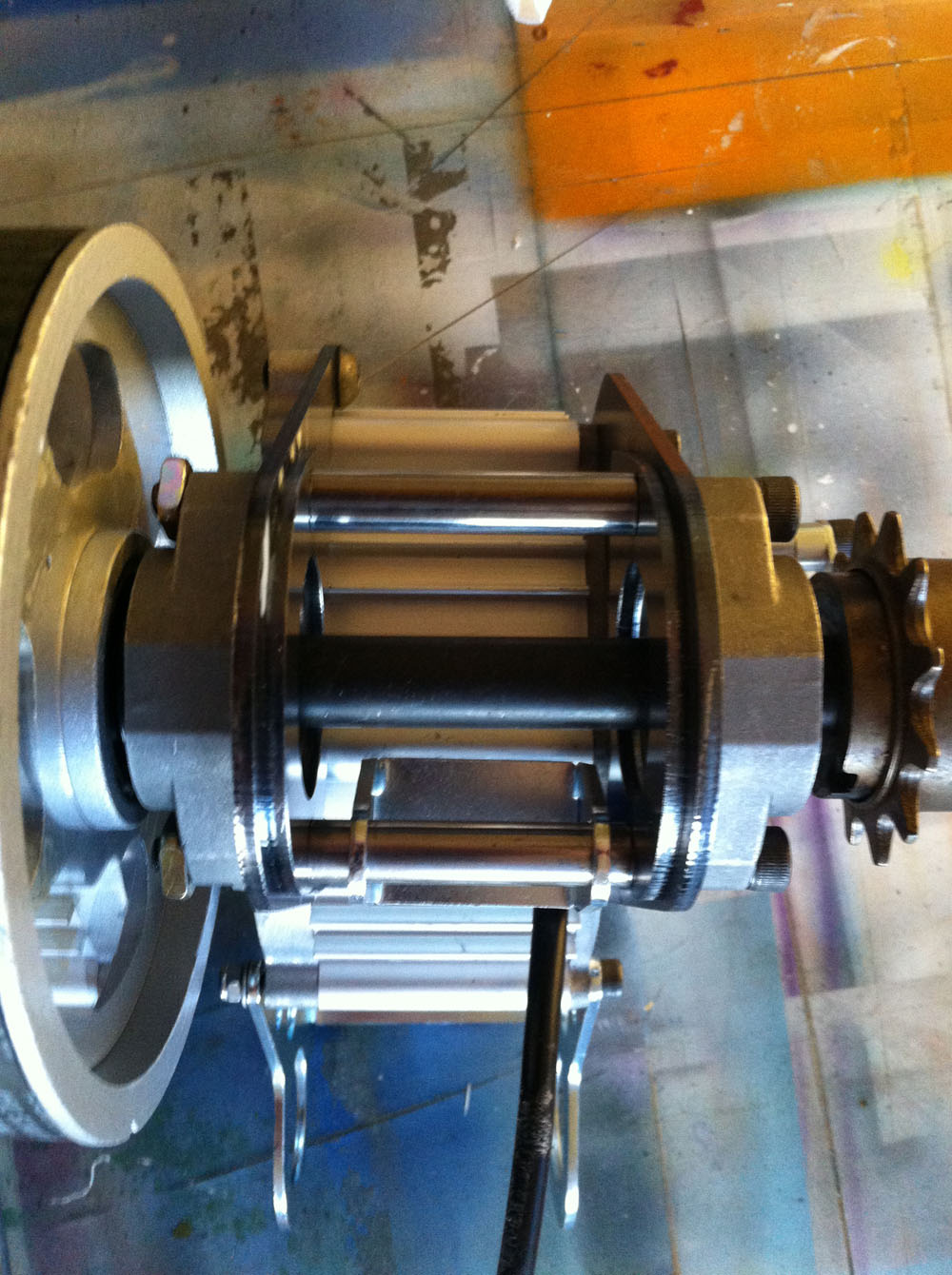

I've been heading off in a somewhat different direction than the rest of the group. Having seen Matt Schumacher's gorgeous CNC drives running 6kW AstroFlight motors through belt drives, I want to try to hold on to the quiet, clean and supposedly low maintenance carbon belt drive. I read through the Gates Industries handbook on the care and feeding of these belts, and found that GNG had violated most of the "DO NOT" rules in the book. Most importantly GNG had not provided a proper way to tension the belt. Not only does the stock tensioner not provide enough tension, it bends the belt in a way it was not designed to bend. I decided to design a proper slide tensioner that would give the belt a chance to work properly.
My original design concept drawing:
A 3D model rendering to help me visualize how it would all go together:
And here is how the finished product came back from the laser cutter:
As it turns out there are other benefits to my design. With 3/4" longer sheets it's now possible to fit larger pulleys or sprockets to get more primary reduction and allow a better pedaling cadence. For the people who have already converted their drive over to chain you can also tension your chain with the sheets and toss the noisy and power robbing tensioner. I've seen some clever idler tensioner designs here, but I still believe that the best tensioner is no tensioner.
I'm currently selling these sheets to the E-S Forum at cost, $20 US. This includes a new section of 3/8" steel tube to cut for your narrower spacers (the added inside sheets shorten the spacers by about .2"). On Monday Jan 14th I'm placing an order with the laser cutter. If you want a set, this is a good time. PM me and I'll add you to the list.

There are several benefits to this upgraded bracket. The stock bracket is made from .098-inch (2.5mm) low-grade steel, and the new ones here are .104-inch (12-Ga), and made from a better steel. It may not sound like much, but you can't beat the improvement at this price, especially adding the benefits listed above...

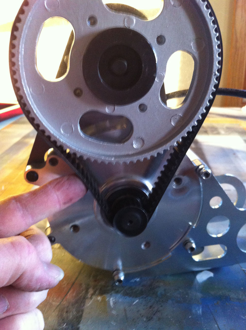

I'm going to start out trying to keep the belt drive. I'll admit in advance that I may not be able to. The stock pulley is too small in diameter and possibly too narrow at 15mm. I think it may work fine at 1 kW which is where I'm going to start out. There is another issue with the stock drive pulley, and I don't know that I've ever seen this mentioned on E-S. The way that it is machined creates a sharp edge on the cog profile. If you compare the GNG sprocket to a more typical profile you can see that the way it was machined creates a sharp cutting edge (red arrow).
I think this may be a big factor in premature belt wear on the standard drive.
So to sum up the primary belt drive on the stock GNG:
No provision for proper tensioning
Provided tensioner bends belt backwards damaging carbon support layer
Drive sprocket too small a diameter
Drive sprocket has atypical profile with sharp edges
Driven sprocket has excessive runout causing belt tension to fluctuate
Mild steel sheets may be bent in transit causing improper alignment of belt
Entire belt system may be too narrow (15mm vs. 20mm)
If I continue to have belt problems after correcting for belt tension I'm going to start solving for the other issues. If it still doesn't work I'll admit that carbon belts suck and joing the rest of the gang with a chain primary.

Stock GNG belt is HTD-5mm pitch, 15mm wide and 475mm long with 95 teeth. Pulleys are 80T-14T (ratio 5.7:1).
I am of the opinion that at the stock power level, the 14T drive pulley is an acceptable diameter, especially with runout removed from the large pulley and the new side-plates allowing proper belt tension. If someone were to go to the extra expense of a larger than 80T pulley to allow a better reduction, it couldn't hurt to buy a slightly wider belt/pulley set to improve the drive a little more.
If you want to replace the small pulley to remove the sharpness of the stock teeth, lets find out what the available options are (belt/pulley widths, tooth counts, shaft diameters).

The order for the first beta production run of adjustable sheets is at the CNC shop. I stuck my neck out and ordered 10 sets for the Forum to get a better price. Thanks to your support I sold all of those and had to order more. In addition to the sharing of valuable knowledge and experience this is another great thing about E-S. We can go in together and have custom parts made at prices that start to become reasonable. I'll be contacting everyone who placed an order to wrap up billing and shipping. Everything will go out this week.
If you've found this post late, as often happens, and want a set of adjustable plates for your Gen 1 GNG send me a PM and I'll see what I can do. The initial run is sold out as of 1/14/13.

Post by Cyclebutt » Jan 18 2013 12:04pm
[img]
Belt fraying after 170 miles
100_2034 (2).jpg (90.85 KiB) Viewed 1999 times
[/img]Here's another photo of the stock belt configuration after 170 miles. Only around 30 of these miles were trail. Can you see the edge fraying?
I'm going with adjustable sheets for now.
1) During installation I will rotate the motor power lead to a more "protected" clock position.
2) Run shorter belt with sheets in most closed position. Anyone have that part number? I'll look for it. test it..
a) In case belt's too short for easy installation, go back to original belt. test it...
3) Find a screw type idler for this configuration. It is my belief that a spring loaded idler is not appropriate for this type of belt, also not designed for serpentine use, other members have confirmed this. A spring type idler allows jerking motion which (IMHO) leads to premature belt failure. A screw type idler would allow enough slack in the belt line for easy belt change in the field, would allow perfect "FIXED" tension adjustment as well. test it...
I'm fairly confident these mods will at least quadruple the belt life. If it'll go three thousand miles, I'm satisfied. If not, I'll go with the chain mod. Adjustable sheets will still allow easier adjustment for chain drive choices. Besides, if I have to turn down (machine off) the drive pulley, a drive "sprocket" will replace it, I'll be finished with the attempted salvaging of the stock primary drive.
This bike is being built as a commuter with occasional off-road capability. Sort of a KLR (Kawasaki motorcyce) of bicycles.
So this is my "IF-THEN" plan. Anyone remember the part number for the shorter belt and any suggestions for a screw-type adjustable idler that will slap right on, without (or very little) modification?

[quote="Cyclebutt"][img]
I know that the people who tried the short belt said it was an extreemly tight fit and at least one was damaged trying to install it, you may be able to deepen the slots in the adjustable plates to allow ease of installation. I know the part # is in this thread somewhere but couldnt find it right away. I also think the hard edges of the pully teeth need to at least be smoothed over, I am trying to think of a way to make a tool to do this.

Denisesewa wrote:
Cyclebutt wrote:[img]
Thanks, Denisesewa. I just couldn't find the details on the short belt results. I'll skip that part now, for sure. Any suggestions for a screw (bolt) adjustable idler for belt drive? I'm positive that a constant tension idler would deliver better belt performance/life than the spring loaded type. By the way, hows the chain drive doing? You and a couple of other member have great looking, working chain drives. Bike on!

So far the chain drive is holding up very well even with the cheap chinese chain, I found a soure for Diamond chain that I think I'll replace it with.
I'm thinking there would be no need for an idler if using the adjustable sheets, I suppose if you really want one you could do something like I did for the chaindrive system and use a turnbuckle instead of the spring.
Denisesewa   100 W
Posts: 288
Joined: Dec 19 2007 10:01pm
Post by Denisesewa » Jan 19 2013 11:25am
BTW, the big reason for going to chain for me is that unless the two belt pullys are perfectly aligned and absolutely perpedicular to each other ( this includes any idlers) the belt will "walk" to one side or the other and wear along its edges, there also has to be zero runout to use a static tension system or the belt will experience various tensions as it spins, that along with the poor tooth profile of the stock pullies leads me to believe its a ton more work to get it right than the chain mod as the chain will torerate some runout.
