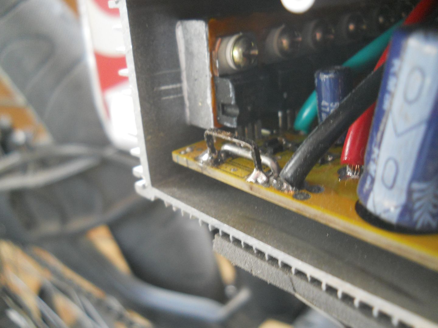

This is a "do at your own risk" controller mod that has worked well for me although I am told that you may change or over ride the Low voltage cutoff ,since I am overvolting the controller at 14s lipo the LVC doesnt matter and I use a turnigy watt meter to monitor battery voltage.
I use a T-50 staple, sand the legs and pre tin with solder, pull the non wired end off the controller and you will see the shunt with an extra shunt slot outboard, its best to enlarge the holes to allow the staple legs to slightly pass through then solder the staple in place, I place shrink wrap over the staple for added protection. this increases the amps from 22 to about 27 and provides a noticable increase in torque, there are other methods of acomplishing this but this is what I have fisrt hand experience with.

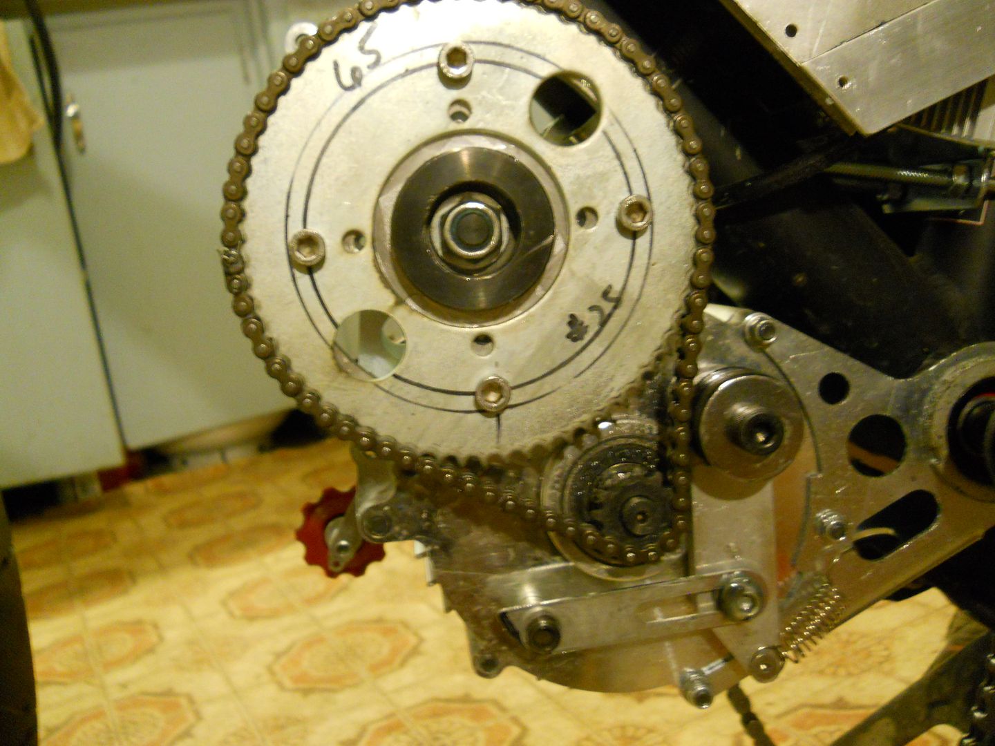

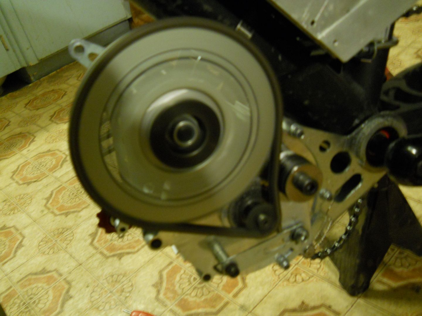

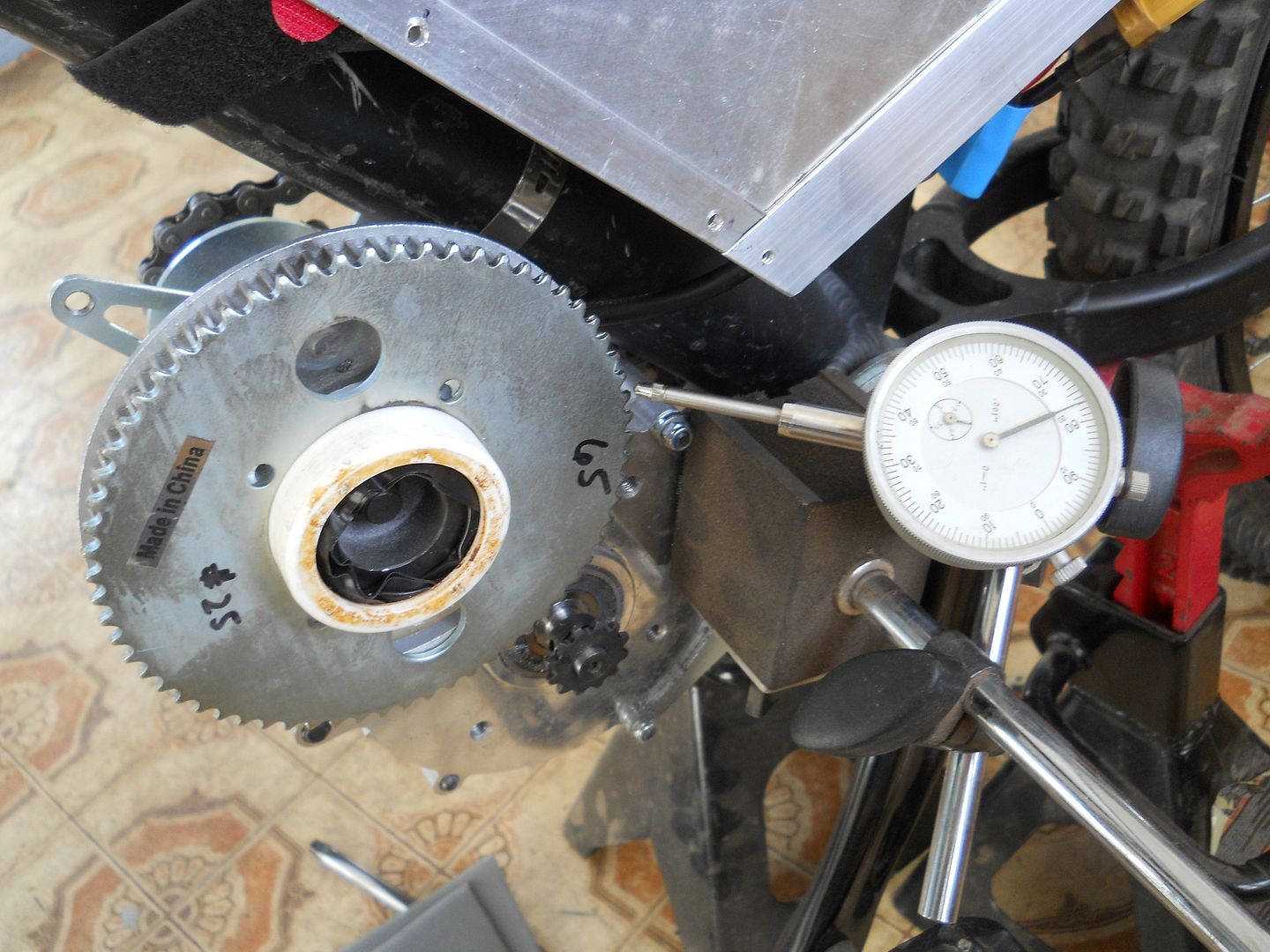

This is how I did my primary chain conversion using these parts >>the parts are from TNCscooters.com , # spk-103240 for the 65 tooth , #spk-106012 for the drive sprocket , and 2 ft of # chn-105250 chain , you will have to find another supplier for a #25 halflink , I used the original large belt pulley and trimmed the outer edge off , I then made a bushing to help center the sprocket on the pulley and kept adjust it untill I had virtualy no runout,
once I was satisfied I hotmelt glued the sprocket to the pully to keep it in place and then drilled and bolted the sprocket on,
I remover the outer " washer" from the motor drive pulley simply by bending it off with pliers and used a new file with the motor turning at a relativly slow speed to turn down the pulley to 10mm, by going slow and checking my work often I ended up with a nice snug fit for the new sprocket and again zero runout, as the shaft gets smaller material is removed very fast so check often. this took less than two hours of careful work.
CLICK ON THE IMAGES FOR VIDEO
The drive sprocket had to be tapped for set screws and two flats were filed on the shaft for the setscrews to bite against once I had correct chain alignment. To have minimal slack in the chain I used a half link instead of a master link.
The result is a smooth running primary drive.
the tensioner was made from an old dirt bike chain roller cut down ,the spring from the original secondary drive tensioner which isnt needed there and scraps of aluminum.
So far under hard use this has held up perfectly and is almost as quiet as the belt with the added bonus of eliminating the huge power consumption of the belt system, with " Lighningrod's adjustable sheets I hoping to do away with the tensioner and save even more power from being wasted.

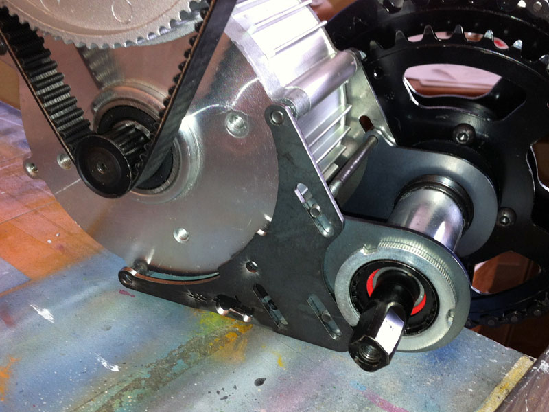

ES member LightningRods has designed (and begun having a professional shop make) a new mounting bracket set for the GNG kit. The two main benefits are that: the the belt and chain idlers are removed from the system. This streamlines the drive and also removes the significant 100W drag of the stock belt idler. The second benefit is that new mount is much stronger. The metal is only slightly thicker, but is also made from a higher quality of steel.
The upper set is a big improvement, and it allows the jackshaft to be moved for adjusting the belt tension, rather than use the stock idler wheel.
https://endless-sphere.com/forums/member ... le&u=30024
http://www.backusstudio.com/gng/
https://endless-sphere.com/forums/viewto ... 20#p686660
The lower set is also stronger than the stock mount, and allows the chain idler to be omitted. If you do not want both sets right away, the outer set is the most important to upgrade, whether you keep the belt or convert to a chain primary.
https://endless-sphere.com/forums/viewto ... 10#p703359

Mod 5. Shunt mod. As per Denisesewa's first post, I opened up the front of the controller. With the bike lifted applied full throttle and applied the rear brake, watching the watt meter for maximum amp draw. Peaked around 22A as stock. I then added solder to the existing shunt (melted it on with a soldering iron) a little at a time until it would pull 32A with the same braked experiment.
Maximum output I'm seeing now is over 1500W. Hopefully the controller and battery BMS will cope or they'll be next on the upgrade path.

Denisesewa wrote:This is how I did my primary chain conversion using these parts >>the parts are from TNCscooters.com , # spk-103240 for the 65 tooth , #spk-106012 for the drive sprocket , and 2 ft of # chn-105250 chain , you will have to find another supplier for a #25 halflink , I used the original large belt pulley and trimmed the outer edge off , I then made a bushing to help center the sprocket on the pulley and kept adjust it untill I had virtualy no runout,
How is the pedal cadence on this setup? Is the ratio close to stock?
Power is a fascinating thing, the more you have, the more you want, but the real power is having the restraint not to use it all at once...............Um...Yeah..
The harder you work.....The luckier you get!!

Post by Denisesewa » Nov 10, 2013 8:05 pm
Its actually a bit lower than stock , my bikes are used almost exclusivly for off road with alot of slow speed technical climbing , the lower geared primary keeps the motor RPM in a happy place without going to extreme final drive gearing. I do peddle now and then but only when I need to help the motor from lugging to get over something ( lugging creates heat and is inefficient)
Anyway, it works for me, others have done this same mod , perhaps they will add their experiences.

Post by spinningmagnets » Jan 02, 2014 9:18 pm
ES member Meister showing how he modded the brackets to fit the GNG kit to an 83mm wide BB-crankset:
https://endless-sphere.com/forums/vi ... 28&t=56220
