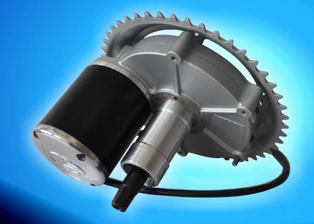

Post by d8veh » Mar 13 2013 4:28pm
This photo turned up on our UK forum today. This motor is now being fitted to ready-made electric bikes that cost from about £700. It's rated at 250w and anecdotally stronger than a Bosch mid-drive. Looking at the photo, it might be possible to fit it to any bike. It's made by a Chinese company called TCM. I searched, but couldn't find anything about it. Can anybody add to this?
[Moderator edit to add product name to title, also add recent pic to show major internal arrangement, 26:1 single reduction]

Post by bandaro » Mar 14 2013 6:11am
Product Specifications
Voltage : 36vDesign : BrushlessWattage : 201 - 300w
Parameters
1.Driver Unit
Rated Voltage: 36V
Rated Power: 180~250W
Max Speed: 90r/min
Peak Torque: 60N•m
Noise:≤50dB
Temperature: -25℃~50℃
Weight:≤4.5kg
Water Proof Grade: IP54
Standard: EN15194-2009、ROHS
Range: 40km(with only power and 36V/9Ah lithium battery)
Climbing Angle: 6º
2.Electric Control System
Driver: DC brushless controller
Assistance Meter: LCD/LED
Speed Sensor: One Signal
Assistance Sensor: Inside
Assistance Control Mode: Speed Control, Power Control, Proportional Control
Best I could find, seems like a very simple low power drive, will be interesting to see if there is room on the market for it.

Post by deffx » Aug 15 2013 7:49am
I emailed them and enquired if this can be installed on a normal 68mm bottom bracket, the reply was
"For Middle Motor, it can not installed on a normal bottom bracket. Before in china has a company can do it, but find a lot of problem, so they give up it. So no one can do the Middle Motor installed on a normal BB so far.
Our Middle Motor can installed on the BB which Inner Diameter is 38mm, External Diameter is 47mm, Length is 61mm."
Bit stupid of them really, Bafang/8fun bbs01 is similar and fits a standard bike, they missed out on a potental market

Post by speedmd » Aug 15 2013 3:54pm
motor behind the seatpost
Most likely to eliminate the need to to clamp it in place. No other reason I can see to keep it from going in front.

Post by speedmd » Aug 18 2013 7:56pm
One of the links has it as fitting into standard english 68mm -72mm bb shells. Should be widely adaptable as it does not look to rely on shell treads.
