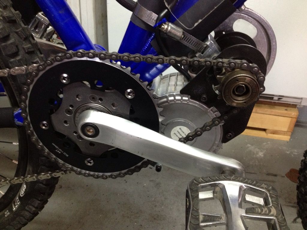

I finally had some time to myself and installed the GNG bracket kit from Lightingrods. Sprayed some hammered paint and came out bitchin'.
I installed the Bikemotive 130BCD and 110BCD crankset spiders for more clearance. I had to use my impact driver just to get the old 16T freewheel off the crankarm. I replaced the 38T chainring for a 39T.
I updated my rearshock to Manitou Evolver ISX-1 2008. Got it for cheap and was brandnew. Took the fork off my second EVG bike and stuck it on the Fuji.
Still need to clean it up a bit, needs a battery harness made, a shield and should be ready for the trails.
So with the stock GNG crank arms, I purchased:
http://bikemotive.myshopify.com/products/custom-acs-crossfire-flanged-freewheel
http://bikemotive.myshopify.com/pro...0bcd-spider-for-freewheel-crankset-bikemotive
http://bikemotive.myshopify.com/products/custom-130bcd-spider-for-freewheel-crankset-bikemotive
I bought the mounting screws and bolts at Ace Warehouse. M5x.8 screws with corresponding bolts and washers.
I purchased 1mm freewheels spacers from Amazon. These go between the crank arm and freewheel.
To mount the chainrings, I ordered two sets of Origin8 double chainring bolts. I also needed Origin8 Chainring Spacers 0.6mm, which is a bag of 20.

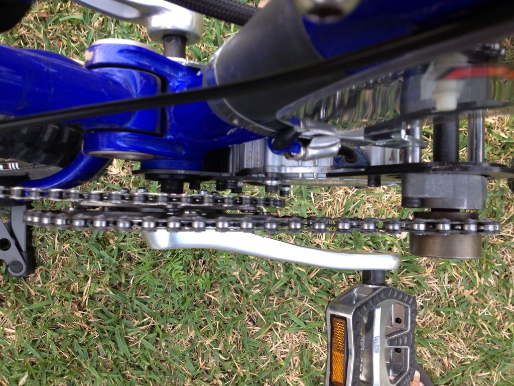

So I went for a few short rides and busted up the belt after a few adjustments. Looks like I will still the chain tensioner. Ordered me a new belt and should be here by Wednesday.

So I just finished with the bike again. I swapped in an old belt with the original tensioner. I also used the chain tensioner as well. This time I'm using a 46T chainring on the secondary. GPS said 32MPH on 14s1p lipo, with those offroad tires.
The belt did not fail once and I was having a blast. Looks like I'll buy a longer belt with a bigger belt cog. I will also up the phase current a bit.

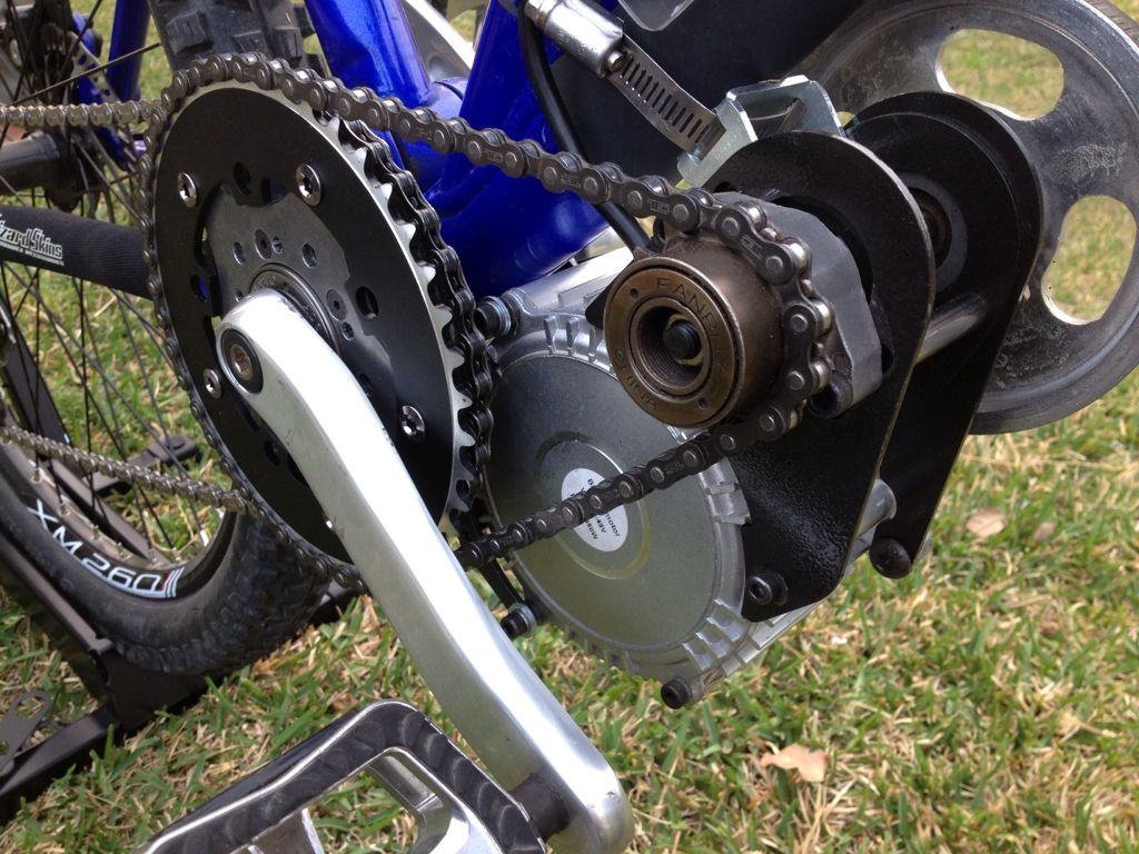

t0me said:
Hiya, so you couldn't get the belt and chain to work reliably without the idlers?
Isn't that the point of the new brackets?
The brackets let me install bigger chain rings and belt cogs. But since not everything is perfectly cut in a circle the idler are still need for me.
I had bend the bottom bracket part under power, but bend it back. Added small piece of steel onto the frame for the top assembly. Looks a lot stiffer now. I went from 475 to 500 length belt. My thinking is less tension on the belt, thus less wasted power. With the longer belt the plates are fully extended, both top and bottom. A new KMC Z410 chain has also replaced the old worn secondary chain. Hopefully I'll have some time today or tomorrow to actually run the bike.
Zombies throttle interface is a nice match up with the GNG kit. Much better control on the bumpy single tracks.
dont rely on your belt tensioner using just one bolt into the motor case.
the case looks thick,but its not.its only a couple mm thick it will crack/break out.
