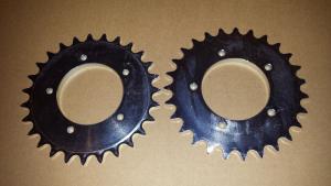

Bargain prices on 9T and 13T motor sprockets for MY1016z motor.
Confirmed compatible with MY1018Z and XYD-16 motors
9T eZip.JPG (31.48 KiB) Viewed 5449 times
< $6 delivered
13T eZip.JPG (41.26 KiB) Viewed 5449 times
< $7 delivered
