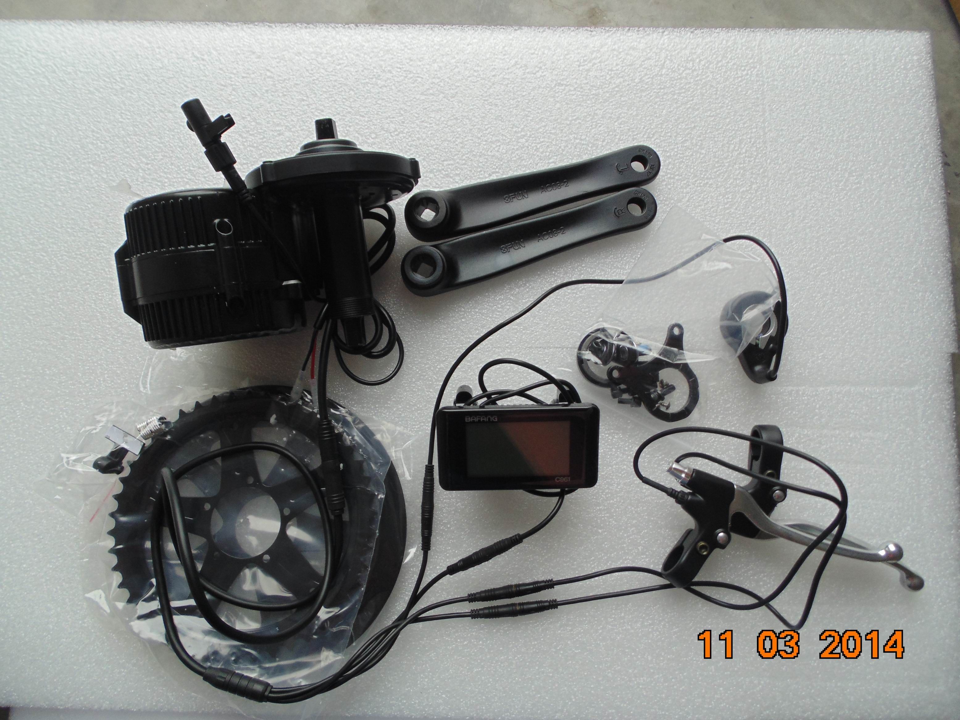

Hey there. Im in the planning stage of building a pack for a bbs02 and have a configuration question for my battery build.
specs 200 sansung 25 r .
will 14s 14 p (51-8v-58.8v) work ok voltage wise?
teslanv   100 MW
Posts: 2675
Joined: Nov 03 2013 8:42pm
Location: Bellevue, WA - USA
Re: New Bafang Crank- DRives
Post by teslanv » Nov 25 2014 10:51pm
14S will work splendidly. And 14 Parallel will give you OVER 100 miles of range.

Wow, that'll be nuts. I'd probably consider using the cardboard tube separators or plastic grid holders to ensure a short doesn't occur. That's a lot of energy between your legs :-p
I'd also be curious how well the controller holds up to the 14S pack voltage long-term. Teslanv has a 14S setup and has run a few hundred miles but I've not heard of someone whose ran long term at that voltage (but I'm still searching). The caps are rated for just 63V so 14S at 58.8V is certainly going to be stressing them. You may want to consider charging to 4.1V (57.4V) to increase longevity of the cells, plus give a touch more margin on the controller components.
That'll be a fun bike :)

58,8v a lot, I will not show correctly on the display. 14s not BMS. Motor at this voltage and maximum load skips performance. When the voltage drops to subside. I also 14s li-poly batteries.

I have been running my bbs02 with a 14s pack of em3ev with no problem for 400 miles charging it at 57.4 v

I also run it on 14s no problems at all. It goes down to 54v under load anyway. So nothing to worry about
