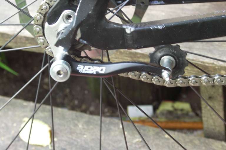

yep, the LMX P1 is very similar, some good ideas I want to adopt.. I already posted this kind of tensioner in your thread. i'm not sure if the tensioner can work like that.. something i'll have to try. If chain growth is to much, i'll need 2 idlers like in a rear derailleur. but that is something i'd like to avoid.
this is a v-brake chain tensioner, nice idea IMO since the torsion spring is already built-in
http://www.mtb-news.de/forum/t/welcher- ... ut.313529/
