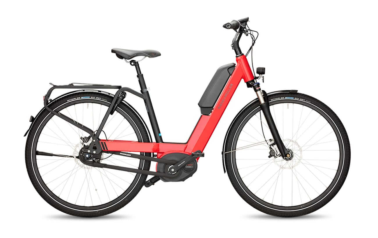

What do you think of Belt drive, is it possible to use with power of 50A?
I cannot stand the chain noise, I have been waiting forever for a silent belt solution. I will buy a bike from you once see this implementation.
Here is Grace RN1 belt solution with 10-15kW
I have seen floating belt drive covers - this is perfect for mud protection

Belt drive is a no go for serious offroad, plus it needs a concentric design or swingarm mounted motor to work. We could implement it on the 81 with the tensioner and freewheel but we only have max 15mm available for a belt, that will be nowhere enough width to reliably transmit 3000w.
On the other hand we can provide a pedal+hub motor version of the 161 now, and cheaper than the regular frame kit as we will not provide the motor, transmission and back wheel.
