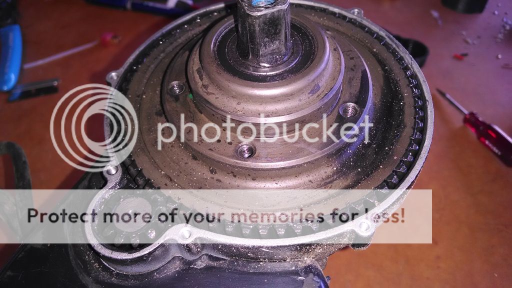

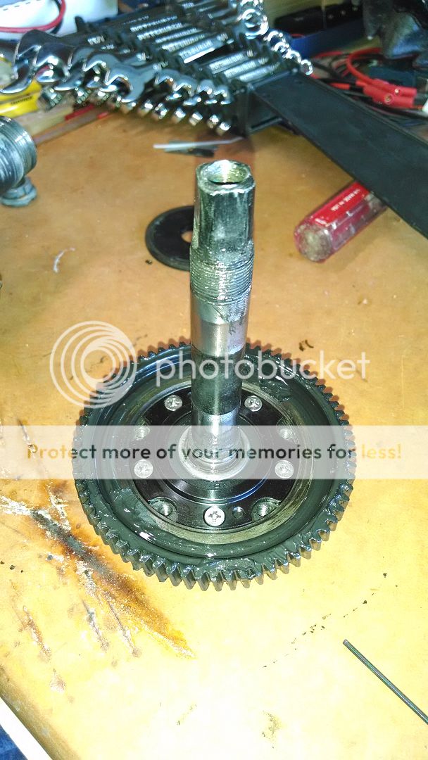

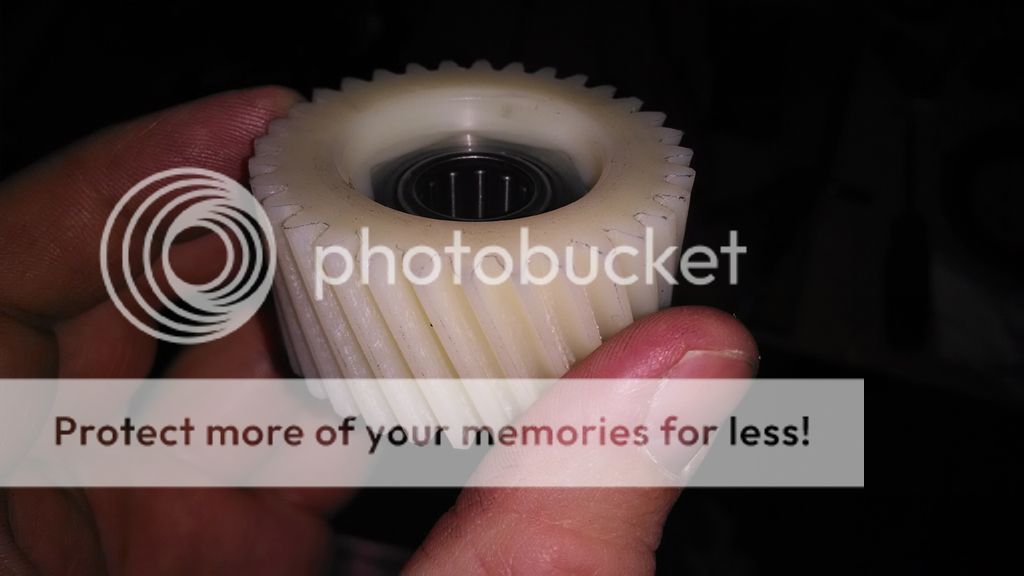

Mine was making that sound also.
Here is my video:
http://youtu.be/KawJFYswEac

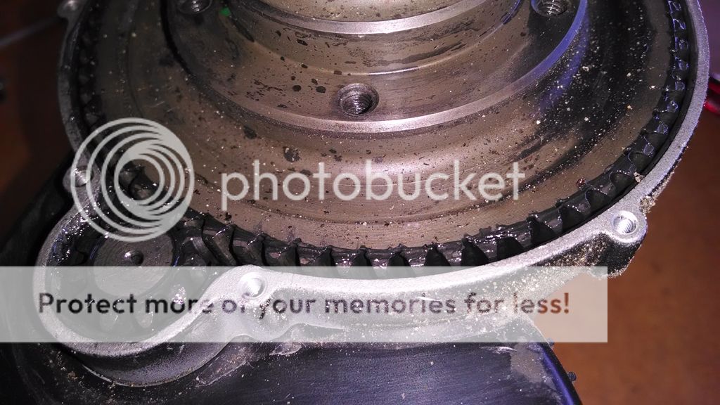

I tore it down, but have not yet found any broken gears. It may have just gotten dirt or debris in the gear housing, so I am in the process of cleaning and regreasing the gears.
The Nylon helical gear had a white grease, which I suspect is a silicone type of grease as opposed to Moly. The final gear had what looks like dark Moly grease. I should be hearing back from lcrewse shortly for guidance on grease type.
Then I will Put it back together and test it out.
Here are pics of my tear-down:
teslanv said:
Mine was making odd sounds also. I tore it down, but have not yet found any broken gears. It may have just gotten dirt or debris in the gear housing, so I am in the process of cleaning and regreasing the gears. I should be hearing back from lcrewse shortly for guidance on grease type. Then I will Put it back together and test it out.

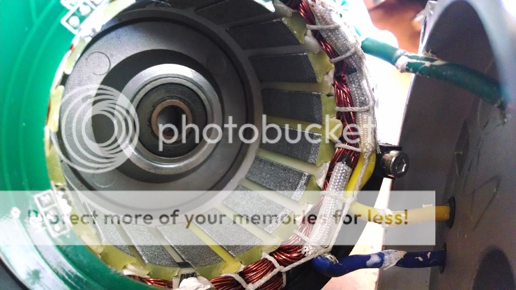

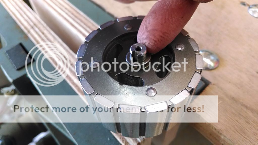

Remove the rotor from the stator and measure the diameter of the non drive side bearing journal on the rotor. It should be exactly 8.00mm. Check it for wear. Also check if it has a small orange o ring like on the drive side journal.

In my case, the noise developed over time. It was dead quiet for the first 1000km then started to get noisey. I had 2 problems. the screws holding the final gear were loose but also I discovered some wear on the non drive side rotor shaft. Loctiting and tightening the screw holding the final gear helped but a dab of loctite on the rotor shaft cured the noise completely. I am now up to 2000km and the drive is still dead quiet.
Keep in mind, my drive is an early model and I believe the rotor shaft wear issue has now been resolved (hence my question about the small orange O ring)
However, in your case, I doubt you are suffering the same the problems and more than likely have a QC issue with your drive. So your dilemma is whether to send it back or stip it down. It sounds like sending back would be entail long lead times and uncertain outcomes. With this in mind, I would suggest to open it up and find out what the problem is. The drive comes apart quite easily and if carried out methodically, shouldn't be too hard to find where the noise is coming from.
Over tightening the the 2 main nuts is not going to cause a noise problem. Please carry out the following.
With the chain removed, spin the cranks backwards. Does it spin freely and quietly? (4 or 5 turns after a hard hand spin)
If no, strip down the final drive section of the drive that goes through the bike's bottom bracket.
Next, spin the cranks forward. This will spin both the final gear and the intermediate shaft and gear. Listen for any scraping or unusual tightness. You should get one or two revolutions out of the cranks with a firm spin forward. If not, you will need to investigate further.
Let us know how you go from there. :)

One more question. - What kinds of grease did you use when you reassembled the drive? There are both a white and dark grease in mind.

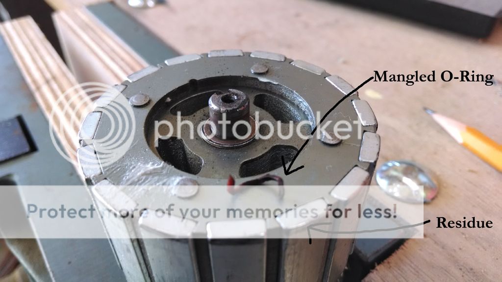

I think I found the culprit. One mangled orange o-ring. (Shaft still measures right at 8.00mm) - Glad I didn't keep driving the motor in this condition.
And a BIG Thanks for Kepler for steering me in the right direction here. I was basically ready to reassemble the motor, until he mentioned the rotor journal bearing issue.
Where to find a replacement o-ring: -
I know McMaster Carr (http://www.mcmaster.com/#) is a good resource. Looks to be this one? http://www.mcmaster.com/#5233t16/=riqqeg
Just ordered a pack of 50 pcs (smallest quantity MMC sells) of the 8mmx1mm Silicon O-rings. They should be here Tuesday.
If anyone else needs these, PM me, and I'll drop a couple in the mail for you for $3.00 shipped.
I also cleaned off the rotor magnets. You can see in the picture above a dark residue on the very end of the magnets. - I presume this is from when the dislodged o-ring got caught between the rotor & stator. - Explains the "crunching" sound I heard momentarily at the moment my drive developed it's noise. - For the record, I had about 450 miles on my drive before this happened. When I first got it, it was nearly silent.
And as an FYI, when you clean the Rotor, be sure to use a clean synthetic brillo pad, NOT steel wool. Don't ask me how I know this. :oops:

I would assume the replacement o-ring should go between the two washers?
No, it goes after the washer but without an O ring grove in the shaft, I think the O ring is not going to be of much use. The latest design rotor now has a grove for the O ring to locate in.
I would recommend you forget about the O ring and smear some Loctite evenly around the shaft before fitting it back into the bearing. I would go for a 641 Bearing mount grade Loctite for this area.
In relation to lubricant, lots of options here but the main point is not to use a petroleum based grease. I use this one http://www.chainreactioncycles.com/...gclid=CKP6g-DP3r0CFQEepQodASMANQ&gclsrc=aw.ds
You should be able to get it from most bike stores.
What's the purpose of the locktite on the bearing? - Is it to "lock" the shaft into the bearing at the base of the Stator?
I also have to ask the question: Where did the O-ring come from on my motor, if there isn't a slot for it?

Yes, the loctite is to lock the shaft to bearing and ensure it cant spin. It looks like in your picture that the shaft had spun in the bearing. In relation to pulling the rotor back out in the future if needed, I don't think it would be too much of problem as the loctited surface is quite small an would break away quite easily if required.
The O ring was just at the end of the gearing journal. Was a bit of poor design without an O ring grove to locate it.
