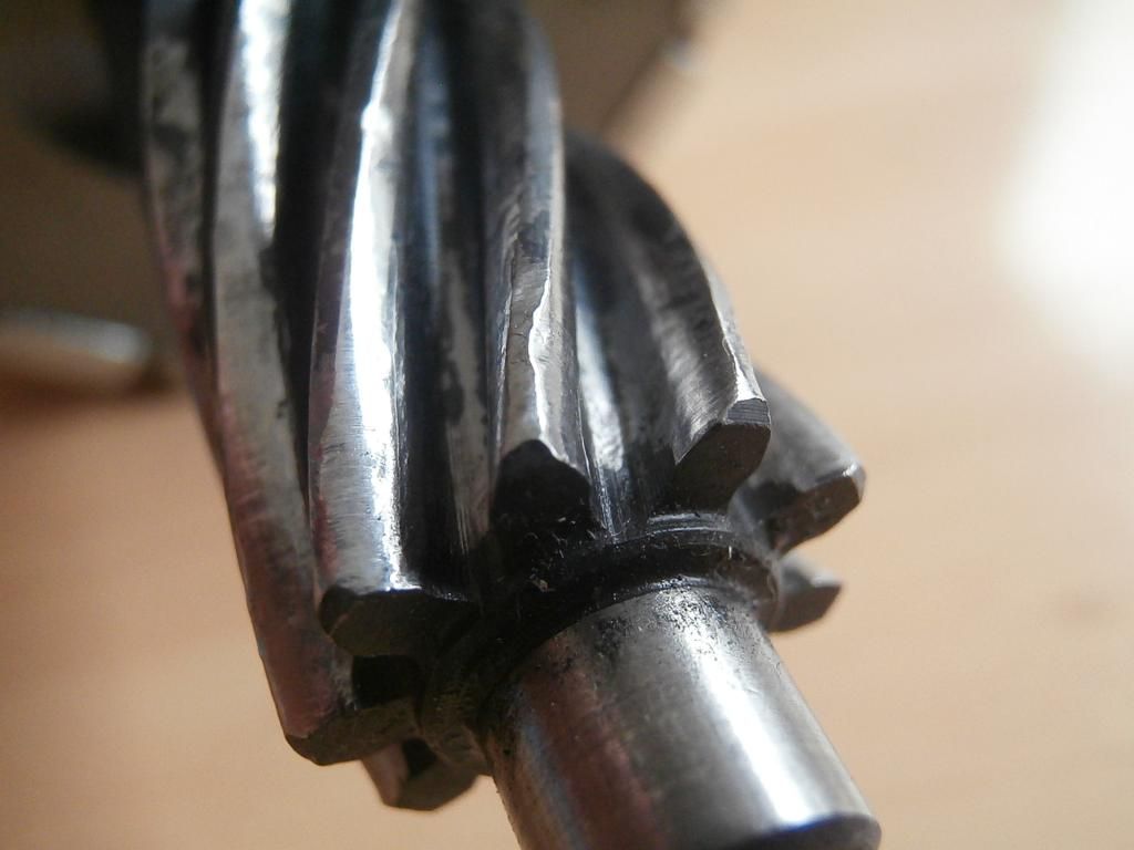

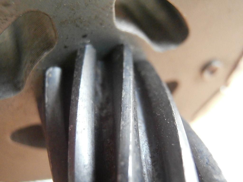

Okay so here is the final (I hope) tear down video. I would like to know if what I have found is normal or not please. Also hopefully you should see below the photo's of the helical part I think has some unusual wear on it. I think it shows it quite well. If you look at the mid shot although there is wear the right hand end seems to have accelerated & localised wear when compared to the rest.
Video: http://youtu.be/SThP7r_QCoA
This Is what I am calling the unworn end and looks like new.
This is a mid shot of the drive shaft.
This is a shot of the end that looks a bit chewed to me?

Yes, that gear is REALLY chewed up. Mine was in near pristine condition when I had to tear it apart. It had about 500 miles on it at the time. You have a problem in your secondary gearset for sure. What does your nylon gear look like? If you compare your parts to the photos I posted on the first page of this thread, you will see what mine looked like.

teslanv wrote:Yes, that gear is REALLY chewed up. Mine was in near pristine condition when I had to tear it apart. It had about 500 miles on it at the time. You have a problem in your secondary gearset for sure. What does your nylon gear look like? If you compare your parts to the photos I posted on the first page of this thread, you will see what mine looked like.
Yah I cant believe a metal gear has worn so much when it runs on a nylon one. If you look at he video above the pictures I show the condition of the nylon cog. Its not too bad, doesn't look chewed up like this one? What I dont show is them meshed together. I tried this and they fit together really well! I am definitely going to try to reuse them due to a total lack of spares in the UK AFAIK although I will investigate this because as soon as I got the bike built a year ago I kind of disappeared from the forum to happily use the bike and enjoy my life! Maybe a year on there are some uk distributors that carry spares and maybe pigs ride flying E-Bikes!

Glad you finally got to the bottom of the problem. The gear has some nasty damage but I think it will still be serviceable once you replace the bearing.
Anyway keep us up to date with how the repairs go.

How I removed the outer bearing shell from what was effectively a blind hole. I am sure there is an easier way... but I couldn't think of one so I did this!
Details of the bearing and more for the benefit of other users.

Post by Kepler » Jun 16 2014 4:42pm
Actually aniken, I did respond to your question when you posted your powerdown question on the BBS programming thread. Must have missed that.

Post by Kepler » Jun 16 2014 8:03pm
Nothing wrong with that method of bearing removal. Nicely done. I think you find the process of fault finding and repair followed by a perfectly functioning drive again a very satisfying experience.
