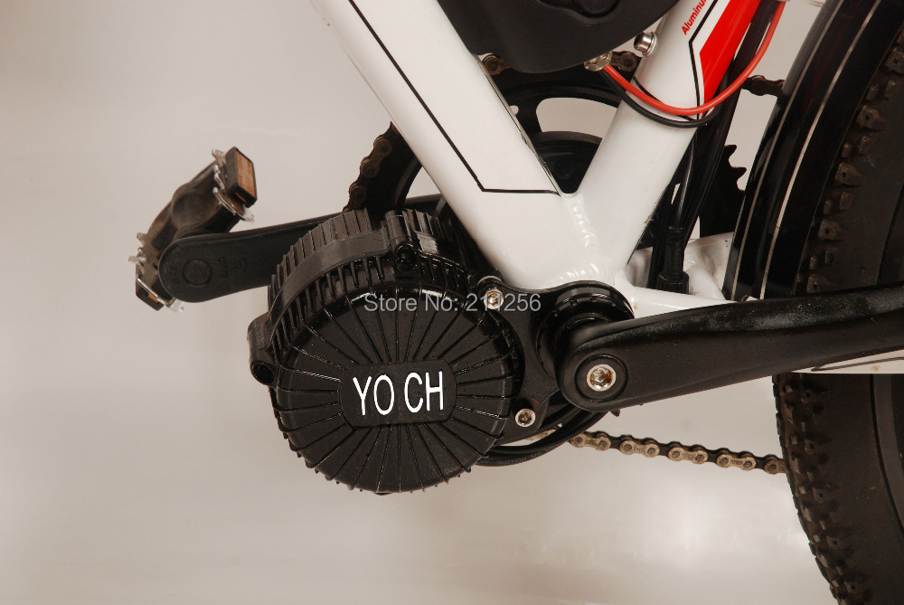

I did see one knock off from the bafang:
http://www.aliexpress.com/item-img/...-Motor-engine-drive-kit-D961/32318348544.html
At $425 it is about the same price as the original.
2015-New-Brand-YOCH-Mid-Drive-48v-750w-Mid-Crank-center-Motor-engine-drive-kit-D961.jpg
Doesn't appear to be much different, beside the logo.
