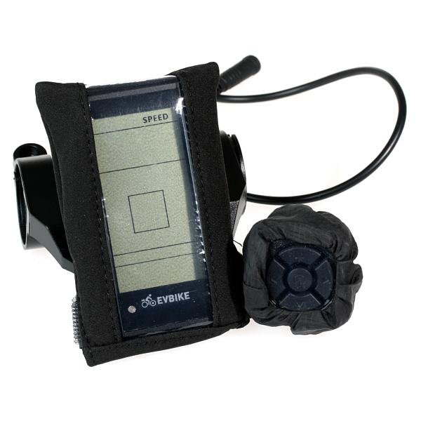

I had some strange behaviour yesterday with my BBSHD and DPC-14 colour display. I was riding along and all of a sudden I saw an error on the display. Sadly, I didn't have time to mentally take note of the error. After the error was displayed, the display started artifacting/pixelating. It looked very strange. Next, the display shutoff completely and wouldn't turn on again. But the throttle still worked, as well as the pedal assist. The power button / PAS controls didn't seem to be functioning.
The problem is, there were two unique situations I was going through: I let the battery run low, and it was raining very heavily. I'm not sure which of these caused it. I think the battery was running at around 42v around the time I ran into the issues (48v battery).
If rain caused the issue, the only weakpoint I could see is where my battery connects to the motor. Should I waterproof this connection point? They're connected via anderson connectors. How would I go about waterproofing this?
Racer_X   1 kW
Posts: 429
Joined: Oct 01 2009 5:48am
Location: Stockholm, Sweden
Re: Bafang BBSHD, 1000W, 68mm-120mm BB
Post by Racer_X » May 31 2016 12:49pm
The weak point is in the LCD display. You got moisture in your display and that is why you got the failure.
You need to fix a water proofing solution for the display. I recommend a LCD cover.

Racer_X wrote:The weak point is in the LCD display. You got moisture in your display and that is why you got the failure.
Where can I get something like that? When I Google Image Searched that image, no English sites popped up.
Not having any luck finding something like that on Amazon.

Gmullz wrote:Where can I get something like that? When I Google Image Searched that image, no English sites popped up. Not having any luck finding something like that on Amazon.
Then you got to think outside of the BOX and make your own.
You might try to modify a Waterproof Cell Phone Bag Pouch.
http://www.aliexpress.com/wholesale?cat ... Bag+Pouch+
