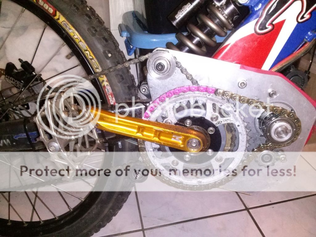

new cyclone motor mount giant glory 2009 Never got to use , after all the work s :x
thank you all 8)
mid drive giant glory 2009

i had show a pic a mid drive giant glory 2009 , it work very well, got a bigger fan and made it claener and had to use what ever allloy i had, very hard hard to get Allloy in this town , i had a trip away this year and got 20 kg of plate 10mm , for $30 love srap yards
now it time to made 2.0 mid drive giant glory 2009 ,, only help on 1 side with air cool unseen before, and very clean,
lipos will fit inside frame now, great low gg. and made feel, better ,, hope ing the motor will not hit rock or roots, nit funny doing super man at 40km plus on black dioman track xxx
test a new set up only 1 chian ring fast start up speed dew to less mass and More torque , hopeing i can pedal with it, to help power,
pic later to day . i start to work it at 2 am, in moring, like a llight in my head when off,, :shock:

hi all I got some work done , all I can say I hate pot. I srew up 3 time the pot got blend out shape bad in the lather
it was not fun to try save it ... I got the work done it dose not look hot any more. my friend with get the rest done in big lather and off centre the cap on the pot I hopeing I have save it .. other wise I need to start looking for more old pots around here , :(
more to come I working on gearbox for gt it1 frame too. thank you all

hi all parts are made. need a bit of cleaning up. then ano parts once I am happy they work right
I make new Eccentric. ring mounts better and help cooling , make new furnace to melt alloy it look cool from a beer keg
plus looking better. that make thing go faster
next is gearbox for gt it frame and make new Ti axle for cyclone motors . I never worked with Titanium Ti-6Al-4V
if any one know how to cut it the right I love to hear it :?:

very close to done just need wiring it up . plus ano parts with a bit of clean . they look good thank You pot I hope dose not blend under-load
think for a bit I may add carbon inside the pot to help it
take 3 years but got they
sill have make Off-Center or if you call it Eccentric ring , tool to get chain in the right place Very happy my old chain worked .
if any one know best way To cut Ti plz tell me 8)
want make Ti headset Eccentric, with deep cups and new ti axle for frame and cyclone motor axles from ti .
over weekend hope to test in downhill track, :D
