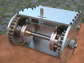

Hugh-Jassman
Posts: 221
Joined: Jun 20, 2015 12:57 pm
Re: Two speed gear box for e-cargo bicycles?
Post by Hugh-Jassman » Oct 05, 2015 2:04 pm
why is it so hard to find things on this endless sphere?
I found this photo once but not again....
Miles
Posts: 11436
Joined: Mar 16, 2007 4:15 pm
Location: London UK
Post by Miles » Oct 05, 2015 2:31 pm
Hugh-Jassman wrote:....I found this photo once but not again....
https://endless-sphere.com/forums/viewt ... 28&t=22525
