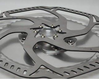

I really like this one. Does anyone know why it may not work?
like where can I get large sprockets for it? I need to do a 9:1 reduction so maybe a 144 tooth?
Looks like I will need a longer axle, about 1/4 inch?
http://www.bicycledesigner.com/rotor-an ... apter.html

Thanks for the link! the picture of the black sprocket adapter was one i was selling. I'd commit a felony to get my hands on another one, but i'm sure i bought one of the last ones :cry: :cry: :cry: :cry:
The king's sales and service adapter is trash.. tried one.. threw it away.
That clamshell adapter mentioned earlier also only works on some bizarre single speed hubs.
The bicycle designer one you mentioned looks like the only legit option for now, and is worth a try.

Given that the rear brake can only provide about 25 percent of maximum braking, why not just use a rim brake and have the rotor mount freely available for a sprocket? Trying to stack both of them on the same mount introduces spacing and contamination issues that will make a disc brake less effective than a rim brake anyway.
If the frame isn't equipped with brake bosses, a brake plate that has them is a simpler and easier machining project than a sprocket carrier for the rotor mount.
