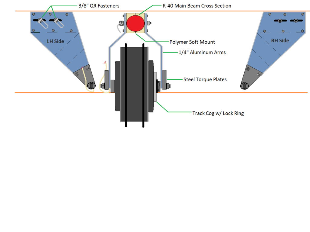

Hello all!
Time to make a "new years resolution ...." gonna get a motor that I KNOW will do everything I want, unfortunately, that was NOT the goldenmotor 650W trike motor, it was pretty good, but on serious hills, it just wasn't enough for when I would loose my strength after a long ride, AND I want to be able to haul cargo.
My first impulse is to get another CroMotor, but I will check and see if there isn't something in the middle between the 9C 9x7 which is close but not quite enough, and the 5000W continuous CroMotor.
I will be running a 48 - 74V system (A123 prismatic at 48v 20AH or 74 LiPo 18AH if that isn't able to perform as needed) and I am looking to climb hills with about 450 lbs of cargobike, (that is total weight including the rider, bike and cargo) up a 10% grade for about 2 miles on a regular basis.
I really like the near silent operation of a DD hub motor, and with the NuVinci N171B IGH, I will have tons of gearing to use, with a target of 20 MPH on the flat,(and as close to that as I can get to that speed climbing) while still having reasonable range of around 30 miles.

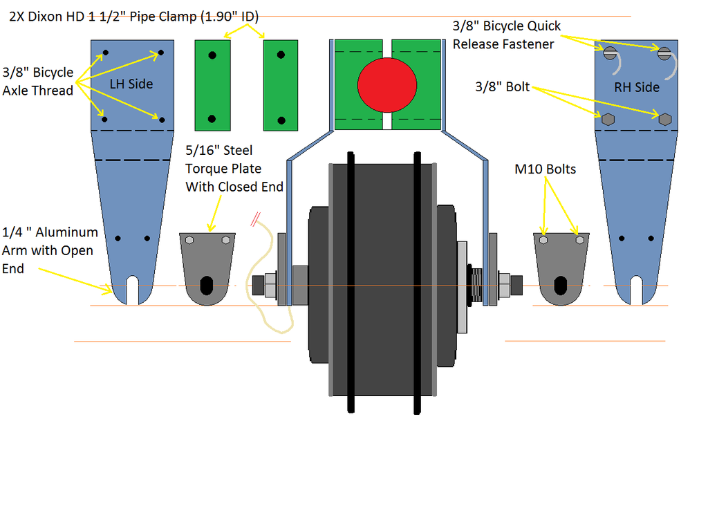

Anyway, here are some preliminary drawings of my planned build:
(The basic design will use the through holes already on the R-40's main beam, I am hoping probably too optimistically to use the QR skewers which are for the seat mount, but I expect I will end up using larger bolts, but I really want some form of QR fastener for easy chain tensioning.)
(Here is a drawing of how I would design the two side plates to attach constructed out of 1/4" steel, hopefully the local college and or machine shop have a way to bend the steel that thick, that or I will use Aluminum with Steel Inserts at the Hub Axle & Since the NuVinci Freewheels internally, I will be using a track Cog on the Hub, the pedal chain will be on a second complete chain just outboard and will be using a Freewheel at the NuVinci hub in the rear wheel.)

Amazon the rescue!
http://www.amazon.com/Axle-Release-Clas ... B004Y97ZLK
I'm going to up-grade the skewers to these 3/8" adapters!
3/8" bolts should be more than enough, AND I get a QR mount! :mrgreen:

Up-Dated Drawing:

I just found a perfect off the shelf item to act as my "Polymer Soft Mount" could only take 2 of these to do the trick, but I would probably use 3 just to spread the load more evenly:
http://hosewarehouse.com/HHD24P-Dixon-H ... amp&page=2

Well, I have had a realization today!
Not only will this design work for my E-Bronco cruiser, but I can make THIS design much simpler too!
Instead of the fancy bends put into the arms, just have wider spacers and keep them flat!
I am confident that this shouldn't reduce stability as I am only adding 1- 1/2 - 2" total width and it will still be plenty strong, adding in addition spacers in plastic, and if needed, I can space the clamps further apart.
Re: SWB Vision R-40(E) Recumbent with DD Hub Mid-Drive
Posted: Jan 07 2016 12:22pm
by LI-ghtcycle
Just pretend that I changed this drawing to have the aluminum arms straight and added additional spacers instead of having bent arms. :P
