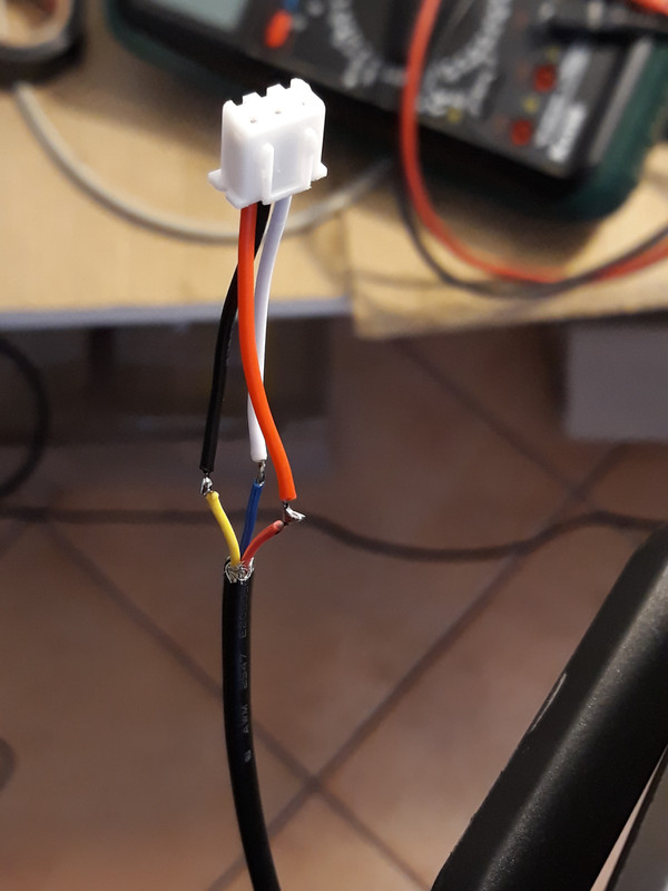

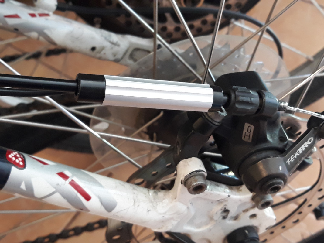

Got my metal gear and now my TSDZ2 motor is running again -- happy happy :-) :-)
This time I also installed the brakes as others told me, maybe the reason for nylon gear broke in the first 20kms was because I brake with motor pushing.
My kit was the most cheap and didn't came with brakes. Anyway, I had in stock the "hidden wire brakes" and connected to the LCD. Works perfectly. I also had in stock the connectors JST XH 2.5mm that are very easy to buy online and they fit perfectly on the LCD:
"hidden wire brakes":
Connectors JST XH 2.5mm and the wire connections:
- TSDZ2 OpenSource firmware

My ebike, with "hidden brakes" installed. The battery bottle is a bit loose and later I will put some black and strong tape. Later I will also install my usual saddlebags.

And I got the control of each segment of the LCD3. Next I will start structure the firmware so it is easy to print numbers and strings to the LCD odometer field. Then I want to ride my ebike and show on LCD3 the TSDZ2 real time motor current, battery voltage and motor wattage:
