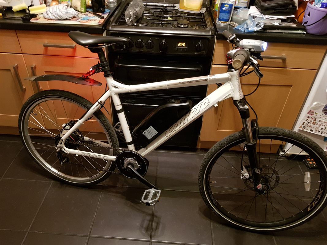

Just finished my 36v 15ah TSDZ2 project (Nuvinci 360 rear hub).
Going to put a few miles on it in standard form and see how it goes.
Read all 160+ pages and very interested in trying out the new firmware, will be deciding on which display to go for. Shame you can't use a PC to program the motor and keep the original screen but can't have it all!.
Really surprised there is no source for the connectors, for me it will be trying to get the new screen to plug into the orignal connector one way or another. Won't be chopping off the orignal screen connector though..
Did a few miles on mine last night and the Nuvinci is a really good match with the TSDZ2.

Very nice, I also have a N360 on my Cargo bike with the TSDZ2 running the open source firmware. Really recommend switching to it, though you are correct you will have to make your own cable.
One point to watch out for with the Nuvinci - don't try to change under too much load, I forget to shift down before starting off one day and gave it too much of a twist with 500W going through it and managed to pull the cable out of the tiny barrel for the shift down direction. You can of course stop and manually move to a lower gear with that cable no longer engaged.
Shifting up under load (to a higher gear) is a bit more forgiving. I have heard of people putting over 1000W through these, though at high torque, low rpm the oil seals can go (ie dead hub)

Nuvinci stepless IGH are perfect for mid-drives like the TSDZ2. Keep an eye out for the new N380x It is rated for 500W but early literature said it was designed for bursts of 1000W which puts it up in the BBSHD category. Fallbrook Tech went bankrupt in 2017 but rebranded as Enviolo. The N380x is found in their 2019 Sportive and Cargo groupsets. Sampling to manufacturers but will hopefully have general availability later this year. They may be moving entirely away from the N3x0 branding but the N380x is definitely in their newly branded Sportive and Cargo groupsets.

Yep the Nuvinci is a great smooth hub, I back off the pedals when changing ratios.
Great news that VLCD5 display is supported with computer to allow settings changes, will buy a programmer!.
Are all the wires included to the connector pins in that speedo cable extension?, not to bad price wise but shipping to UK may kill it.
If it's only a flashing cable I have to make I might try and make a connector.
