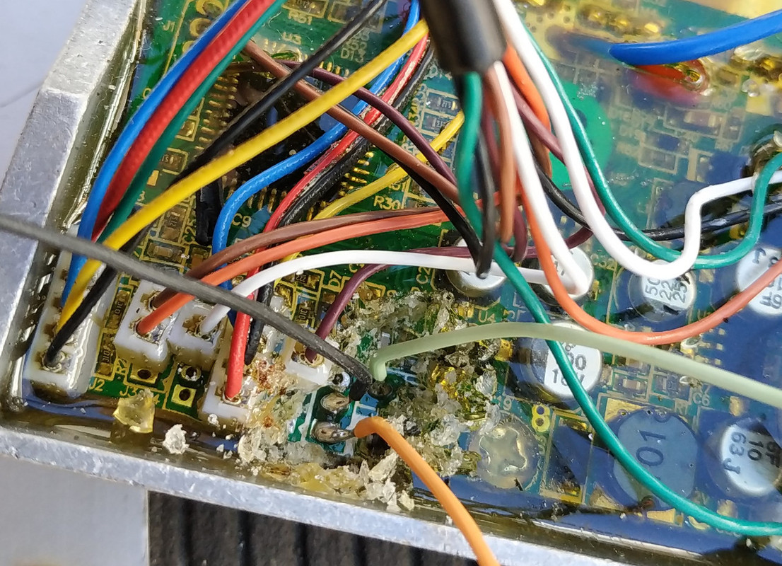

ashrambo   1 W
1 W
Posts: 55
Joined: Apr 30 2018 4:31am
Location: Madrid
Post by ashrambo » Apr 01 2019 6:07am
hego wrote:
Feb 24 2019 11:14am
Casainho two questions:
a- The conexión into the controller for the termal sensor LM35 operation are diferents points of the usually documentaion. Where take the +5v?
b- There is any problem with this sensor when we use back the stock firmware. Any problem or interference?
Thank´s
I have the same question,
The connection point in the controller for the LM35 sensor is different from the "temp sensor" documentation in the wiki. Are the two points + 5v?
Is there a problem with this sensor when we use the original firmware? Any problem or interference?

ashrambo wrote:
Apr 01 2019 6:07am
hego wrote:
Feb 24 2019 11:14am
Thank´s
On wiki there is a picture showing were to wire the 3 signals. I can't understand your question.

Post by ashrambo » Apr 02 2019 3:19am
casainho wrote:
Apr 01 2019 10:57pm
ashrambo wrote:
Apr 01 2019 6:07am
hego wrote:
Feb 24 2019 11:14am
Thank´s
Here, the +5v hole is that:
and here in your last installation the orange cable is in other hole
TREK REMEDY MOTOR TSDZ2

Post by casainho » Apr 02 2019 3:29am
ashrambo wrote:
Apr 02 2019 3:19am
casainho wrote:
Apr 01 2019 10:57pm
ashrambo wrote:
Apr 01 2019 6:07am
hego wrote:
Feb 24 2019 11:14am
Thank´s
Both pictures are correct. Follow the one that is better to you.
