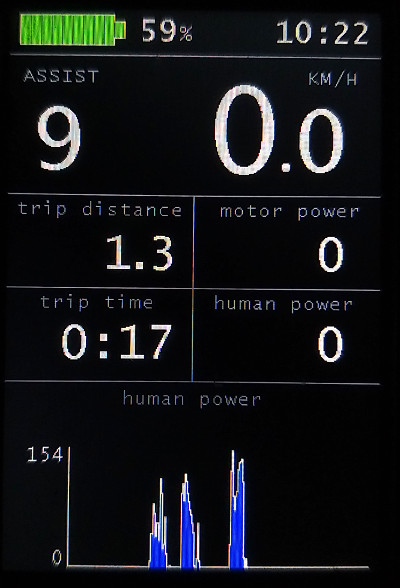

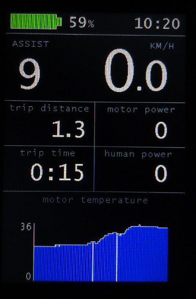

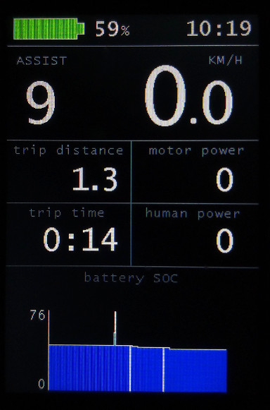

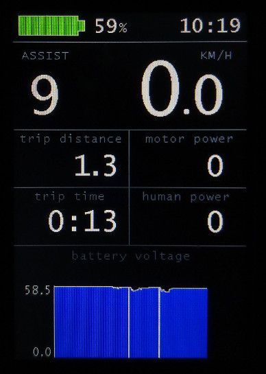

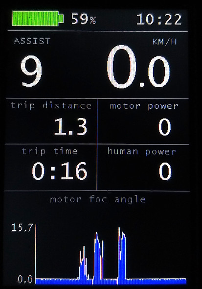

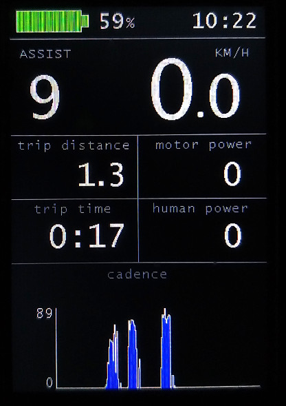

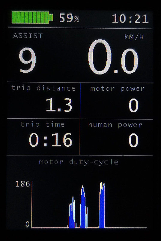

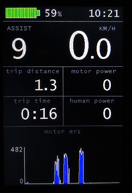

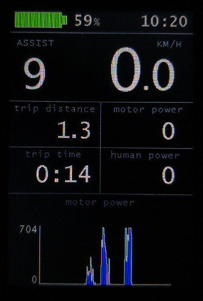

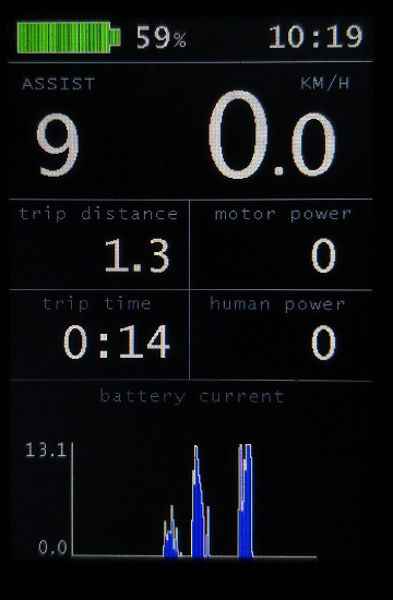

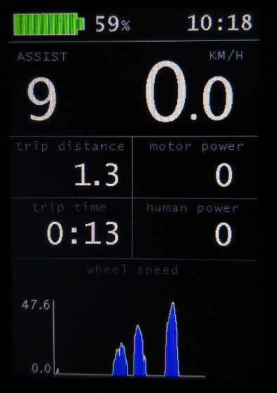

Current state of the 850C LCD firmware, which I hope to release soon another new version:
I got working the quick selection of variables to show on the graph: on the main screen, we need to click + long click on ON/OFF button and the graph title blinks, then we can select another variable by using UP and DOWN buttons. Then we leave this mode by long click on ON/OFF button.
Other than the regular variables like pedal human power, pedal cadence, battery voltage, motor power, etc, we can also select ones that are tecnhical like motor angle FOC (maybe in future this can be disabled in configurations).
I took a ride and let me show the graphs (graph shows an interval of 15 minutes) and let's learn a bit how the motor works.
On this ride I was able to go up to 47.6 kms/h:
My cadence was max of about 90 RPMS:
The human power max was about 150 watts:
And the motor current max was:
And the battery voltage, as we can see it dropped with the current peaks. (Some 0 values on the graph, must be some issue).
And the motor power, was max of 704 watts (see that for I get up to the 47.6 kms/h on a light descend, I had to do 154 watts on the pedals while the motor pulled 704 watts from the battery -- assist level factor of about 4.6):
The motor temperature did increase a bit after this short current peaks:
Motor PWM duty-cycle (possible max value is 255):
Motor ERPS (electric rotations per second), where max permitted value is 525 but with high cadence mode this value can be higher:
And the FOC algorithm angle, it increases with both motor ERPS and current, this is what makes the motor to run most efficient possible, having the most torque possible for the same battery usage power and be most silent possible:
And finally, the battery SOC based on Coulomb counting which has good accuracy:

Wow, that really looks great!
