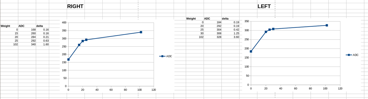

Post by casainho » Jul 26 2019 8:08pm
Finally we own the TSDZ2 torque sensor!!
Up to now we were reading the torque sensor in a wrong way and it could only measure up to 25 kgs. Also there is a big difference from the values read on left or right pedal. This are the output values of my torque sensor (that I bought 3 weeks ago):
I implemented the linearization of the torque sensor measures and it can now measure up to at least 102 kgs (which is my weight). I also implemented a linearization based on a table with values for left and right pedal and it works very well: before my right pedal was measuring the 102 kgs of my weight but left pedal would measure only 70 kgs, now both pedals measure the same values.
Before my display was showing to me a value of pedal human power of a bit more than 100 watts, no matter the force I did and now, I can go up 400 watts for short peaks. I think strong cyclists will love to see their real pedal human power on the display!!
And by the way, I am pretty sure there is no need to calibrate the sensor as I did before, no need to open the motor and adjust the hall sensor position of the torque sensor.
Calibration process
1. user put values on right pedal, starting at 5 kgs, in steps of 5 kgs up to about 30 kgs. Finally put itself on the pedal with his known weight value. The pair of weight and torque sensor ADC value should be registered and later user will need to decide for 5 points only, 1 at start, other at the last value and 3 values near the knee on the graph, as shown on the graphs.
2. Repeat for left pedal.
3. Put the pair values of weight and torque sensor ADC values, for each pedal, on the specific LCD configuration menu.
One important thing for all this work is that at system power up, the right pedal should be pointing to ground -- as there is the need to identify which pedal we are doing the force and there is no way to identify them, I decided to do like this, having the pedal at a known position at startup and after that everything will work well.
I have the code working on my bicycle and I can see on the LCD the weight value in kgs on the LCD. The tables for linearization are for now hardcoded on the firmware, I can't setup them yet on LCD. When we have the next version of firmware I can add this feature to it.
Developer of the Flexible OpenSource firmware for EBike motor controllers (TSDZ2 and KT) and displays (Bafang 850C color, SW102 Bluetooth and KT-LCD3).

thineight   100 W
Posts: 192
Joined: Oct 05 2018 3:53am
Post by thineight » Jul 27 2019 7:45am
casainho wrote:
Jul 26 2019 8:08pm
Hello Casainho,
I do not quite understand the last message and chart.. perhaps I missed a step somewhere.
We used to see from the last round of discussion that the rest value of the torque sensor is between 25 and 40 (the lower the better) and the upper value for linear variation was about 70, above which we can appreciate the knee of the bi-linear behavior.
Starting from a lower value allows you to have more resolution to read increasing forces before saturate the sensor. That's why, I understood, it's useful to calibrate the sensor with the skrewdriver to have low rest values.
See also my prev. post here with my values:
viewtopic.php?f=30&t=93818&p=1480176&hi ... e#p1480176
Now I see from your chart that the readings range from 150 to 350.. ?
Could you please clarify what are these readings and why you state that the previous calibration (to bring the rest value down to a low value) is no longer required?
Moreover if you remember, in the past I was reading a rest value of 48 and after few weeks a value of 51.
If this is a general trend observed by many users we may conclude that the torque sensor suffers a sort of "aging", and this maybe can affect some of the algorithms..?
MTB KTM Ultra 29" - City bike DAYTONA 28"

Post by casainho » Jul 27 2019 9:02am
thineight wrote:
Jul 27 2019 7:45am
casainho wrote:
Jul 26 2019 8:08pm
Hello Casainho,
I am really happy to discuss what I did learn about all this, sharing with others so we can improve forward.
Looking at that graphs, I think that even If I adjust the hall sensor position and the rest value lowers to something like 30 instead of the 46 (184/4 = 46), the other points will be just the same. So lowering the rest value means increasing the high sensitivity range but see that even if I didn't that, the torque sensor can still measure my weight which I think will be mostly the max weight I will put on the pedals. So, is it really need to do the other process that is hard and risky to damage the torque sensor? -- even if was needed, this second part I did would anyway be needed to do, so, if possible I think we should skip the first part because the reasons I did mention.
The values of ADC are now 4x times higher because I decided to use the max ADC resolution of 10 bits instead of previous 8 bits. This is a must because of the low sensitivity range. I think we could even try to go with like 12 or 14 bits, by doing oversampling which seems to be a popular technic but for now I think it works very well.
The change on the resting values, sometimes if you rotate the pedals backwards it will go back like 2 or 3 units. I think it is not an issue.
The math I did and implemented on the code considers the value starting at the rest value and counts the steps up to the next point, so, if it changes a bit every startup, there is no issue (at startup the rest value is recorded). Also, this units at rest value represents kind of little change on the final value, like each unit is 0.7 kgs, so 3 units of variation is like 2.1 kgs, that is a very low value/step that we can not control/feel the difference with our legs.

famichiki wrote:
Jul 27 2019 7:00pm
casainho wrote:
Jul 26 2019 8:08pm
Will doing the calibration process mean we don't need to keep our feet off the pedals at startup any more? Does it need to be re-calibrated before a different person rides the bike?
No, it should work for everyone and you need to keep your feet out of pedals and the right pedal down in direction to the ground!!
You need to download this firmware version from here (based on 0.19.0, you must have 0.19.0 on LCD):
https://github.com/OpenSource-EBike-fir ... ration.zip
You need to put you sensor own values on file ebike_app.c and then build the firmware:
Code: Select all
uint16_t ui16_torque_sensor_linearize_right[TORQUE_SENSOR_LINEARIZE_NR_POINTS * 2] =
  // ADC 10 bits step, steps_per_kg_x100
  0, 16,
  260, 16,
  284, 21,
  292, 63,
  340, 160,
uint16_t ui16_torque_sensor_linearize_left[TORQUE_SENSOR_LINEARIZE_NR_POINTS * 2] =
  0, 19,
  292, 19,
  304, 42,
  308, 125,
  328, 360,
Table ui16_torque_sensor_linearize_left is for left pedal and the other for the right one.
The values on left column are the ADC steps that you will read on the LCD but you will need to multiply them by 4 to get the ones to put on the table. The last point is your weight and the first one at resting but you must put 0.
On the right column are the steps in kgs X 100, like the first 19 means that each ADC step is 0.19 kgs * 100 = 19, because each ADC step that I did read on LCD was about 0.8 kgs and so for the 4x more I had to divide to 4.
Also note that Pedal torque sensor, menu 9.3 on LCD3 now shows the weight on the pedals so you should check here how is your torque sensor measuring the weigh - please check before doing the calibration as my values may be near the ones for your sensor, who knows??
You check the ADC value on 9.2 and see the measured kgs in 9.3.

casainho wrote:
Jul 27 2019 7:49pm
famichiki wrote:
Jul 27 2019 7:00pm
So every time we switch the bike on we still need to keep feet off pedals and now also ensure the right pedal is down in direction to the ground?
I was hoping maybe after the new calibration process that wouldn't matter any more. So we could just switch on with a foot on pedal and go.

famichiki wrote:
Jul 27 2019 8:50pm
casainho wrote:
Jul 27 2019 7:49pm
famichiki wrote:
Jul 27 2019 7:00pm
That is not possible. Note that we are doing advanced features, improving the motor, that the original motor/firmware don't have, it misses hardware for this specific features and so there is this workarounds.
I am not sure users will prefere this or simple use the torque sensor not calibrated.
