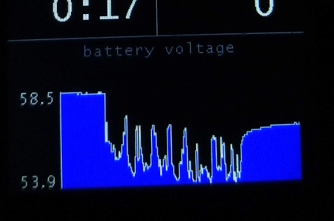

I just installed my new TSDZ2 36v and 48v battery on my purpose-built cargo bike. I am very disappointed by the performance of overvolting. I expected it to be like experimental high cadence 36v on my v0.16 TSDZ2 which is on my other bike. It's not even close.
I have v 0.19 of the firmware and a KTLCD3. I reset everything to factory defaults and setup the motor as type 1 (36v). there is no discernible increase in cadence with the48v battery when compared to swapping it for the 36v battery. and it doesn't seem to register cadence correctly with the 48v battery it eratic. sometimes high sometimes low.
It runs fine with the 36v battery. the new 36v experimental high cadence mode is much improved over v0.16.
I tried the new motor (with 48v battery) in mode 0 (48v) it feels teh same as mode 1. However, in mode 3 (experimental high cadence 36v) it flies. its brilliant.
So my question is - whats the danger with keeping the 48v battery and running in experimental high cadence mode 36v ?
I'm very tempted to return the battery and just get another 36v one. Thoughts?

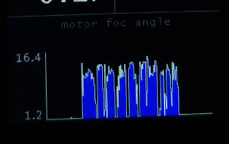

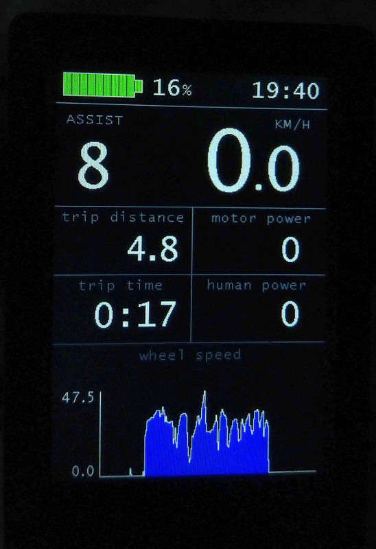

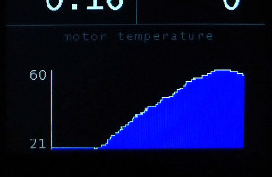

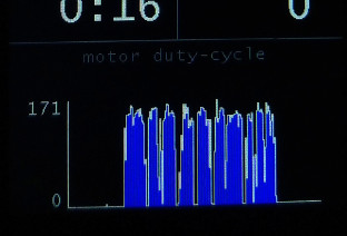

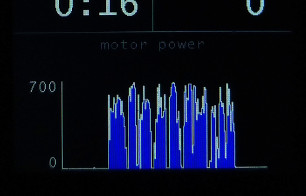

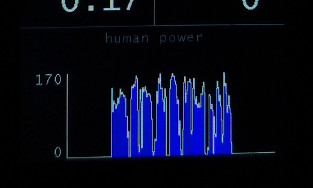

Post by casainho » Jul 30 2019 11:07am
Bartman wrote:
Jul 30 2019 10:38am

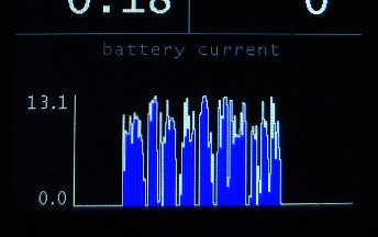

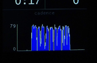

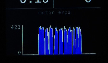

Please post pictures of your cargo bike!! There aren't much pictures of cargo bikes with TSDZ2.
The high cadence modes should be less efficiency, using more battery power and maybe heating more the motor controller. By now, I think some users already use this mode and no one reported any fatal issue like motor or motor controller burned so I think is probably safe to use it.
You can try find what is limiting the motor RPM and hence cadence, see your values of battery current, motor ERPS and motor PWM ducty-cycle -- see my graphs here showing this variables:
Here is an example of a real riding I did, pulling about 13 amps from my battery that is the max it can handle.
As you can see, the duty-cycle and the motor ERPS values were not at their max values (255 and 525 respectively) but if I was using the max cadence or the max motor power for the battery available, the motor hits his limit even if I pedal harder/use higher assist level. Because of this, I would like to show some warning to user when the motor power hits the limit, maybe changing the power power number from white to orange or something like that.
