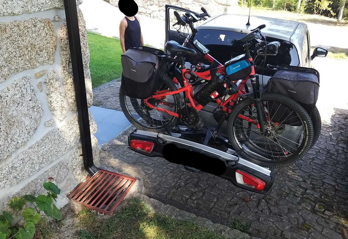

- 90 euros cost the Q85 36V250W HUB MOTOR on BMSBattery.com
- 68 euros costs the TSDZ2 motor, on PSWPower.com
This was my very first ebike, in 2010, with the KT motor controller of 250W, Q85 front motor 24V 250W and PAS only:
And this was my kid VERY HAPPY, only 2 years ago, testing for the first time his 18 inches wheel ebike with the Q85 front motor 24V 250W, with PAS and throttle:
My kid has now a MTB 20 inches ebike with TSDZ2, now he flies at 40 km/h and already does a bit of MTB, as also rides from home to home of the family.
