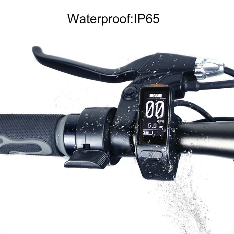

The 850C features a clock, large color display and usb charger and the SW102 is bluetooth but I'm not sure which is the most "future proof", in terms of memory capabilities, etc.
