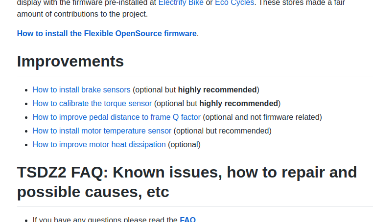

Post by casainho » Mar 23 2020 7:39am
ilu wrote:
Mar 23 2020 7:23am
casainho wrote:
Mar 22 2020 6:56pm
How to improve pedal distance to frame Q factor
Also from several Aliexpress sellers you can buy only the right side Bafang crank for about 10$ shipped.
It makes quite a big difference, before I had constant slight feeling of sitting off centre even though being straight on the saddle.
Thanks for the feedback. I added some of your words that are better than mine. I also added a topic for Improvements to the wiki, adding this Q factor improvement and others:

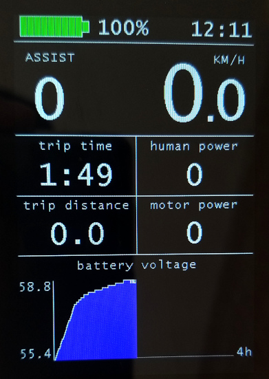

Post by HugoM » Mar 26 2020 11:27am
Hey guys!
I have been lurking on this thread for quite some time and thanks to you have managed to build a nice stealthy e-bike (Picture of the bike)
However after installing the motor and flashing open firmware my max speed is limited to 28 km/h and after that motor doesn't assist even though I have set it to max 99 km/h in the settings on the SW102. (Picture of the settings) (Picture of strava analysis) I read that that max speed for TSDZ2 is 45 km/h. Any Ideas what's wrong?
Secondly, sometimes SW102 doesnt display the battery level correctly. On the latest ride display showed 0% however battery level was actualy 82%
My batter is DIY mini 52v 14s2p,made with Samsung 25R 18650 2500mAh and
v0.7.0 on SW102
v0.56.0 on TSDZ2
casainho   10 GW
Posts: 4094
Joined: Feb 14 2011 2:43pm
Post by casainho » Mar 26 2020 11:37am
HugoM wrote:
Mar 26 2020 11:27am
Hey guys!
About the max speed, you need to learn/understand the technical variables and see what is the limiting factor. Maybe is just you that don't understand the system limitations.
About the battery SOC, again, you need to debug looking at the different battery values like the measured consumed Wh and battery voltage.
I use 52v 14s2p 3500mAh but I can´t pull higher currents but your cells have lower Wh capacity but should handle high currents discharge. Really nice to have small battery packs!! If you use a 36V motor, you could have an ever small and light battery :-)
- TSDZ2 OpenSource firmware

casainho   10 GW
Posts: 4094
Post by casainho » Mar 26 2020 12:26pm
Being able to graph the variables is so nice... I did this for the first time, I had my battery at 68% and decided to connect the charger but kept the 860C display on. Here is the graph of the battery voltage over the charging period -- as we can see, near the end of the charging, it charges slow because the voltage on the cells get's near the voltage of the charger so less and less current flow to the cells and so they absorb less power per time:

I have now added a 'Gear sensor' that is fitted to the gear cable near the changer on the handlebar and connects to the VLCD5 brake sensor sockets. This works a treat and stops the motor for app 1 second when changing gears up or down.
I bought the version that includes magnetic brake sensors (I have hydraulic brakes). It is now possible to approach an intersection or other potential sticky situation, and apply the brakes to stop the motor while keeping pressure on the pedals to maintain stability where a near 'track stand' is required.
I have also installed the MBrusa version of the open source software v 20beta1 that includes a fix for the motor overun discussed on viewtopic.php?f=30&t=98281&start=875
In case you have the same issue here are the details of the item I purchased...
