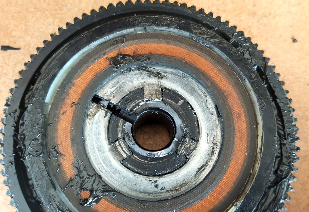

Post by casainho » May 05 2020 8:14am
TSDZ2 rider max weight
I just added this important piece of information to TSDZ2 FAQ -- see the pictures bellow showing the torque sensor central tubular axle broken!!
https://github.com/OpenSource-EBike-fir ... max_weight
TSDZ2 should work well for riders up to 100 kgs. For higher values like 110 kgs, it will also work but it is recommended to avoid doing big impulses (put full rider weight on the pedals) and with high gear, at startup, to avoid the risk of broking the torque sensor.
Casainho wrote: After using TSDZ2 for more than 2 years (since begin of 2018), on different bicycles and with different TSDZ2 motors, doing both MTB and city commuting, with my weight around 105 kgs, I never had a problem.
On 2020, my weight increased to 111 kgs and one day at city I did a big impulse at start pedaling, while I was standing on the pedals with a high gear, the central tubular shaft of the torque sensor broke doing a big cracking noise. Everything went back to normal after I exchanged for a new torque sensor and now I will avoid to do that big impulses on the pedals and with high gear.
