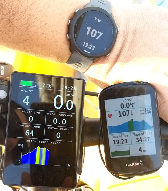

About TSDZ2 engine power
This engine cannot be compared to the Bafang. The Bafang is also not a torque engine.
It is better to compare this engine with the Brose engine of the new Specialized Turbo Levo SL (Super Light) which has a very light engine, with about 200W nominal. This bike weighs about 17.5 Kg with a 320WH battery.
Details of the test I did yesterday
I weigh 67 kg, plus the backpack and the clothes should reach 71 kg.
My bicycle, total suspension, is about 19.5 kg.
Light wheels 27.5 and light tire width 2.4.
The circuit that I did yesterday and that I use to test this bike, is an aggressive MTB circuit, which has 13.9 km and an accumulation of climbs of about 400 m.
The land is in the forest, with a dirt floor and some gravel, roots and stones.
The ambient temperature was around 22.5 degrees.
The battery was charged close to maximum and about 59V at the beginning of the circuit.
The configuration of the FW / motor was with the maximum current of the battery at 10 Amps and the current of the motor at 16A.
During the 13.9 km, the engine temperature never exceeded 70 degrees. The maximum increase was 47.5 degrees, over the outside temperature.
The average speed was 17.7 KM / h
After this circuit, I started it again but I only did about 2 km with the battery current at 16A and the motor current at 25A.
I had to give up because the engine stopped when it reached 85 degrees.
This motor is not designed to repeatedly and sussessively exceed the 500w peak. In this environment that I exposed.
Below I present some statistics of the circuit I made.

Since last night I am a proud owner of 3 working OSF displays: 850C, 860C and newest arrival is SW102
The little one is really a cutie...Now my question:
Anyone who owns both 850/860 and 102: which one has become your favorite and why?
You mean you have 3 ebikes?
I own both but I use 860C on my ebike. I like SW102 because it is cheaper, robust and very discrete. Still, I prefer 860C because it shows the motor temperature graph and with that I can better manage max TSDZ2 support because I ride fast (like peaks of 50 km/h) as possible on the city on dangerous streets because they are narrow and with lot of cars at fast speeds. What I don't like on 860C is the fragility in the case of a fall when I do MTB (because is big) and is not discrete but luckily, currently, I don't need to leave my ebike at the street.
But with the next project to make TSDZ2 as an standard wireless ebike motor, I will be able to have a easy removable display with no cables at all, meaning more robust and very discrete when leaving the ebike on the street. And even better than 860C because it will have much more data and graphs, much more customization that is already done and is not part of this project, I mean, we will not need to develop it because others already did - thanks to standardization:
That is my Garmin Edge at side of 860C display. With this new project, I will be able to control TSDZ2 on the Edge and I will not need the 860C anymore. And as you can see, I can see my heart rate on this display, because my watch is reading my heart rate and broadcasting it wireless using standards - so in future, we will have much more flexibility on the data and graphs as also GPS navigation, cycling fitness metrics, etc thanks to using well known brands of cycling computers / displays - there are simple and cheap ones for the price of 860C and others advanced up to 500€. Even DIY a display will be simple. And, wireless remote buttons and mobile app, meaning no need for a display at all.
- EBike wireless standard: wireless motor, wireless cycling GPS display Garmin Edge and wireless remote with wireless brake sensor
- TSDZ2 OpenSource firmware
Developer of OpenSource knowledge and technology for ebikes: Wireless EBike standard ANT+ and Bluetooth, TSDZ2 OpenSource firmware, KT motor controllers and displays: Bafang 850C color, SW102 Bluetooth and KT-LCD3.
Please consider a donation to help developments: paypal.me/jorgecasa
OMG.....WOW...I was not aware of this....WTF.....how will i be able to keep up with all of this? wow....casainho wrote: ↑Jun 08 2020 4:59amYou mean you have 3 ebikes?

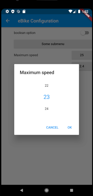

Does this also include a smartphone with a dedicated app?
To answer your first question: no, i have only one and I am just a curious old man with a too big amount of childish behaviour.but: i also have a GF and she will inherit the 850 to begin with...
raw is the other developer that is developing the mobile app. I will be developing the firmware only, and there are well documented standards for wireless ebike (the same standards used for Turbo Levo ebike, for instance) and working example firmware. Then, brands like Garmin have that display GPS cycling computers that connects and control the wireless ebikes, and this devices implements advanced fitness metrics, navigation, connection to cycling sensors like pedals power meters and even wireless tire pressure sensors!andyme wrote: ↑Jun 08 2020 5:13amOMG.....WOW...I was not aware of this....WTF.....how will i be able to keep up with all of this? wow....
Mobile app prototype shown by raw:
