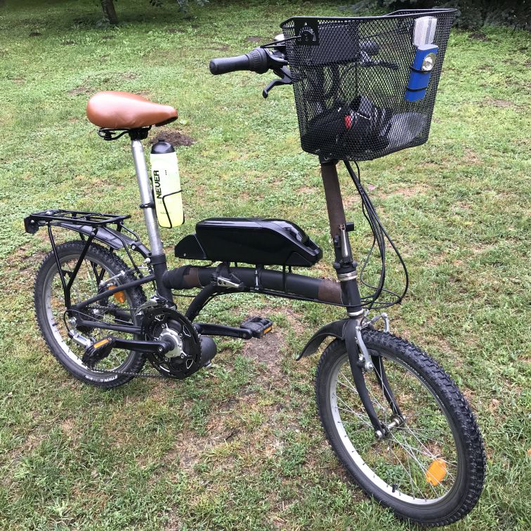

I am limiting the speed of his ebike to 35km/h.John and Cecil wrote: ↑Jul 10 2018 3:54pmI guess with an 8yr old on a lightweight bike it will probably do 25-30mph without pedaling
I wish they had these when I was a kid. I had to wait until I was 14 to get a moped, but that was back in the day before the power restrictions and my first moped was a 2hp model that was modified to cruise at 40-45 mph.

Thank you for sharing your ideas, knowledge on TSDZ2! I've been using mine for 2 months already. I've cycled with 500 Km.
It's a "no throttle XH-18" 36V350W model with 36V 14.5Ah battery. I've mounted it on a Dahon folding bike with 20" wheels.
As mechanical upgrade I've mounted a 52T front chainring next to 42T original with a front derailleur.
I'm planing to get into the electronic part as well. I've already ordered ST-Link V2 Programming Unit. I've an Arduino Uno which I'd like to use to monitor the communication.
I'll order the "Extension Cable for TSDZ2 Speed Sensor" mentioned by eyebyesickle:
https://www.eco-ebike.com/collections/t ... eed-sensor.
Which I'll cut in the middle to be good for programming the motor controller and to make an Y or other cable from it which I can use with eg. KT-LCD3.
Probably cheapest would be to have only the male/female connectors and create whatever I need. But I've seen nowhere this type of connector yet.
I've looked into the code made by casainho. As far as I see currently there are 3 more values in the communication, extending the original ones: battery_current, motor_controller_state_2, pedal_cadence.
Well, I was also thinking on if I should use the Flexible OpenSource firmware for these actually 2 more values or to use a voltmeter-amperemeter with a cadence sensor.
I came up with answer yes: as then I'd not have several gadgets on my handlebars. Also there are much more possibility in the Flexible OpenSource firmware.
