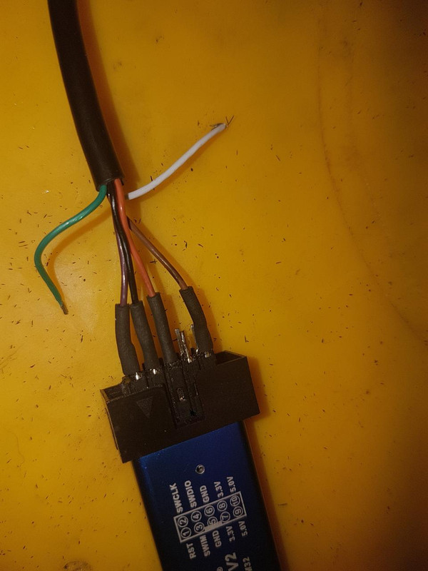

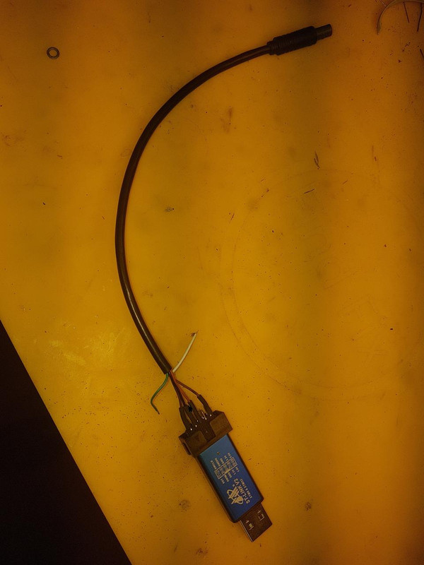

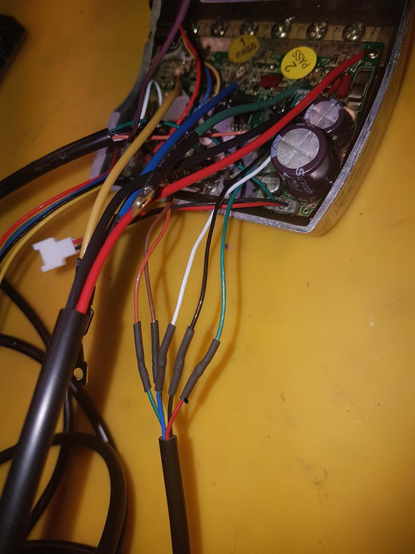

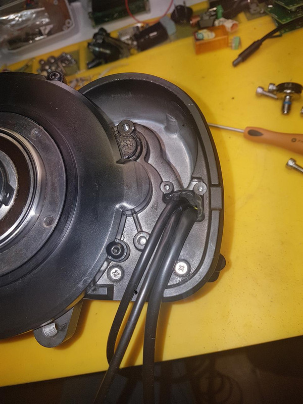

Hallo to All!!!
I'm a new user from Italy, I was convinced by Casainho's open source firmware, so I bought a complete kit.. Tongshen should sponsor the Casainho work!
This is my 2 cents:
1 - cut away the cable into the motor controller, and connect there the new cable of KT-LCD3.
2 - use the cable cutted for a perfect programming cable. I think every morning we have to flash some new firmware!
3 - put some silicon in the hole with new cable, so the controller will be again watherproof.
4 - There are 2 way for arrange cables exit from motor: use the best for your configuration.
Attached some photos, my byke is a cheap and heawy Rockrider 520S, but perfect for some weekly trip around.
Chain line also is perfect.
Walterinox   1 µW
Posts: 2
Joined: Sep 20 2018 11:30am
Post by Walterinox » Sep 21 2018 11:09am
Attention: change green wire and yellow wire in the controller junction as you see in photo, otherwise you have to change into LCD3, as I had to do....
This is the correct junction: yellow -> orange green -> brown
(Sorry for my English....)

Walterinox wrote:
Sep 21 2018 11:04am
Hallo to All!!!
Thanks for sharing!! I really liked the details on how to fix the motor on that dual suspension bicycle -- seems a good solution to me.

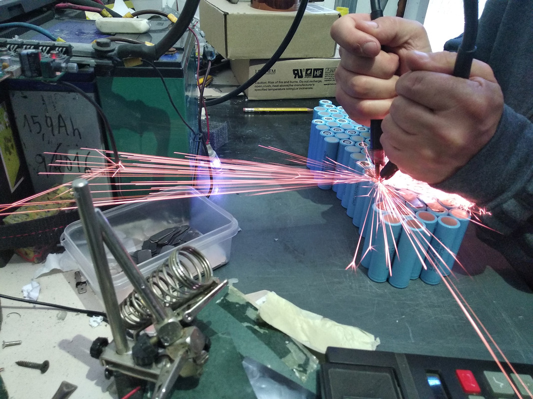

Testing the TSDZ2 flexible OpenSource firmware and the motor temperature sensor
On last weekend, I participated on the most harsh travel I ever did and I could do it only thanks to TSDZ2 and our flexible OpenSource firmware -- I am really happy for all the investment I did up to now!!
The Castle Quest, to conquer 8 castles on the historic villages in Portugal, 325kms in 2 days on the mountains. It was very hard to me, once I was near to drink water from a puddle in the ground because it was very hot on the top of mountains and I was alone without water...
So, there was long and very steep slopes and because my chain ring has a big number of teeth, I could not pedal at less than 10km/h and so I had to use the motor max possible power. Also on the last day I had to tow a college on the slopes, using an elastic cable and again, TSDZ2 at max possible power. TSDZ2 never failed to me, it always worked perfectly!!
I did an upgrade to my battery to be 52V (14S) and used cells of 3600mAh each and I even took another extra battery with the same cells and voltage. The 52V 14S cells work very well!!
And I have luck to have a friend that build custom packs from scooters and ebikes. Also important that our firmware is very efficient other way I would probably need to carry another extra battery pack :-(
Another very important piece of technology was the motor temperature sensor!! I pushed the motor to the max current of 18 amps (almost 1000W) at the very steep slopes and when towing my partner, the motor get's hot quick but the temperature sensor did protect the motor!!
A feature that is currently missing and made my experience hard, is the walk assist mode because I had to push by hand my heavy ebike on some places :-)
