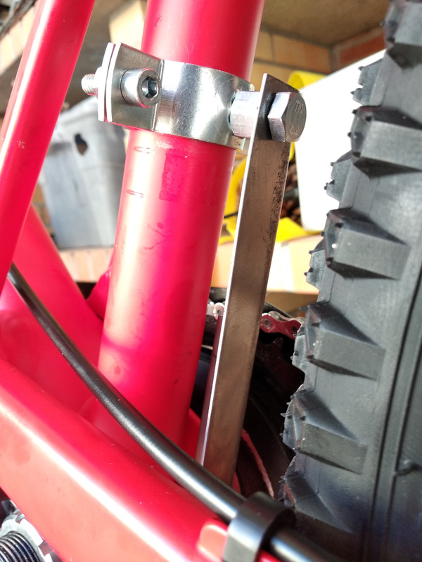

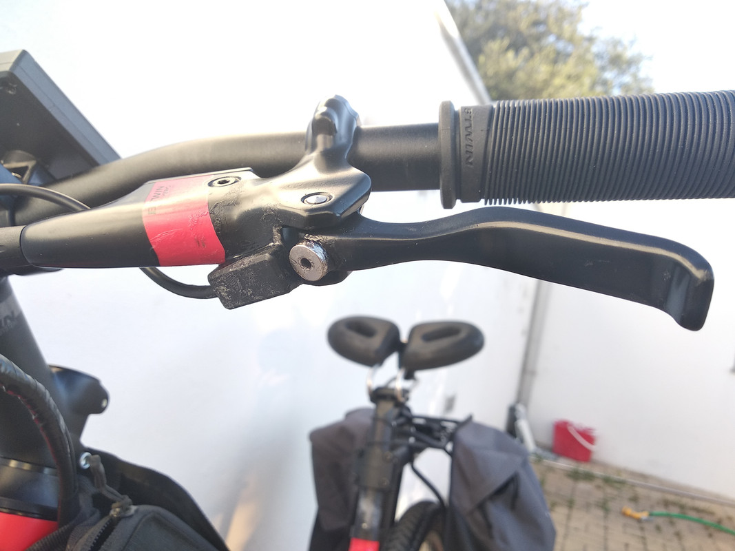

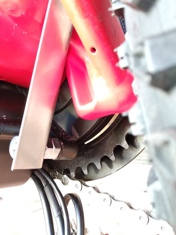

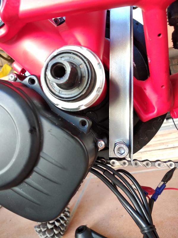

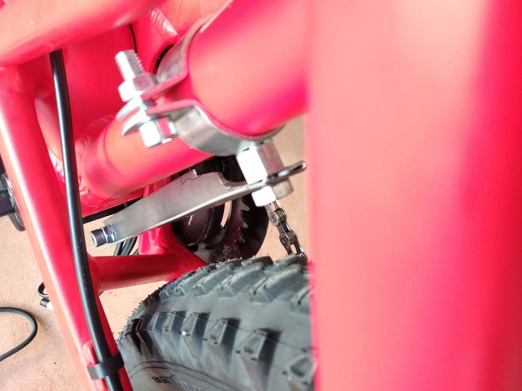

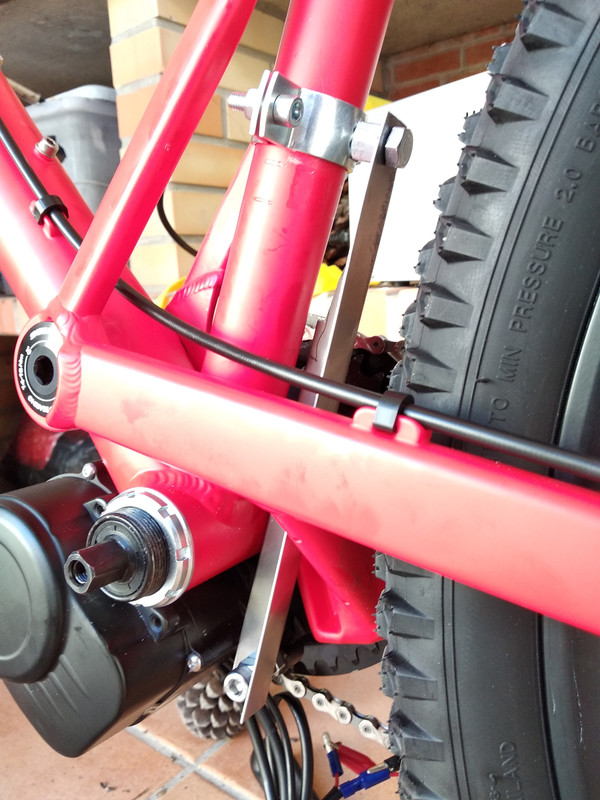

How to install TSDZ2 on Decatlhon RockRider 540 S full suspension bicycle
I bought new bicycle, this time a full suspension and it was cheap on Decatlhon for 500 euros. Thanks to the pictures/ideas shared by an user on how to fix TSDZ2 to the frame, I took the risk to buy this bicycle RockRider 540 S to install TSDZ2.
I bought on a local shop a pipe clamp and a metal bar and at home I had to drill the metal bar and use file, etc.
The metal bar I did to fix TSDZ2 seems to be longer than needed, but it is to accommodate the front derailleur not seems on the images.
I also had to file TSDZ2 housing in some parts to not touch the rear suspension triangle of the frame.
Also since the bicycle has hydraulic brakes, I had to use the type of sensor brakes as seem on the pictures.
I installed the motor temperature sensor and our flexible OpenSource firmware, using the wiki instructions -- it worked everything the first time :-)
I am sharing this images in the hope it can help others that want to install TSDZ2 on a bicycle with a similar frame.

Casainho, i saw in the last picture above you installed a brake sensor on hydraulic brakes and LCD3, could you please explain which cut off you used, and how you wired it into the display? Or just redirect me to a site with the instruction, then i can work it out myself.
