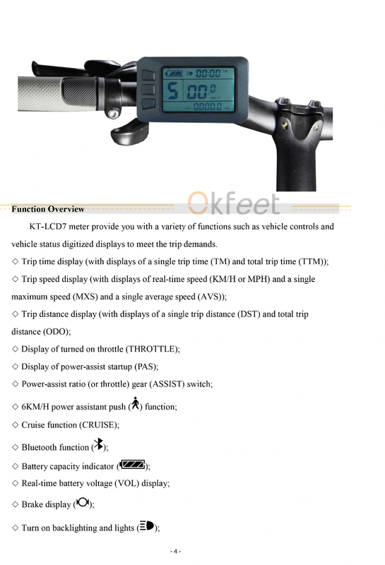

Case 1: I also have family and I pay their ebikes and they also do not value a big color LCD, so, I would prefer a cheap and simple solution for them.
Case 2: I am start to think that I would prefer to have an high tech display on my ebike only and with advanced capabilities like navigation and connection to my phone to show me alerts of phone calls and new messages/notifications. I know that some expensive electric motorcycles/scooters are coming to market with this functionality, where your phone is connected by Bluetooth and then you can see phone notifications and do google maps navigation on the scooter display. I think this is Android Auto!!
For Case 1, we should go with KT-LCD7. This one is cheap (26 euros), has Bluetooth, similar size to KT-LCD5 and has USB charger. Buy here.
Should be relatively fast to migrate to KT-LCD7 as it should use the same internal hardware as LCD3, it is just a smaller LCD that shows less information and with added UART Bluetooth module.
While we do not have Case 2 working, Case 1 should work well also for the ones that want to use Android Auto on phone or plain Android. They can connect the phone the the LCD charger and place the phone in the center of the bicycle handlebar. I see myself doing this when I need navigation (only 1 time every 2 months).
KT-LCD7:
For Case 2, I think there are few options and I am not very experienced with Android (I am an user). As reference, here is a well documented project for Android Auto to be DIY on RPI3 and put on cars: http://getcrankshaft.com
I think that making motor work with standard, unmodified XH18 should be a priority. It is easiest, as no new discoveries or expenditure is needed by the developer (you), and it allows the greatest number of people to use your firmware with no electronic hardware work. Once you have done it , then it's done - no one can ask for extra features since its impossible to extend.
KT-LCD 7 looked good, but where I saw it sold, the wording implied that the bluetooth was a separate module plugged into the usb port. Which seemed ugly.
With any luck same as LCD5. Have you seen one in the flesh?
I just ordered LCD5 a few hours ago - maybe I should ask pswp if they have lcd7 yet, it wasn't on store

Post by casainho » Oct 23 2018 5:52am
crun wrote:
Oct 23 2018 5:14am
That would bring no value to me and I do not oppose if someone do it. For my needs, I want access to the advanced features on all LCDs of my ebikes.
crun wrote:
Oct 23 2018 5:14am
See here Kunteng product page, I really think it includes internally the Bluetooth module and I expect to be that simple and cheap ones used on Arduino world: http://www.szktdz.com/en/news_show.php?article_id=544
crun wrote:
Oct 23 2018 5:14am
I hope to get one in about 10 days.
