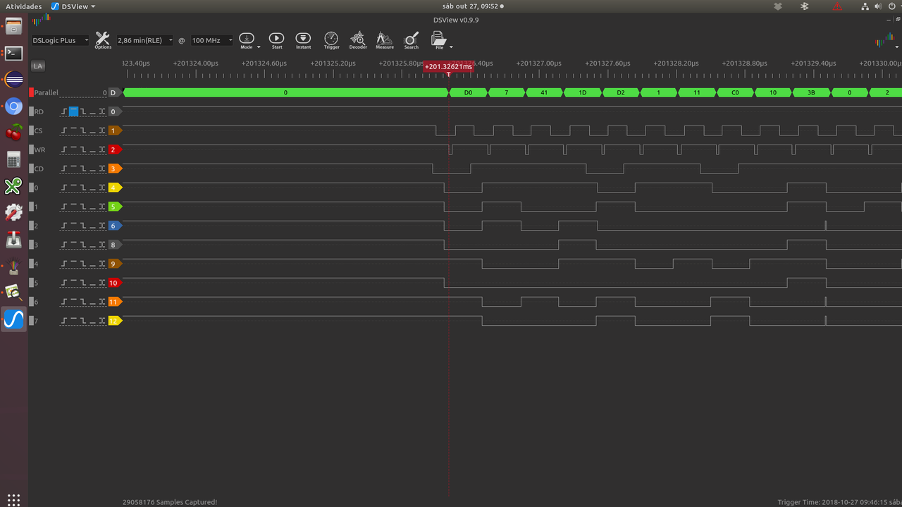

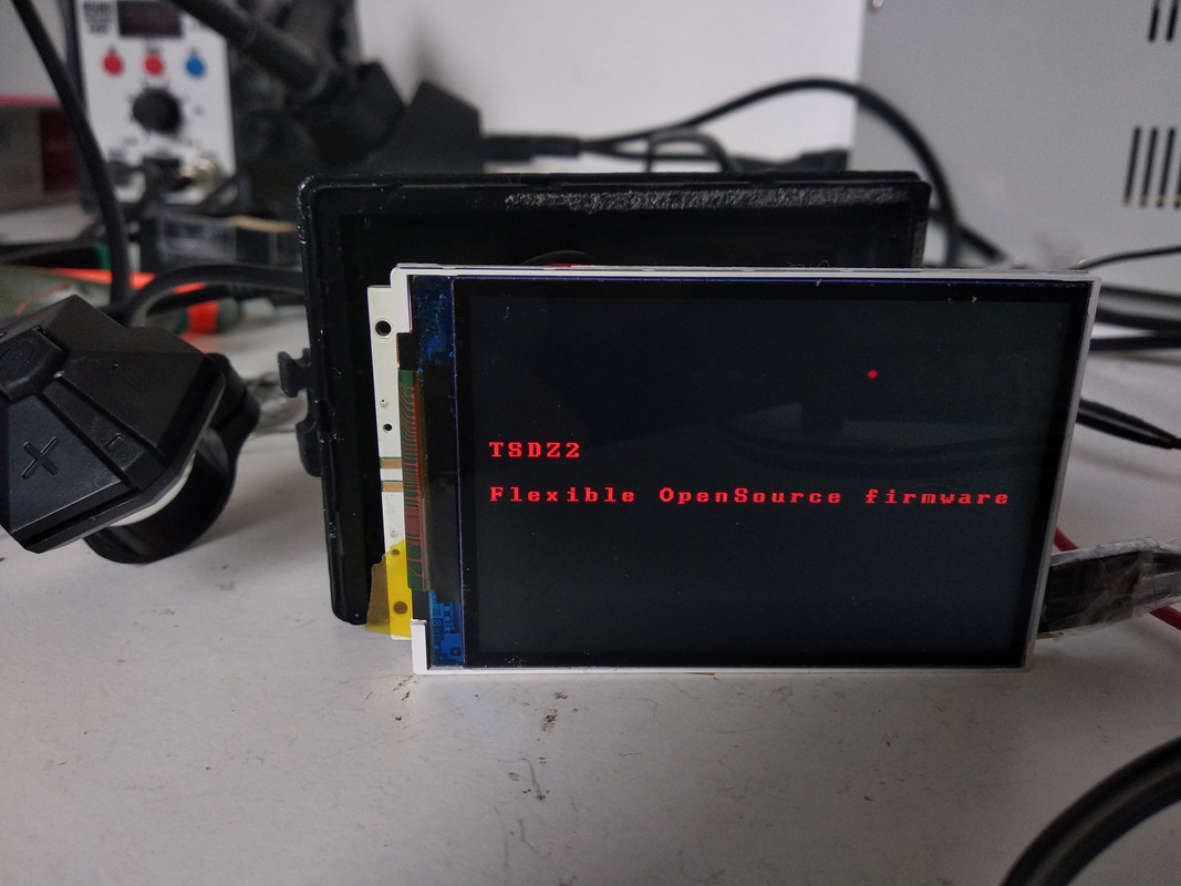

casainho   1.21 GW
1.21 GW
Posts: 3577
Joined: Feb 14 2011 2:43pm
Post by casainho » Oct 31 2018 5:13am
Finally I got Bafang 850C LCD working!!!
I had to buy a logic analyzer and was my first time using it -- always learning :-)
The firmware is here: https://github.com/OpenSource-EBike-fir ... C_firmware

Seems that original firmware includes a bootloader, because there is a Windows software provided by the manufacture that flash new firmware by the UART pins/wires that goes to the motor controller. The firmware file that is used to flash seems to be encrypted. I think there is no way to use the original bootloader, the system was designed to be like that, to be locked.
The only way is to do as we do with KT-LCD3, open the LCD, solder flash/debug pins and program/debug using STLinkV2.
I am now in the process to think and define how things/different screens will go to work. Like KT-LCD3, having a main screen and configuration screen. I found and tested some OpenSource libraries for GUIs and I choose the most advanced that I could put to working: https://embeddedlightning.com/ugui/ -- I think original firmware uses a more advanced GUI library, but may be some commercial one.
Now the challenge is to think how the menus can work/should be implemented using the GUI library objects that are kind of simple. I already know that an analog speed meter can be implemented with DrawARC and DrawLine objects...
